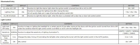

I would like the headlights programmed to automatically turn off when the ignition is turned off. Right now, they turn off about 30 seconds after the last door closes... very annoying when you leave the door open a while and then the battery dies (yes it's new).

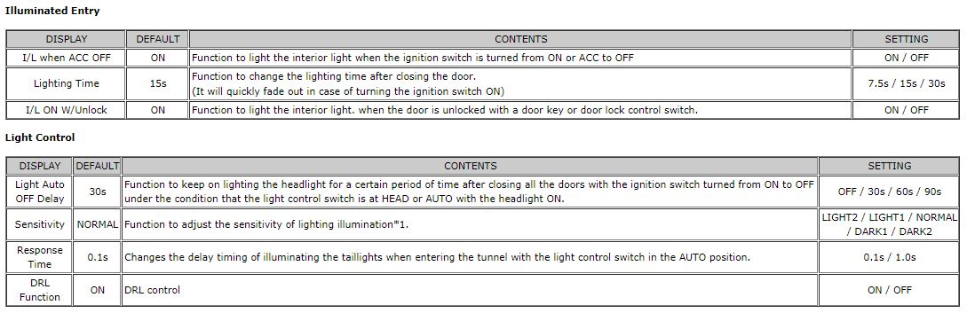

The only way to achieve that is by hooking up a Techstream to the vehicle then your able to make the changes you like and even do more. I changed settings on my GS300 here at work using the Techstream.
You need to have a buddy that is a tech and have him to these changes for you.
This is the information looking on TIS (I Work For Toyota) look at the attachment.
CUSTOMIZE PARAMETERS
1. CUSTOMIZING FUNCTION WITH TECHSTREAM (REFERENCE)
NOTICE:
- When the customer requests a change in a function, first make sure that the function can be customized.
- Be sure to make a note of the current settings before customizing.
- When troubleshooting a function, first male sure that the function is set to the default setting.
(a) Turn the ignition switch LOCK.
(b) Connect the Techstream to the DLC3.
(c) Turn the ignition switch ON.
(d) Turn the tester on.
(e) Enter the following menus:
(1) Select: Customize Setting.
(f) Select the setting by referring to the table below.
