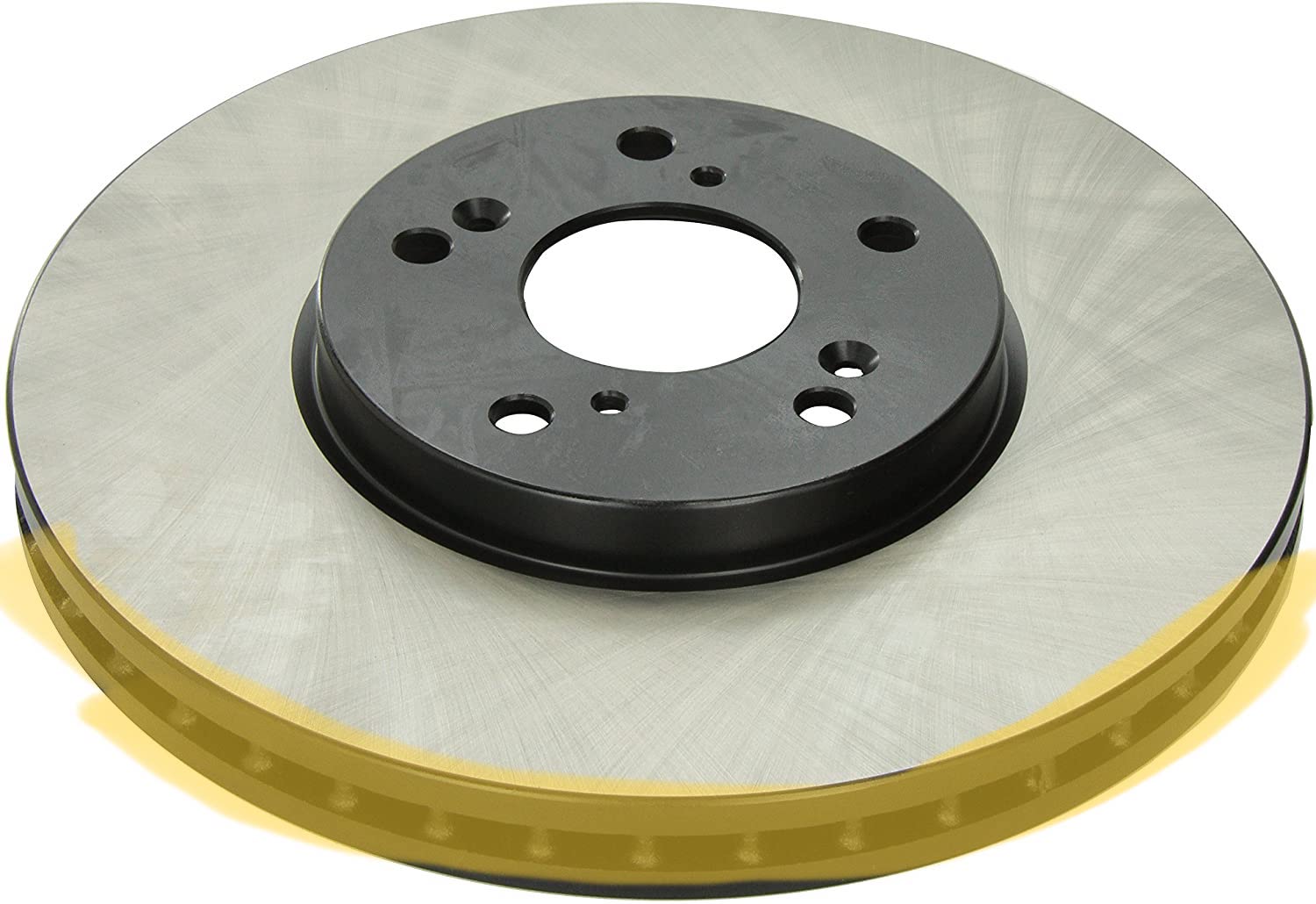

Do you guys spray brake cleaner on the inside of new rotors or just the pad surfaces front and back? That’s the only part that looks oily. I attached a picture and highlighted the area in yellow.

I don't usually clean the oil off new rotors at all. I let it wear or evaporate off. It seems unlikely you'd have a brake fluid leak at all four wheels, so if you're seeing the staining on all of them, I still think it's probably shedding/wear-in. To be clear, I'm talking about both the pads and rotors shedding, which is usually a mix of oil, metal, and pad material that sticks to the wheel. I clean it off with water and dish soap, then wax the wheel. The task pairs nicely with tire rotations and beer.
Rotors are cast steel and are dipped in an anti-rust coating (thick oil/grease) to prevent rust while in transit and storage. The area that you highlighted tends to hold a lot of that coating. When the rotors get warm it melts and gets flung outward into the wheel hub. That probably what you're seeing...
