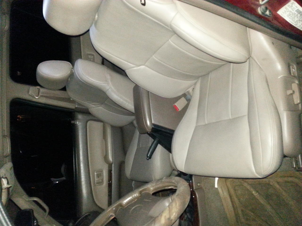

I just took my 01 to an upholstery shop where they recovered both front seats with new foam, best upgrade ever, feels like a new smoother suspension went in, multiple stages of foam compression from baby soft to pretty firm, no bottoming out anymore. Luck. :cowboy:
I think I will try an upholstery shop if I can't get the parts I ordered. The fabric is in great shape but the foam is def worn out and uncomfortable. Your seats look amazing!!!
