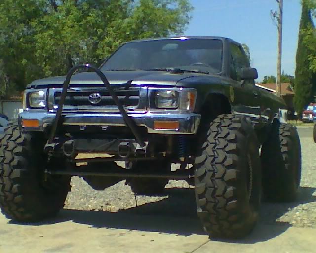

I guess if I keep the SAS plan, I want it to look like this:
you don't have to go tall with a sas
at worst, you have to go ONE inch higher than a factory straight axle, by using stock springs, which is pretty damn low.
but, what would be better is some frenched in shackle mounts, and some raised spring hangers, so you could use an arched springs, and actually get some flex out of it.

Frenched means to cut into the frame and mount the springs inside of the frame. Then you would reinforce the frame around the mounts so the frame isn't weak in that area. For a front spring setup that is not necessary because the front hangar can be mounted an inch or two in front of the frame. The rear shackle is already drilled into the frame so there really isn't anything to "french" into the frame for the front.
The rear can be frenched in on the frame though. Did you think that my 87 was high? I think that your 4runner is no lower than my 87. So if you're comfortable with that height then there is no reason to start cutting into your frame.
