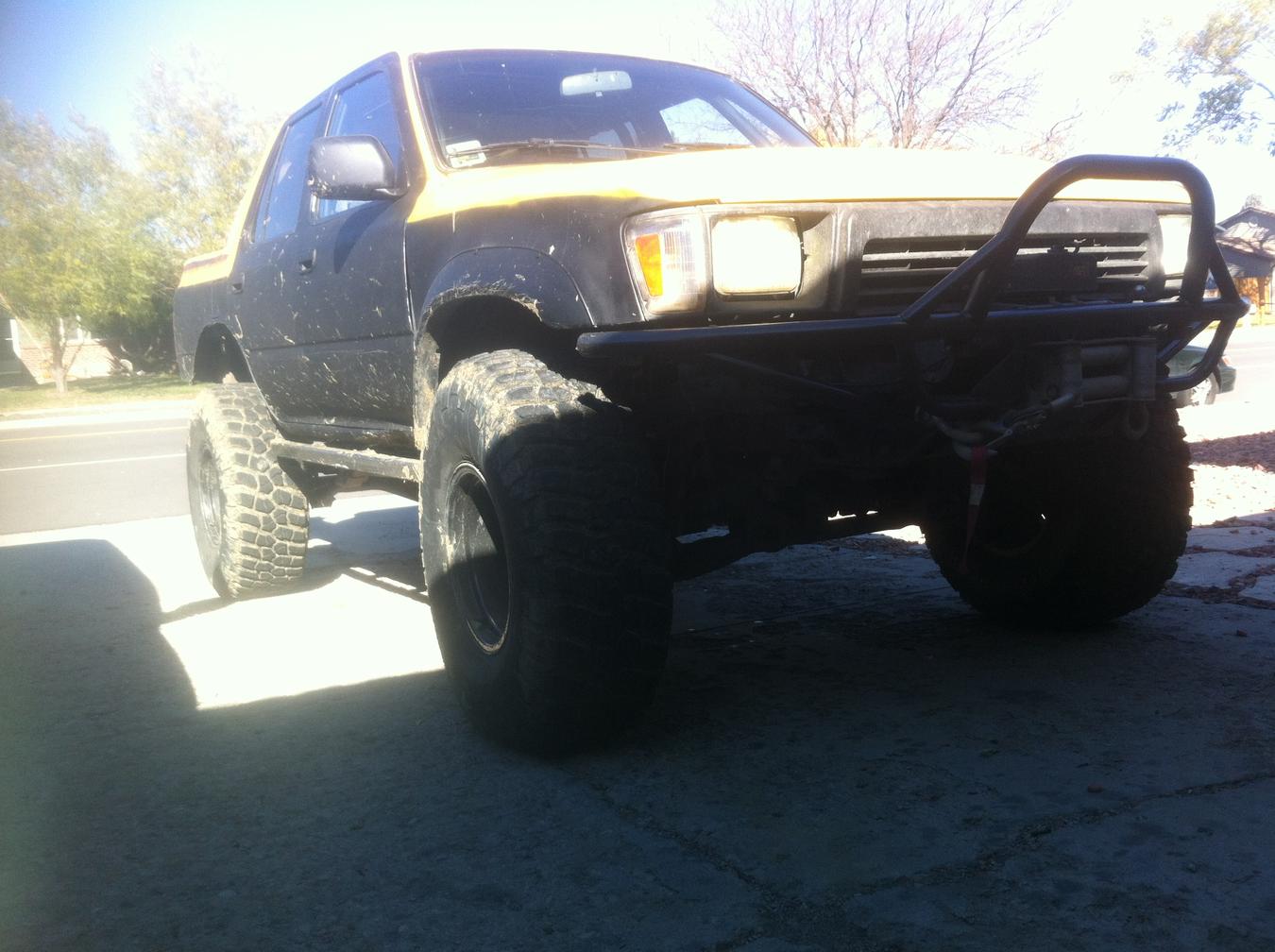

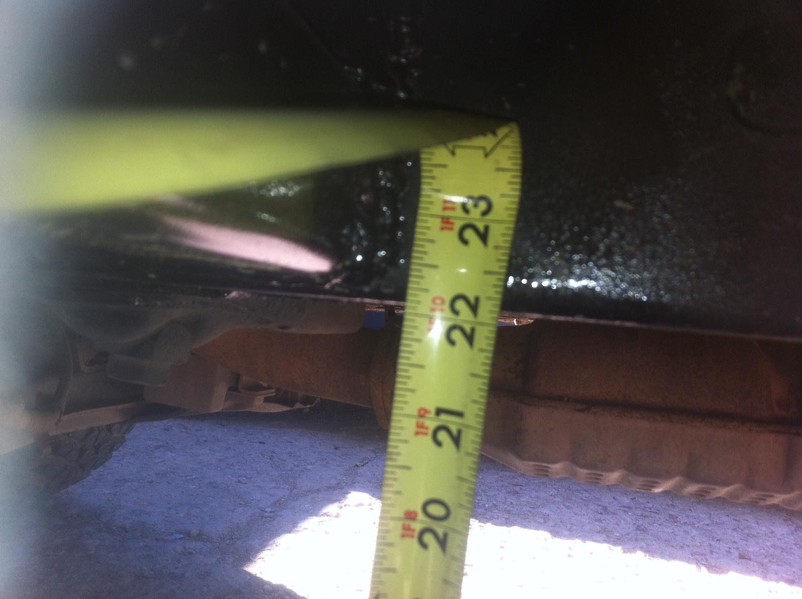

I am 22" now. Here are the last two pics of the Minnow as an IFS and rear coil sprung runner. I'm hoping for no more than 22" after it gets built.
No offense, you two have sweet rigs but two of the most capable rigs (dune bashing and going fast on dirt roads aside) got rid of their ifs. Not to say that ifs isn't capable either because we have all seen what ifs can do. But you cannot deny the added strength and articulation of a solid axle.
I would say it just depends on what you are doing with it. :)
