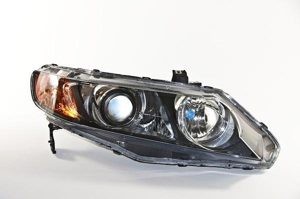

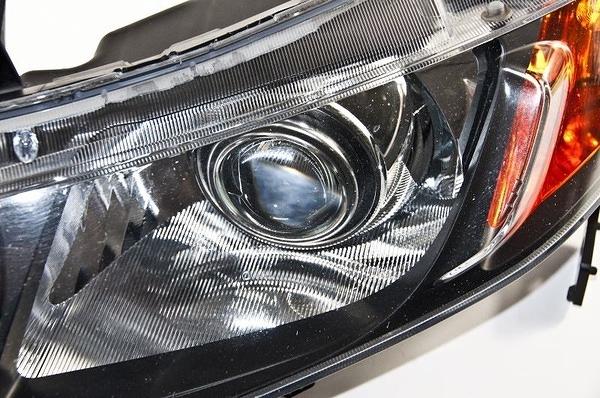

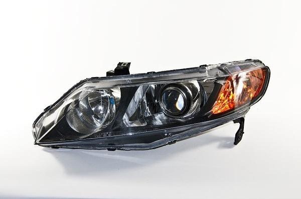

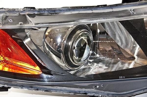

Projector: RX330
Lens: TSX clear
Shrouds: "not named yet, brand new shrouds"
HID: 4300K, low beam
Ballast: Lightwertz digital Ballast
Harness: Custom for PnP
Here are some pics I'd like to share. These were taken after completion at LIGHTWERTZ by Caesar. I'll take some pics when they are installed.
Edward’s Honda Civic – RX330 Conversion | HID Projector Headlight Retrofit for Subaru, Honda, BMW, Scion and More | LightWerkz.net
