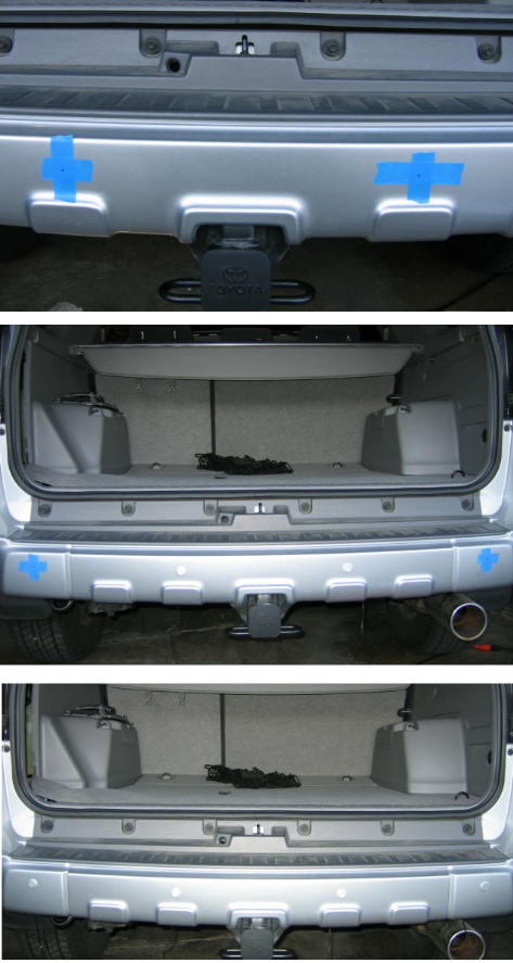

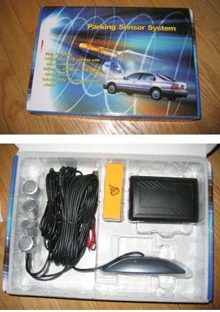

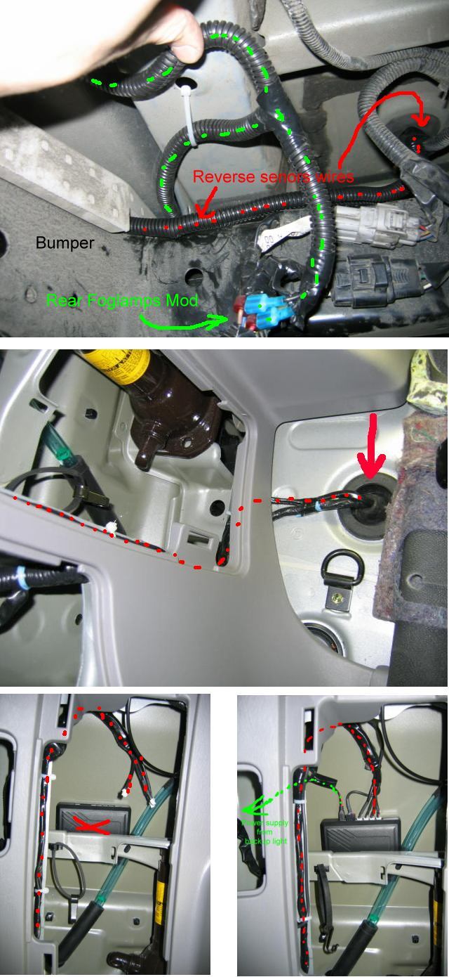

I know there are 2 or 3 threads about this but I couldn't find any pics from installation so I took few when I was installing it in my 4R. I bought those sensors on ebay and I paid close to 50$ with shipping. You can get them cheaper but I wanted silver sensors and there weren't many to choose from. Installation was very easy. The hardest part is to get those wires inside .On pic #2 You can see where I put them inside and that took some time. Other than that...piece of cake...

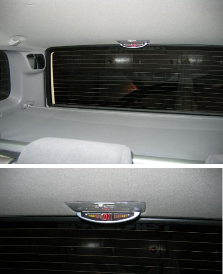

I installed display same way like wkparker did in his installation . BTW thanks for good idea!!!;):
Maybe tomorrow I will try take a pic of closest distance between bumper and object when display says 0.
1. Box
3. Wires......Red dots show where wires go....

How does the display read? i.e. are the numbers right-side-up? All the pics I've seen have shown that display on the dash. Are the numbers backwards? (so that they'll show up forwards in the rear view)
Yes..They are up side down but.... I don't mind....I wouldn't like that display in front on dash. Also with a display, You hear beeps so You know how much more space You have.. I'll take few more pics showing how display works......

I just installed a backup sensor kit, Relatively easy to install. They give you heavy duty velcro straps. I did not have to remove the bumper. There is just enough access to slide your hand up behind the bumper and over the steel guard to install the device. I removed two of the clip pins holding the bumper underneath to give me a little more room for my hands. A tip for removing these pins - put your finger on the washer piece on the outer ridge and pry the center pin up with a flat blade screwdriver. Do not try to pry up under the plastic washer as they will break. Make sure the center pin is still popped out when re-inserting. The device is about 2 inches by 4 inches. You attach the velcro to the inside back of the plastic bumper (above the steel guard) and the other piece to the device. Wiggle it into position. The wiring is simple, finding the access hole took some time -there is one on the driver side and you will need to remove the back panel (in the trunk) to get at it, but it's only held on by two screws and some plastic tags. Once the wires are through you connect to the backup light - easy too - they are up under the trunk hood - red wire positive - white wire negative. The kit includes a small indicator light which also sounds the beeper. I installed it inside one of the air slots (vent for the battery pack) and routed the wire under the rear deck panel and into the trunk. This way, I can see it in my rear view mirror. So far, so good, very sensitive to movement (i.e., a child, or something). The only drawback was the price - 300 bucks. Hopefully it was worth it, will let you know.:hatsoff:
