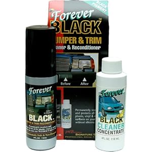

[REVIEW] Forever Black Bumper & Trim Dye
Quick review of this product:
Forever Black Bumper & Trim Dye Kit : Amazon.com : Automotive
Some of the pics didn't come out that great because of the direct sunlight, but here are the highlights:
NOTE: I used the 'index cards' method of shoving index cards between the trim and 4runner all around the fenders and under the running boards. Made super fast work of the job after that.
NOTE2: The dye comes off the paint very easily, so no worries if you spill some on it..just use a little elbow grease.
GOOD/Highlights
- 5 STARS FOR HOW IT LOOKS ON TRIM!!! 0 STARS for metal.
- All the trim (particularly the front which was almost WHITE it was so gray; didn't come out very well with my camera but trust me; the front trim was plain AWFUL. the transformation is amazing.
- Running boards, rear bumper, fender trim all came out fantastic!
- Weathertech mats would not return to their old black state no matter how much I cleaned them..they look SO GOOD dyed now.
- Also did MIDDLE of steering wheel and trim behind it..not the actual wheel as I have a leather cover, the shifter knobs (not the leather cover) and parking brake..they look fantastic..you can see where the parking brake goes into the trim how much lighter it was before.
- I put 2-3 coats on every piece of trim including the mats, the bottle was perfect size to handle all trim, mats & interior..I used every drop.
BAD/Lowlights
- Does NOT work at all on metal particularly the rear spoiler. Very spotty and streaky to the point I ended up painting the spoiler later.
- Does NOT work on the luggage rack; I put before and after pics below even though you can't tell them apart.
- Does NOT work on the front grill..made it look absolutely awful to the point I had to go and buy paint to fix it..(last pic below)
- Does NOT work on the trailer hitch.

I have used this product for years on several cars with excellent results. I agree with your findings. It works best on molded trim and leaves a lot to be desired with painted surfaces. Anyone with a faded bumper cap and/or black molded flares should give this a try. It seems to hold the color for about 6 months or so. One tip: NEVER let it dry anywhere you don't want it. It's a dye and hell to get off.
