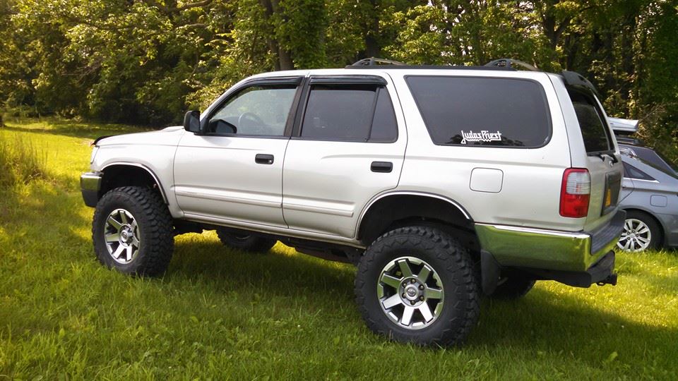

Thanks for the reassurance! Got a pic of your rig?
Sent from my SM-G935V using Tapatalk
thanks for the reassurance! Got a pic of your rig?
Sent from my sm-g935v using tapatalk

Wow your's looks like it has good height to be on the first perch! I was thinking of going 2nd perch and 906 in the rear
Approx height is 23" in front and 24.5" in rear, measuring center of hub to fender edge. About 100lbs in the cargo right now and full tank of fuel... Full load with fridge and camping gear and water (600lbs plus 2 passengers?), the rear settles about even with the front. I'm probably going to add some airbags just help dampen when going quick offroad with load.
