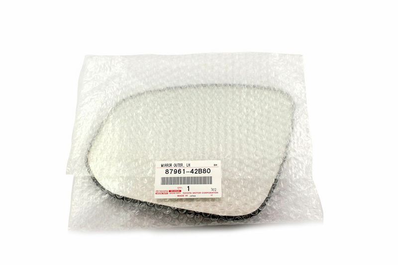

After a little digging... Here are the P/Ns for the European market RAV4 mirror:
87961-42B70
87961-42B80
87961-42B90
87961-42D90
MIRROR for Toyota RAV4 ZSA44L-ANFGPW (1510- ), Europe market, 2015/10 | ZSA44 3ZRFAE MTM JPP, Part codes: 8796142B70,8796142B90,8796142B70,8796142B80,8796142B70,8796142B90,8796142B70,8796142B80,8796142B90,8796142B70,8796142B80,8796142B90,8796142B70,8796142B80,8796142B90,8796142B80,8796142B90,8796142D90,8796142B70,8796142D90,8796142B70,8796142D90,8796142B70,8796142D90,8796142B70

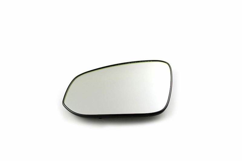

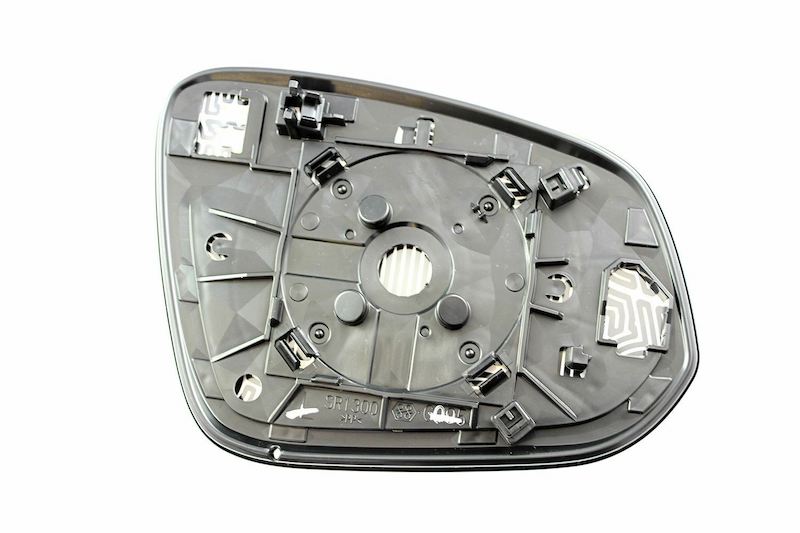

42x90 mirrors have blind spot monitor which obviously isn't needed on a 4Runner. Only difference between 42B70 and 42B80 I see listed is hydrophillic coating on 42B80. Maybe reach out to Toyota UK or Toyota Europe to clarify.
I found some pics of 42B80 on Toyota UK's ebay page here:
Genuine Toyota RAV4 N/S Wing Mirror Glass 2012- 8796142B80 | eBay
Cross referencing that P/N with generic collision parts indicates it is indeed convex and heatable.

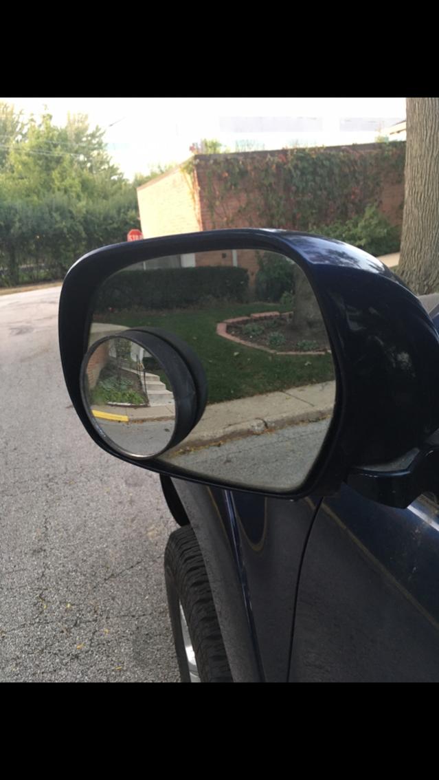

You may not want to do this, but I just bought a ~4” round convex mirror and stuck it to the left side of my mirror. No blind spot! (I have a 4th gen, no blinkers in the mirrors.) I used to tow a trailer often, and it was very useful.
