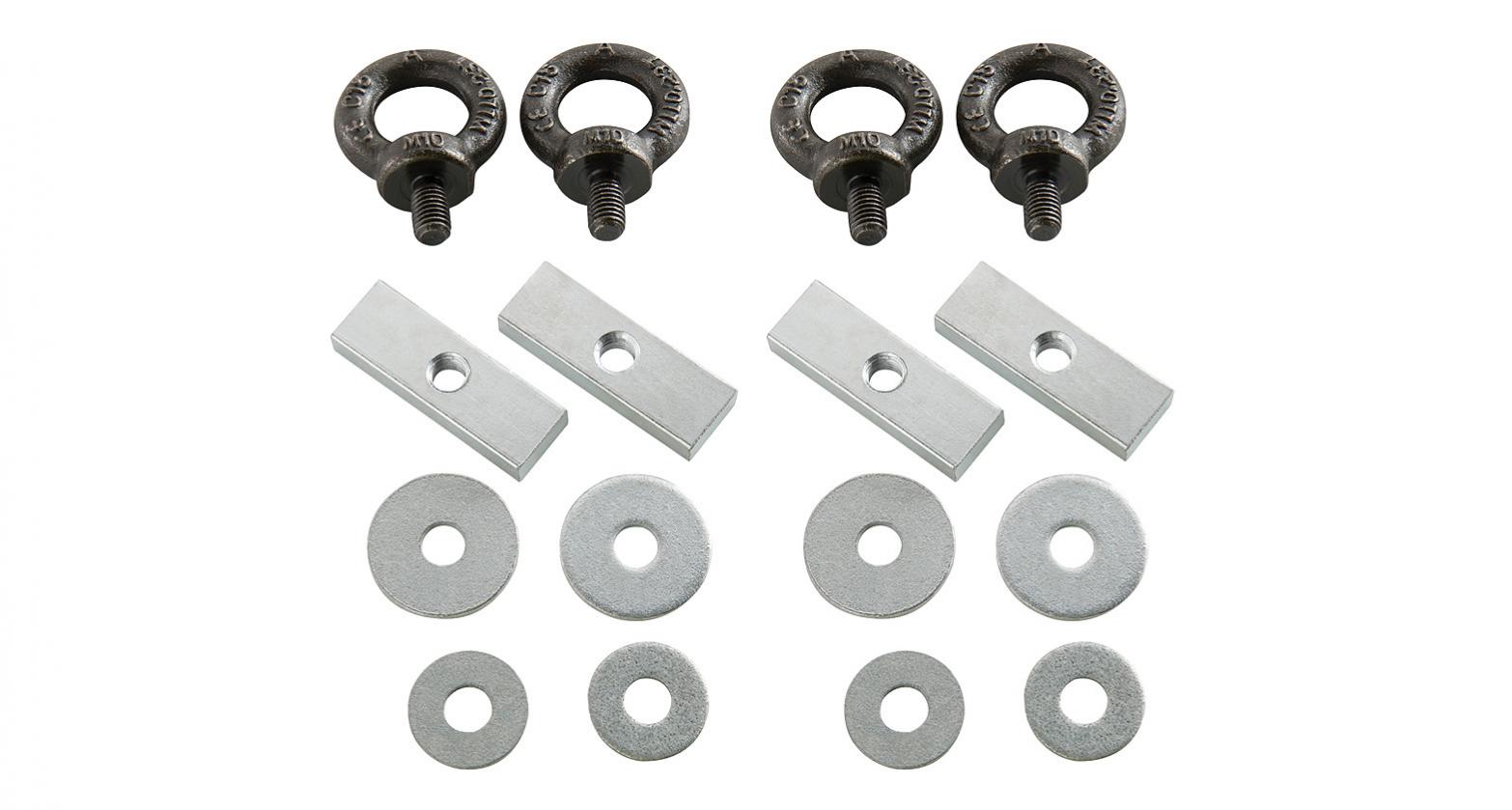

I was wondering if anybody knew what parts I could buy at Home Depot or Amazon to recreate the Rhino Rack Eye Bolts. I honestly cannot image paying the super high cost of the Rhino Rack branded Eye Bolts and want to purchase my own.
Any help would be appreciated.

I run similar similar eye bolts like those that you've posted on my Prinsu. I found them at a local hardware store and had them powder coated black. You should be fine to use those.
The picture is from Rhino Rack’s website and I am looking for the parts that I can buy online or at a hardware store so I can save some $$$.
Google machinery eye bolt and you should find what you need (fully closed loop bolts), or just go to the hardware store and buy some of the typical eye bolts. Either way its waaay cheaper than two bolts from RR for $27. These companies are nuts charging these kind of prices for accessories.

I found similar eye bolts for my prinsu on McMaster.com for much cheaper
Eyebolts are probably fairly easy to find, its the mounting blocks that will be tough. You could make your own if you have some equipment to do it or access to a machine shop. Rhino rack is proud of their accessories but they are good quality. Because of how Rhino rack mounts, vs say Front Runner who uses a bolt facing up, it makes it difficult to find stuff that will work off the shelf so to speak.
If you have any luck let us know!
I'd buy stainless. https://www.amazon.com/Saim-Stainle...ting+eye+bolt&qid=1551106809&s=gateway&sr=8-6 .
The best search term is for an "M10 lifting eye bolt" and then you'll need the t-slot hardware.
https://www.amazon.com/uxcell-Metal...0+t+slot+nut&qid=1551106998&s=gateway&sr=8-66 <-Here's some M10 Tslot nuts. You'll need some M10 washers and that should complete the kit.
I think $20 would get you a pair and $30 should get you a set of 4 in stainless. Almost all the sets come in 5. I have no idea why.
Also M10 is really oversized. I'm surprised they're using that size.

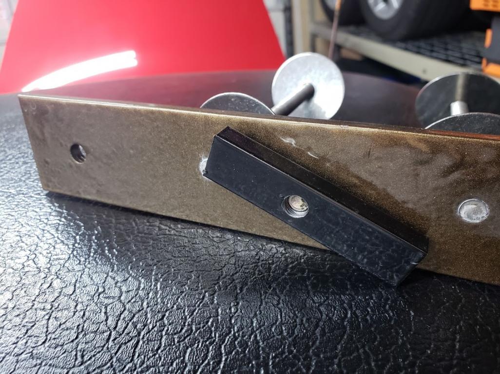

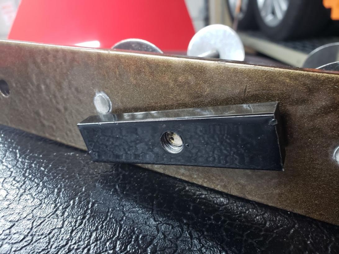

I, too, am a cheap owner of a Rhino Rack Pioneer Platform rack. I was looking for a way to mount my awning, traction boards, and cargo carrier without paying too much. Plus, I was looking for a project.
I bought 3/8" thick by 3/4" wide aluminum stock from McMaster Carr (Part # 8975K615) in 1' lengths and cut them into four 3" long pieces. I then drilled and tapped the pieces to 5/16-24 and powder-coated them black. I can slide them into the channels on the Rhino Rack and use them to secure my accessories.
McMaster Carr sells a variety of eye bolts that would work well or you can see what your friendly local Hardware Store has.
Let me know if you want a cheap idea for mounting the Rhino Rack to the top of your 4Runner. I already did that and bought the shirt.
