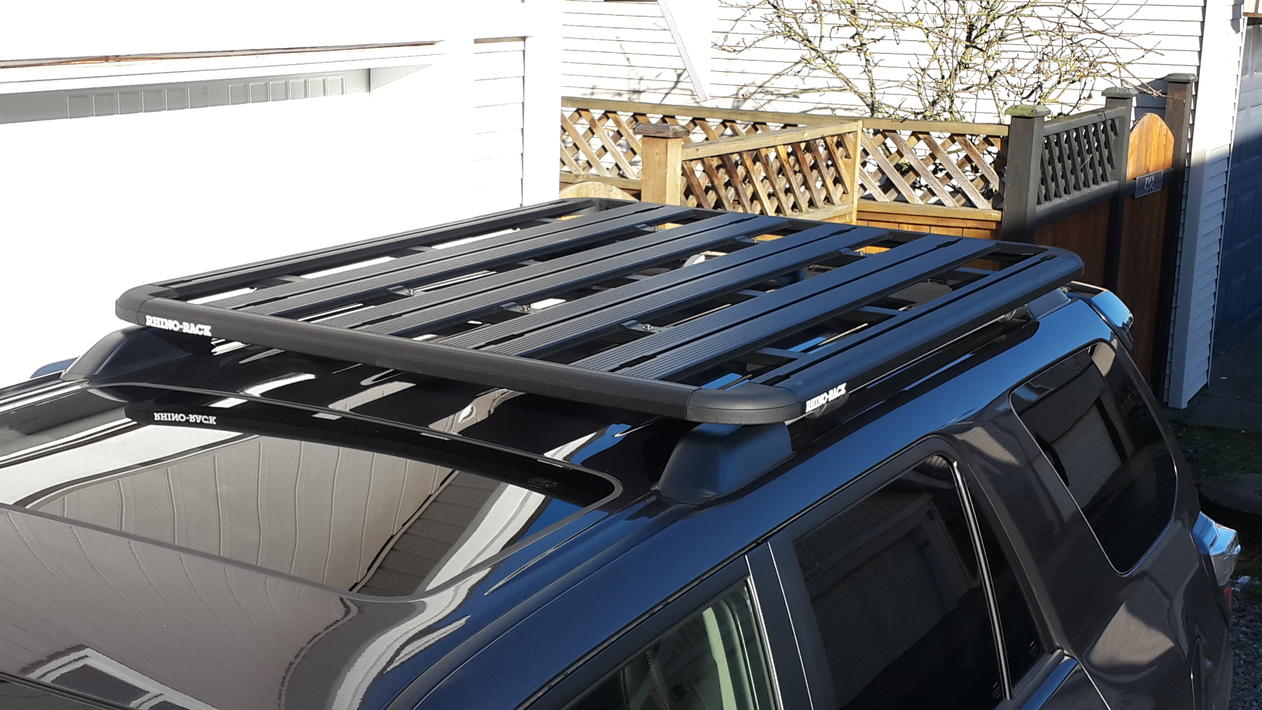

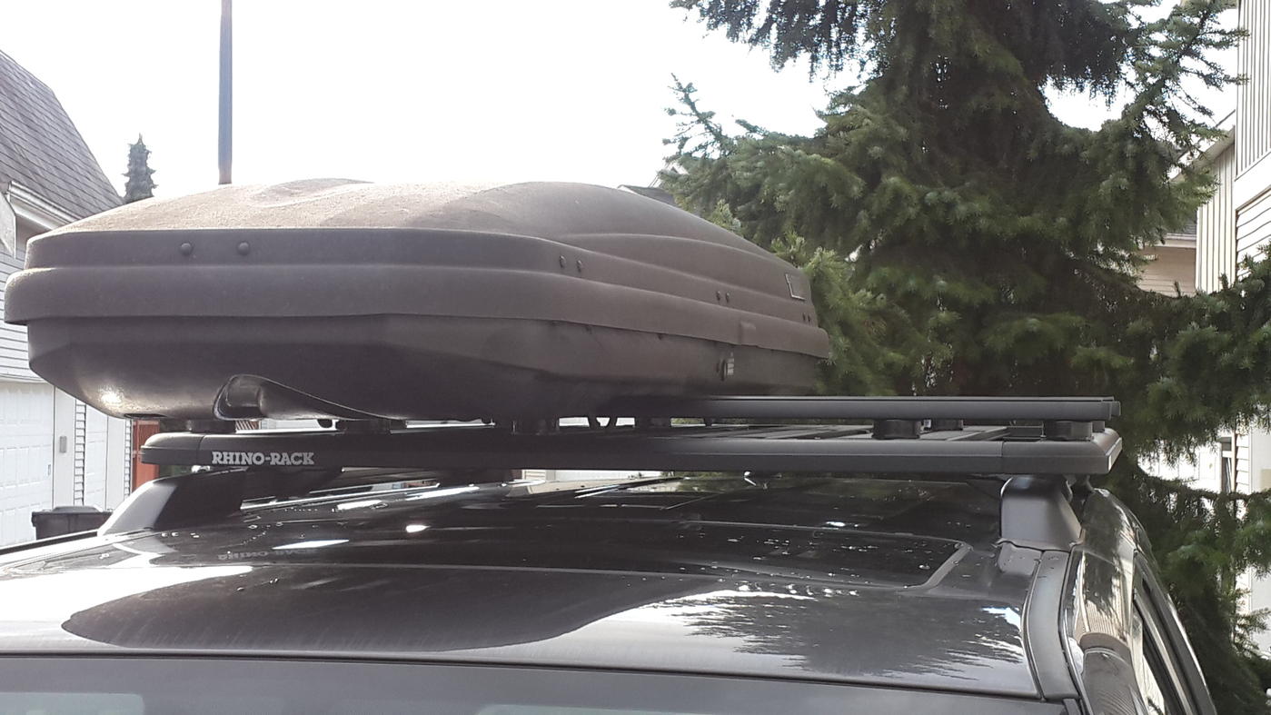

4 holes needed to be drilled, these are to prevent sliding. I kind of set up everything without the holes, then once I was satisfied with its placement, I marked and drilled. Seemed easier and better to do it that way. In the manual they ask you to drill first, but thought it would be better to place it all first exactly how I wanted it...which was better.
Rhino Pioneer Platform
I was looking into these platforms awhile ago and wondered what was involved. Thanks to your install and pics, I was able to pick up the same size platform off of Ebay (listed for a 03-09 GX470) and a CXB leg set. Aside from utility purposes of having a cargo platform, I can now use my Thule Ascent 1100 cargo box. To save on cost, the Unistrut channel nuts fit in the channels of this platform. Just get eye bolts and some large washers and you have your own eye bolt kit.

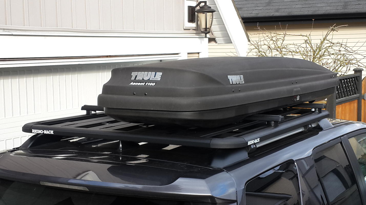

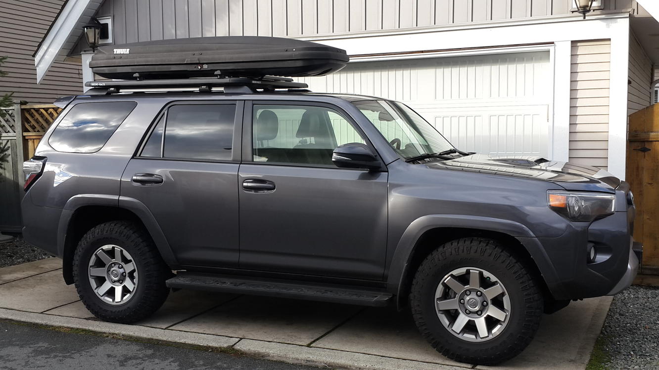

Thule on Rhino Rack
Love mine also! Picked up the Rhino Rack accessory bar and was able to put my Thule cargo box.
Not as low profile as when I had the box on the stock roof rack bars on my 2005 4runner (damn 2016 shark fin. grr), but it works!
Rear door is within an inch of the cargo box when opened.

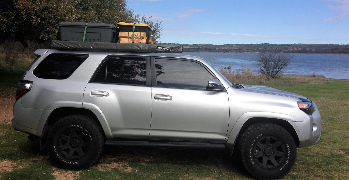

Rhino Rack- Very Happy
I had this rack installed in the fall of last year with a sunseeker awning at Rack outfitters in Austin. I like that its light weight and has endless ways to spend your $$ on accessories. Its real easy to tie stuff down and when properly done, nothing moves AT ALL.
