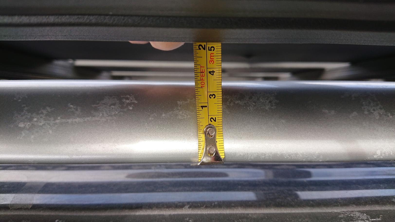

With 76" platform on top, and top of rail. It sits about 4inches above the roof.

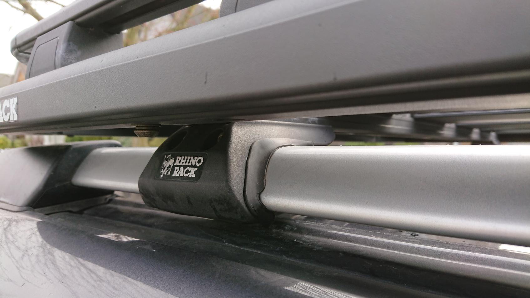

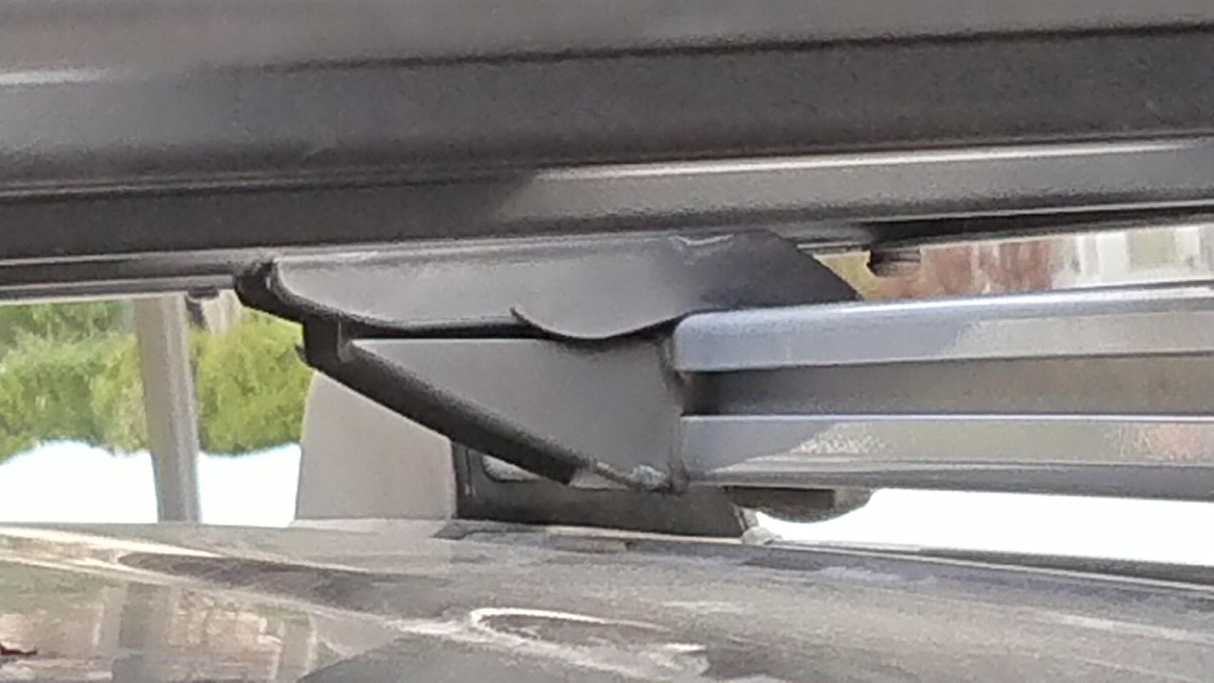

I just got the platform (42100B) with CXB legs. The CXB legs however does not completely fit (or hook under the rail). Seems that the legs were "too short" that the lower 'teeth' stop at the lower end tip of the rail, instead of being longer and completely close.
From your picture it seems like that your cxb fits perfectly. Am I missing something?
Almost there
I just kept slowly tightening the side screws on the CXB legs one side then the other, then it becomes snug to the rails. I haven't taken the pioneer rack off so I don't if something else is happening, but I haven't had any problems with it since it was installed.
I've attached some pix of the CXB legs, I had concerns of breaking the legs if I over tightened the screws, but it didn't happen as long as you tighten the legs evenly. I tried measuring the height of the rails. It should be the same as yours.
yea, mine doesn't clamp on all the way either. looks like its a bit short.
