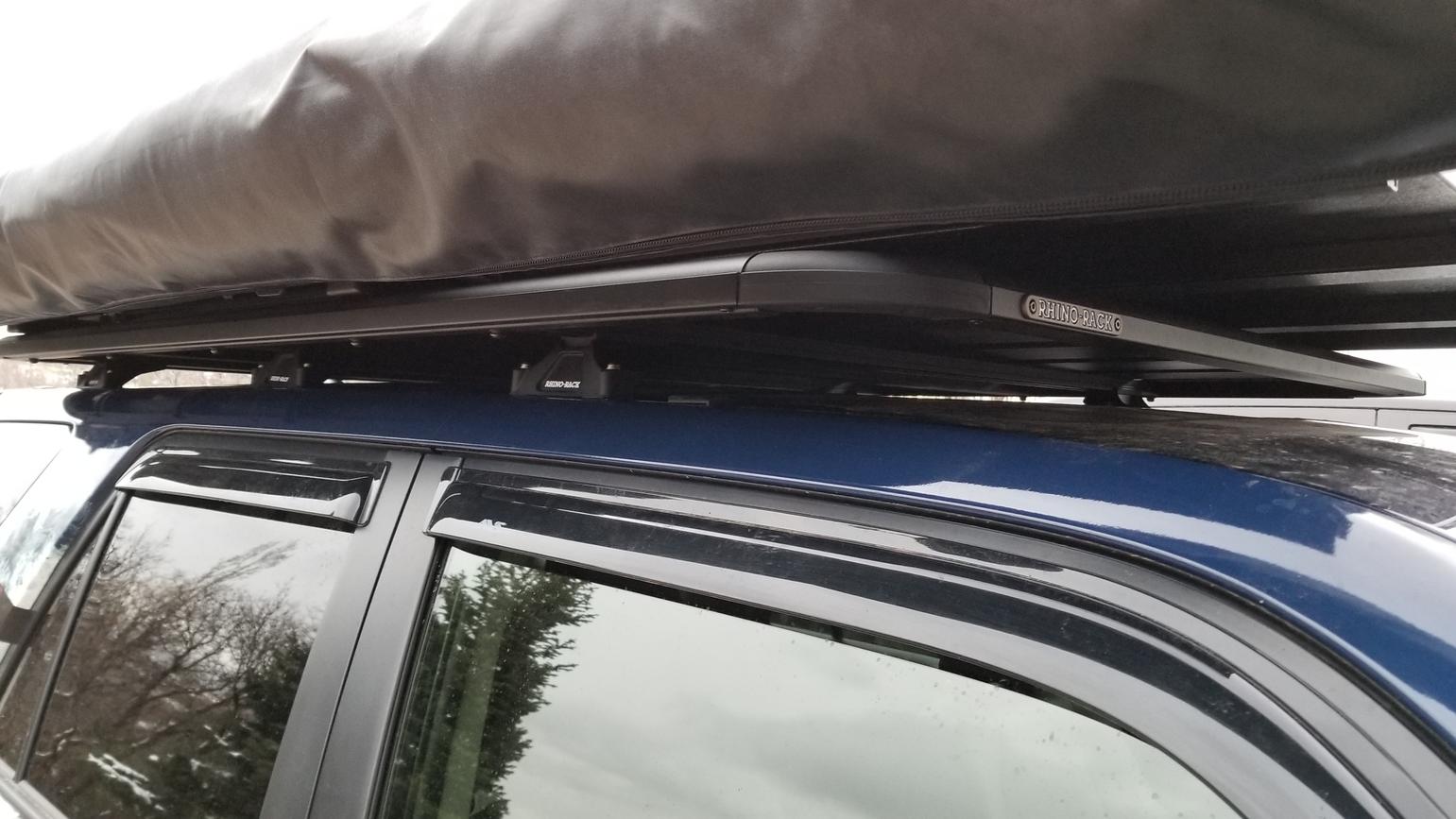

Did the track too but traded the quick release legs for the lower profile ones. I was getting some movement and noise inside with the QR style and the RTT/awning, 200#
Really like the Pioneer too, nice and versatile.

could you give a little more detail about the movement you experienced? was it during travel or while in the tent?
During normal road driving. I put some rubber strops in and while they helped the problem was completely solved with the fixed ones and also dropped things down about an inch.

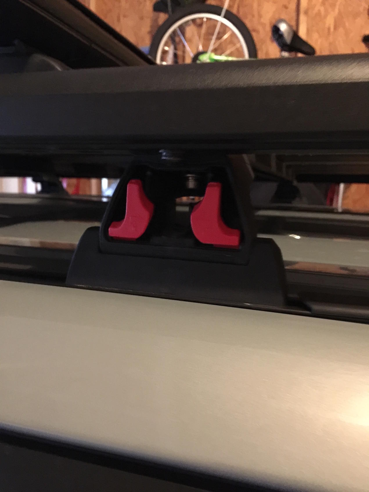

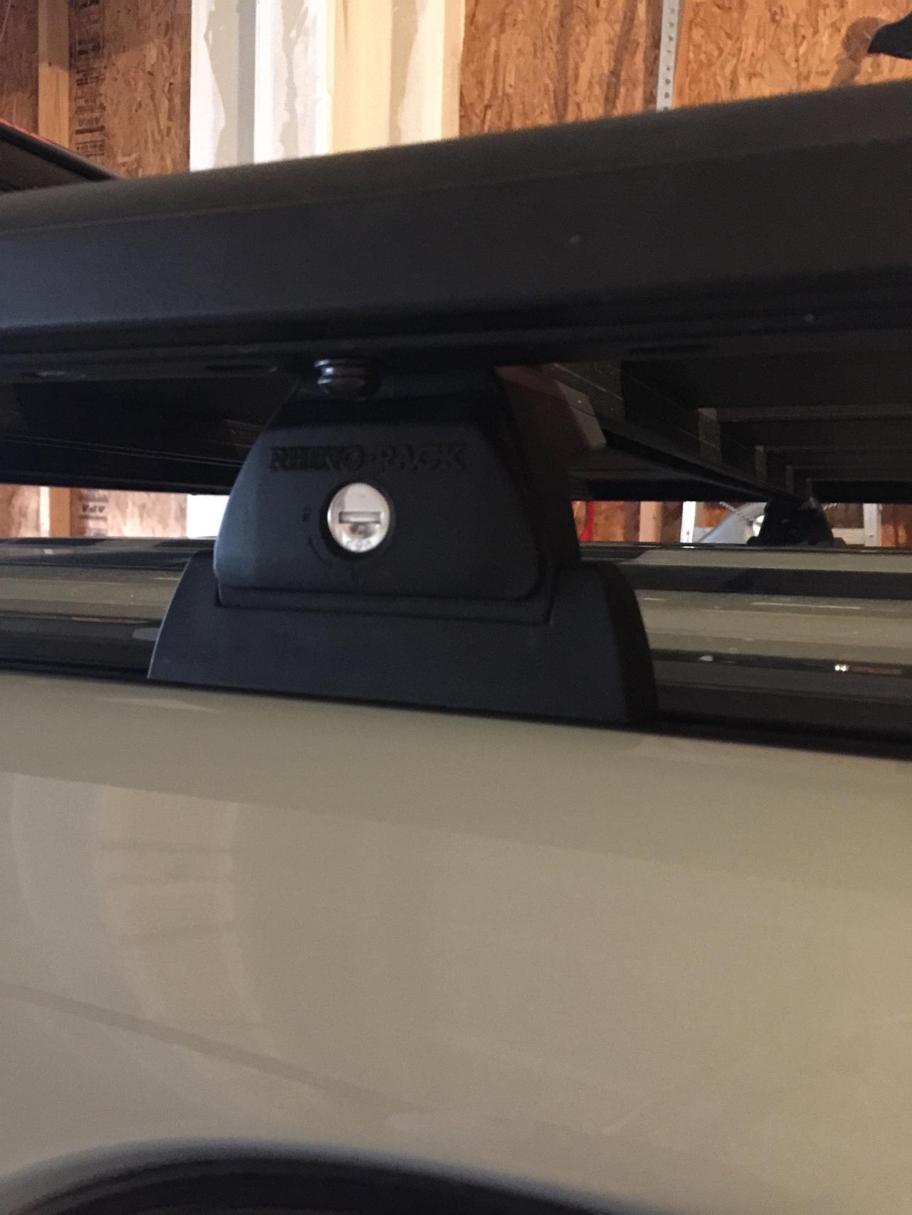

Very nice, could you share a little more about the installation process? Sounds like those legs are removable? How simple is that process?
Yes the legs are easily removable.
First you need to take the cap off.
attachment.php
Then you squeeze the red levers on all the legs. Very easy.
attachment.php

Do you happen to know what model the lower profile platform mounts are?
I really hate to pull up an old post but couldn’t find this info anywhere else.
[MENTION=129651]007nco[/MENTION], can you provide a little more info on the model RLTP legs you used and the wedge setup (between track and leg) to level out the mounting interface to the pioneer?
Hey! Curious if you figured out the spacer set up in the RLTP legs? I am trying to figure out what to order.
