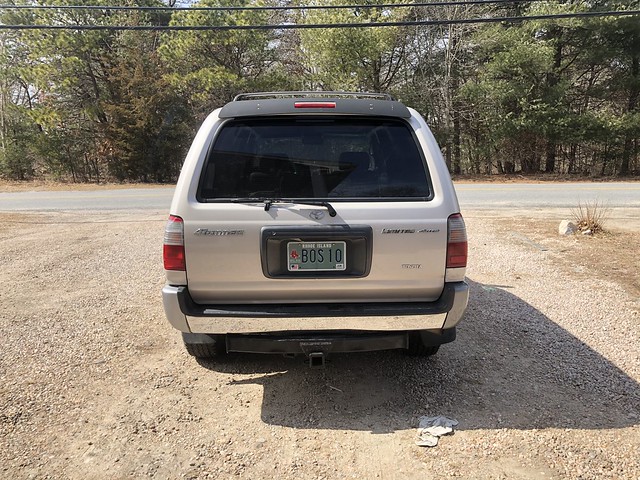

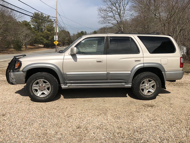

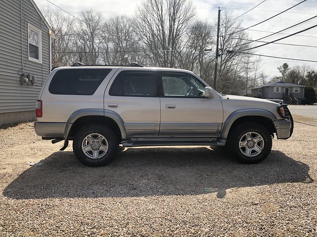

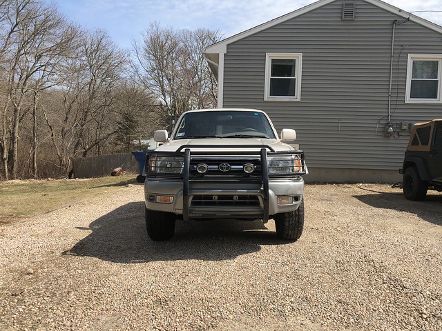

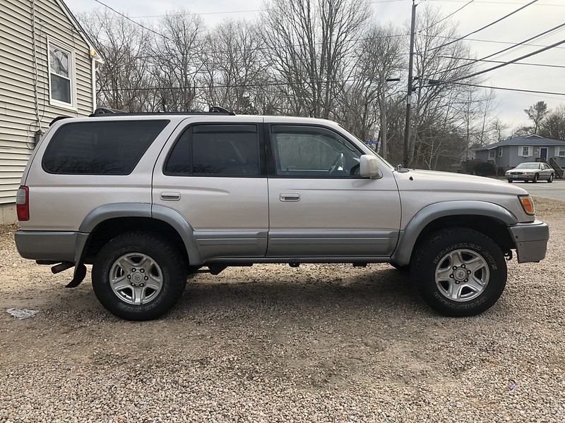

First pictures I have of it are from today - March 28th, 2018 - exactly how it was when purchased:
Head shot!
Side shots...
Rear end...

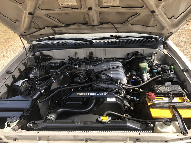

Engine bay...
Day 1!

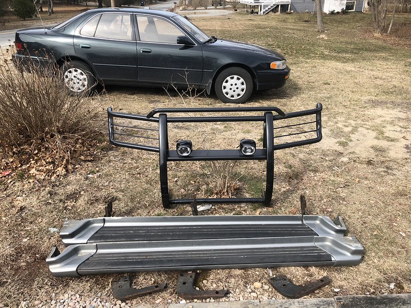

Today I got to work on a few things, nothing too exciting. I removed the brush/grill guard and the running boards.
Tools needed:
-For Brush Guard
--Socket wrench
--19mm socket
-For Running Boards
--2 Socket wrenches
--12mm, 13mm, 14mm sockets
Project Cost: $0.00
Project Time: 90 minutes

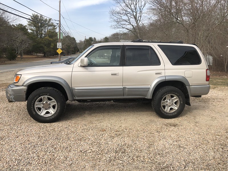

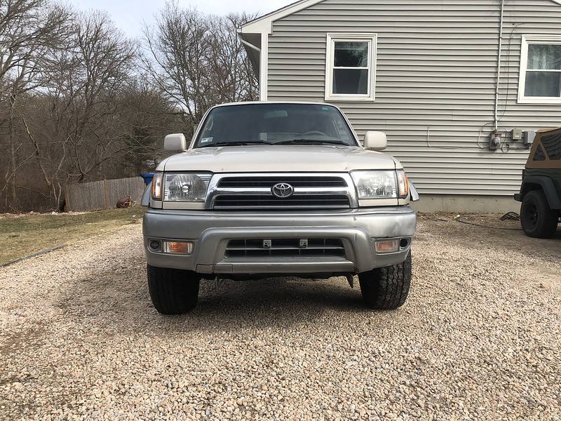

A few quick "After" shots...
The back looks the same, I promise.

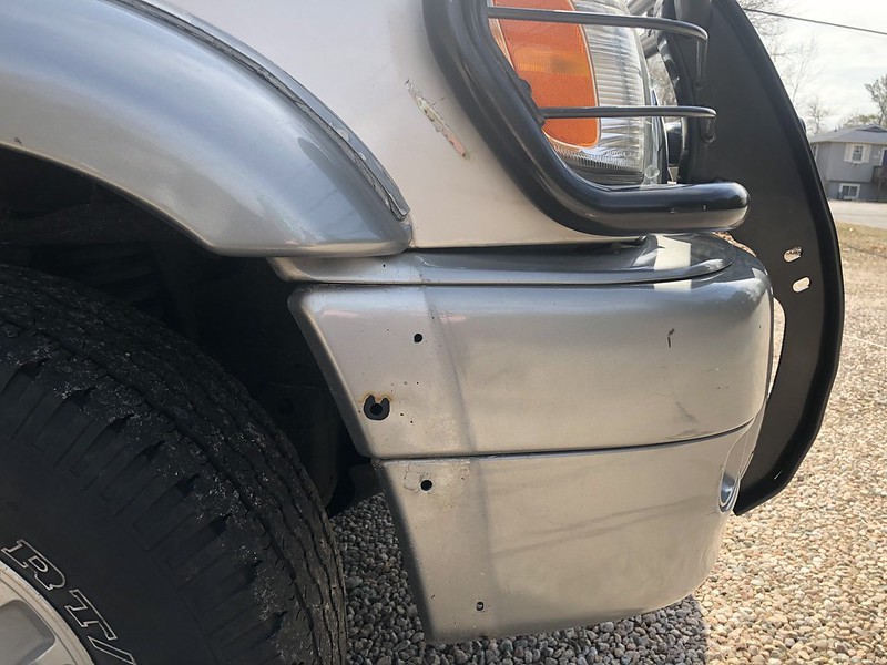

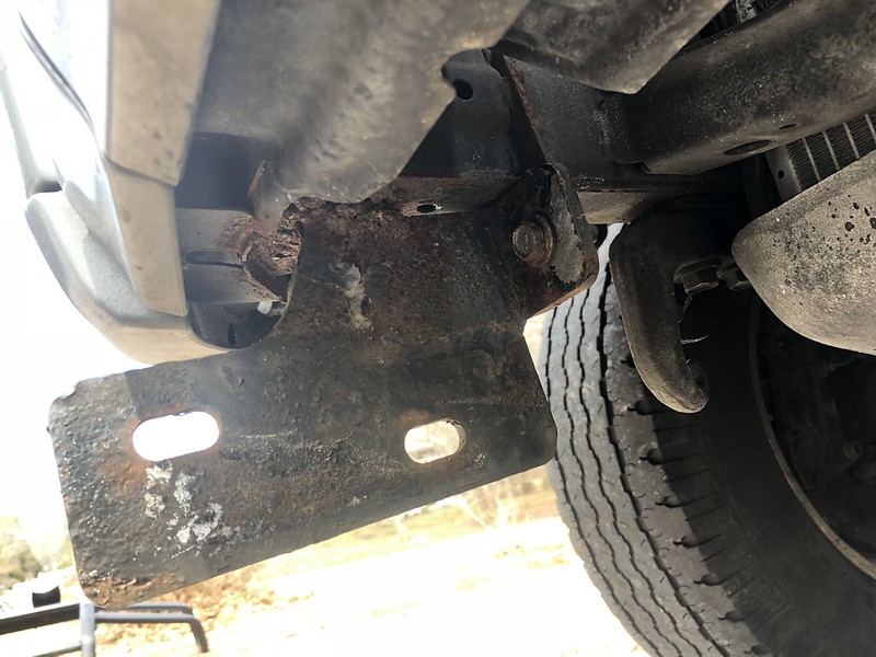

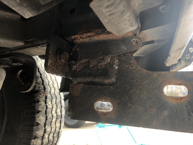

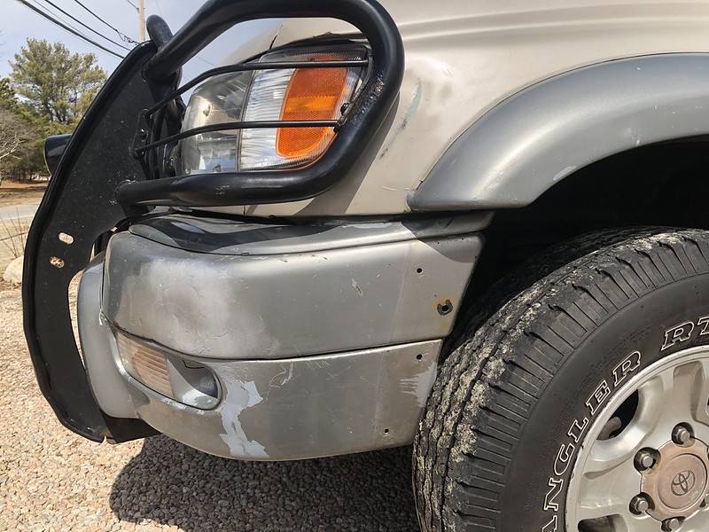

One of the main reasons I took the brush guard off, besides not really enjoying the looks of it, was the crazy rubbing it was doing on the body! It took off quite a bit of paint on the fenders...
And I am in the market for those fender flare extensions that go on the bumper. Hoping to find them cheap just to hold me over until I can afford to replace the whole bumper.

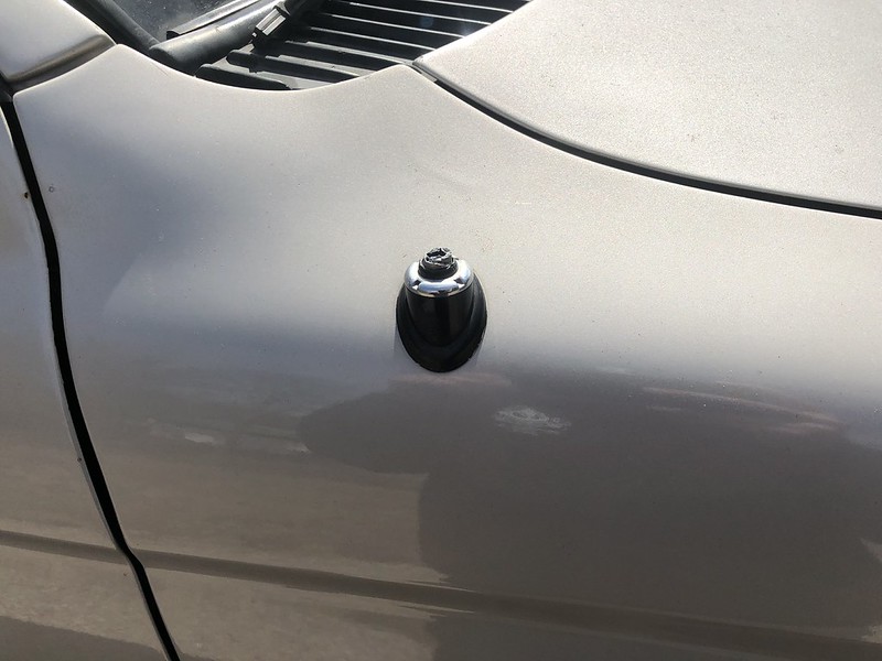

Also on the "to-do list" are the Tacoma Whip Mod since it seems my antenna broke off and took most of the thread with it, and get some sort of impact wrench to take off the last two mounting brackets for the brush guard...
Today's casualties featuring RI-Runner's older sister, the 1995 Camry...

I took the time to go ahead and remove them this afternoon! The difference is amazing, it effortlessly makes it look like there’s several extra inches of clearance. And not a long time to do it either
