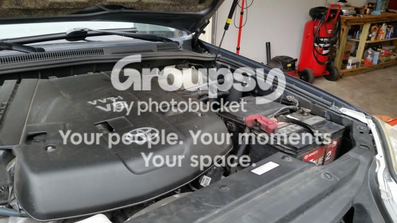

And I finally got around to doing a proper installation of my oil catch can.
20140924_122802.jpg~original

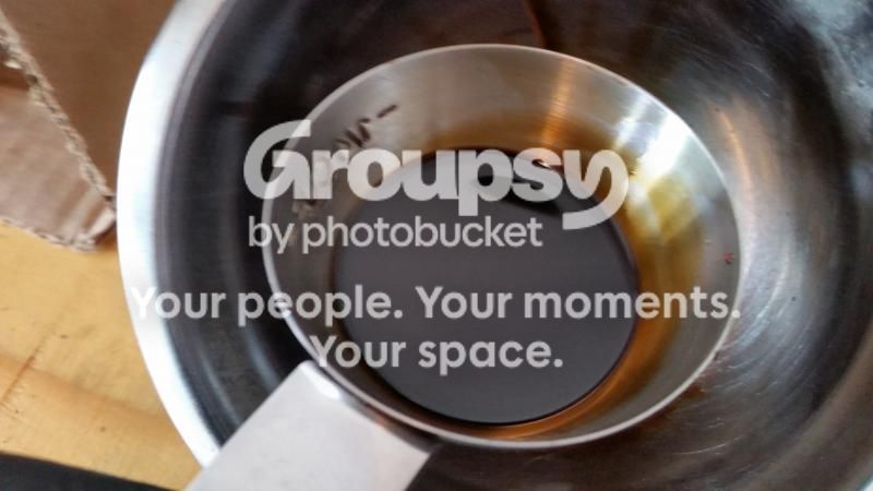

I offered these up a while back but nobody seemed interested. Some half-informed guy spouted off some irrelevant info that might have scared some people off, but I'm pretty happy with how it turned out. And, most importantly, yes it's effective. Here's the oil I drained from it today:
20140924_122735.jpg~original
If not for the catch can, that oil would have gone into the intake manifold. No, oil catch cans aren't just for forced induction engines. I have one on my T4R and I have one on my Aston Martin. They both collect oil.

I changed my oil a couple nights ago and drained my oil catch can. The contents of the can looked like... hot cocoa. I'm hoping it's just a condensation issue because of the rapid temperature changes we've been having here. Worst case it's the head gasket. I'm not worried about the HG, though, because the catch can collected similar stuff during the Spring when we were having wild temp swings as well. I've been keeping an eye on the temp gauge ever since and it hasn't budged, including on yesterday's 10-hour drive.

I embarked on a 1200-mile Thanksgiving journey so I changed my engine oil and drained my oil catch can before heading out. Gotta love a garage shot - don't mind the mess, I'm in the middle of reorganizing!
Here's what came out of the catch can:
Looked like hot cocoa when it came out, looks like normal oil now that it has settled. I had the same stuff come out in Spring. My immediate concern was coolant getting mixed in from a bad head gasket. However, I believe it's actually just condensation caused by the rapid temperature fluctuations we've been having lately. I was really hard on my engine during my road trip. It ran like a champ and the temp gauge stayed squarely in the middle. So I'm not worried about it. If it looks the same next time I drain it, I'll send a sample off to get analyzed.
