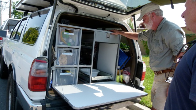

This has been a very interesting discussion. After going through it all, it seems my needs are totally different than most of you; I really don't want a lot of lift. I'm looking for something that will handle all the weight I carry. I have a '97 SR5. It has 205,000 miles on the suspension. The front end is totally stock as is the rear, e.g. no heavy bumpers, winches, etc. I have a Columbus RTT on the roof over the rear wheels, and carry close to 300 lbs of gear in the rear. I run 265/70R16 tires and don't want anything wider or taller.
So it sounds to me like the ToyTec OME complete lift kit would work pretty well for me. What do you all think?
Sounds to me like some OME 906's would accomplish what you have in mind very nicely, and for far less $$ than a full lift. Do a search, they handle extra weight very well, and provide about 1" above what '99 talls would provide in the rear, can be used with stock front, stock struts all around, stock brake hoses, etc.
Thanks very much for your advice. I will check it out. Will let you know what I come up with.
