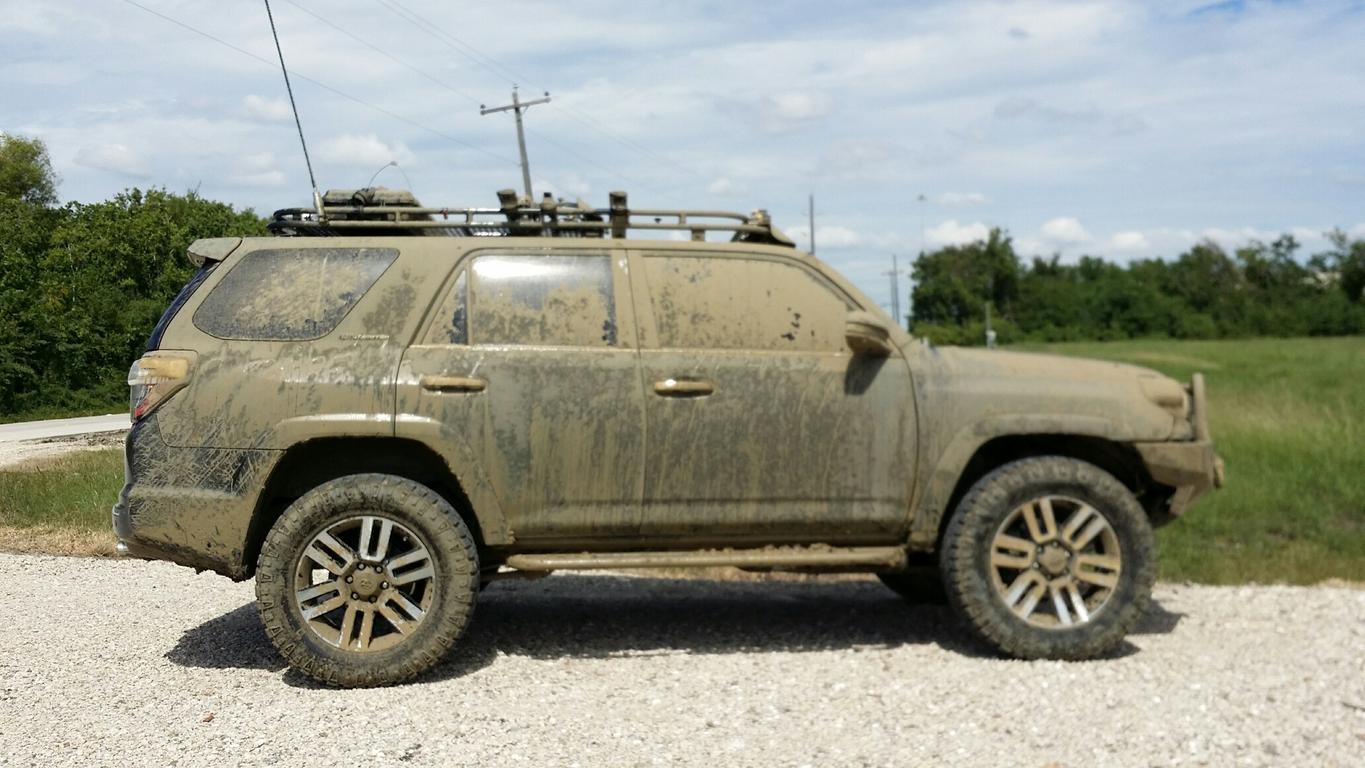

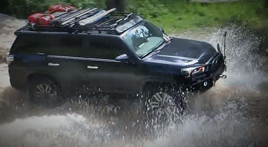

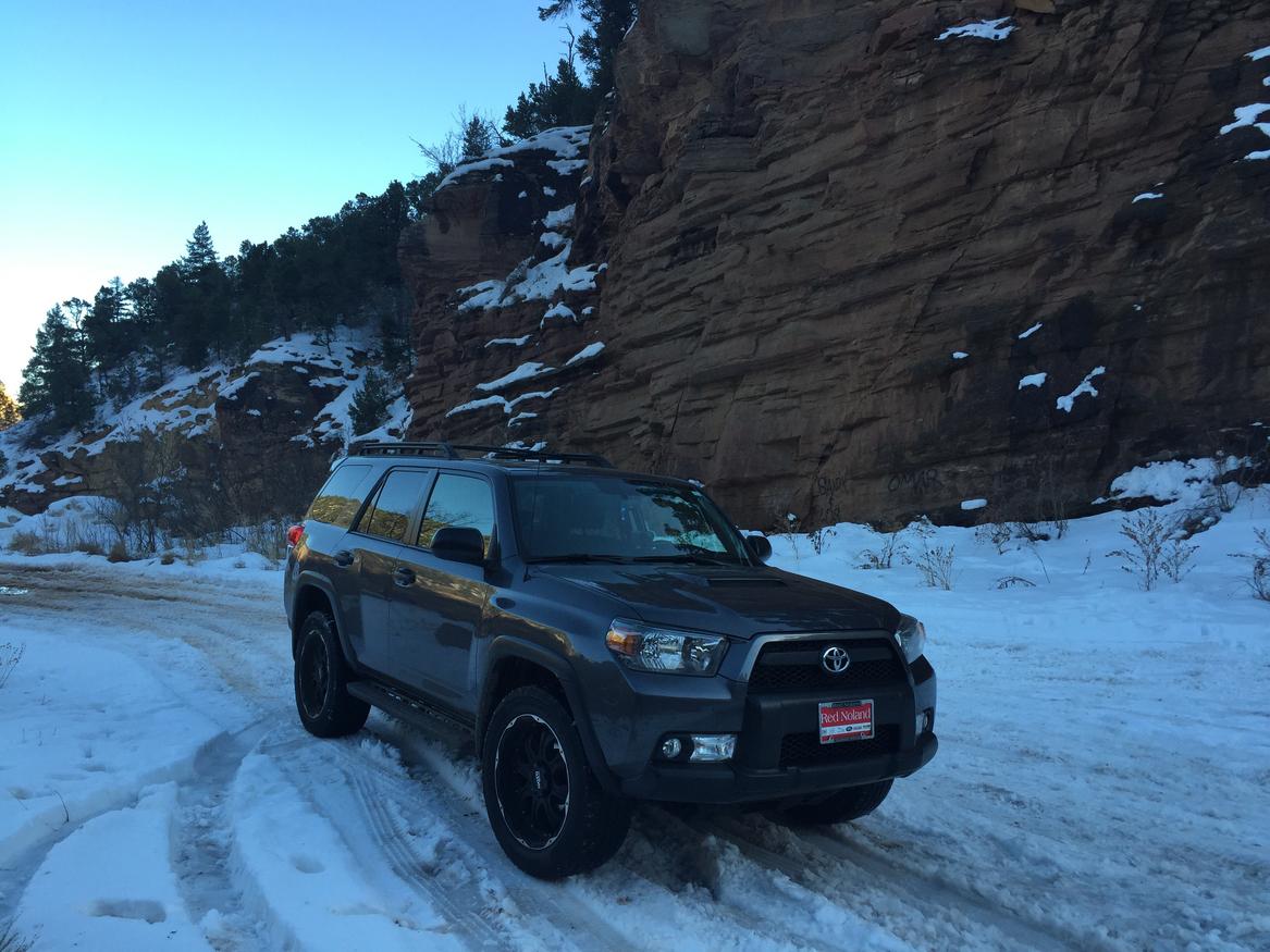

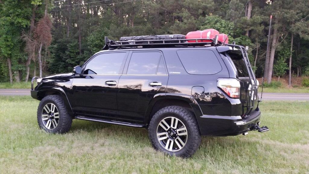

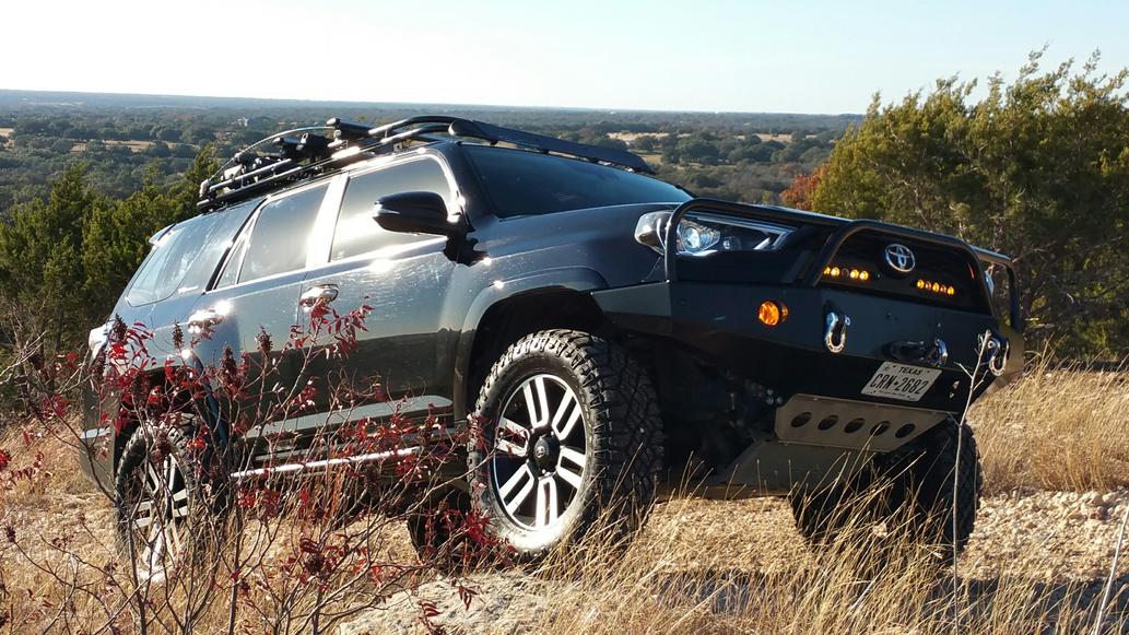

Just curious if anyone has ever kept 20" rims and slapped big mud tires on them with a bigger lift? Bc I just bought my 2013 TE T4R and it came with after market 20's
Guilty as charged!
