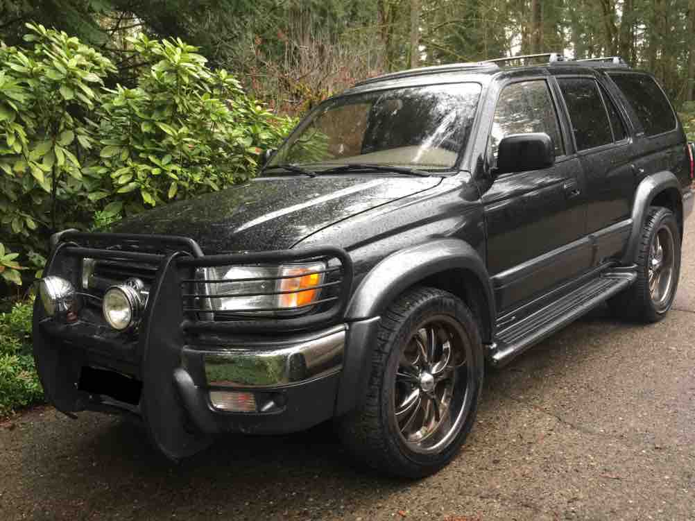

Having a couple of driving age teenagers, I took a poll of family drivers, and the 4Runner was something on the list, so I spent some time watching Craigslist, and landed a "good deal" on 98 Limited 4Runner, 3.4 2WD. 136K on the odometer, but purchased mileage exempt due to age.
$2600
And here my story begins....
