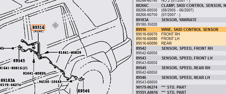

Does anyone know the part # for this (2006,V8)? I went to change the speed sensor and destroyed the harness connector (it was weathered and mush anyway). I can find ABS cables for the front but cannot find the rear. Could I just get a front harness and splice the connector onto my old cable? Cable is still in good shape.
This should be what you need.

I got an error that my Rear Right ABS/Speed sensor is out after replacing my shocks. How do you access this harness? Under the seat, or from below?
In the time it took you to write two posts, you could have easily looked under your vehicle and seen the wiring harness running along the axle housing.
