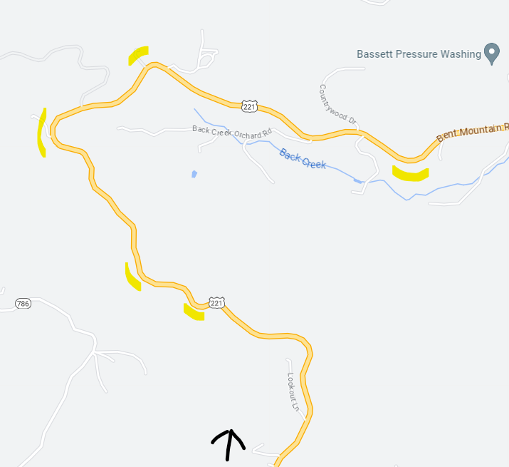

I also will say that it doesn't seem to happen at the same spot when turning the wheel. For example, sometimes just a little steering right input and clunk, others a tighter turn before the clunk.
I've attached a map of my commute and highlighted the turns that typically illicit a clunk. Heading north (up) is an elevation drop of about 1400 feet total in the stretch shown. So the truck is front heavy and sometimes under breaking when it clunks
The reverse is also true and when heading back up the mountain it will clunk with no brakes and neutral to rear heavy.
