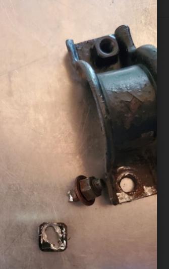

Never heard of these chassis ears before, thanks for the tip, gonna look more into them later. I could really use these trying to track down this damn clicking noise
ITS GONE!
After the chassis ears lead me to the passenger front sway bar mount, I ordered a new set and last Saturday got the time to install them.
The culprit has been identified and eliminated!
I had to drill out the stud as it just broke free and began to spin.
Thank you all for your help and support.
I'm insane a little less today.
