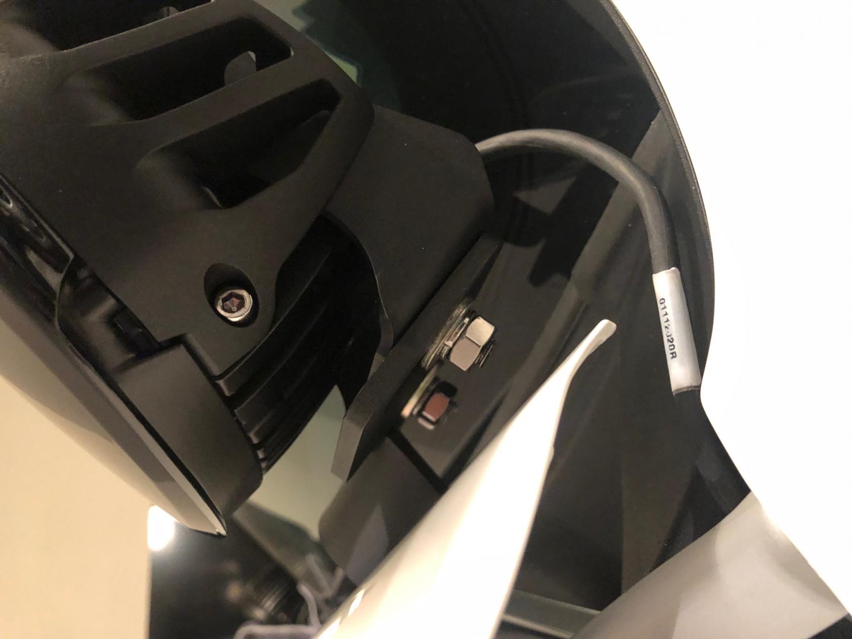

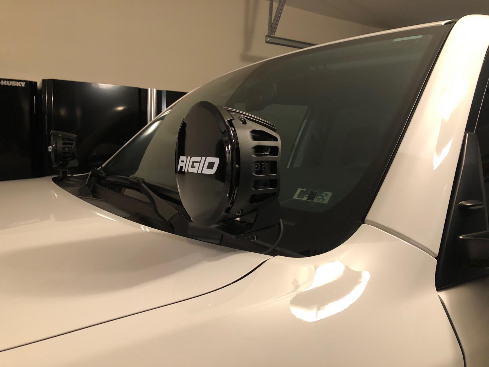

Could very well have been the quarantine that got the better of me, but I failed and now need feedback to revamp the project, properly.
I really wanted large circular lights for forward lighting off the a-pillar. I bought the most heavy ditch light brackets I could find, SDHQ and drilled an extra hole so that each Rigid 6 inch light would get two bolts though the mount. It shakes..even when slamming the door and when driving on road. Can't even image how bad it would be off road. The lights are not moving, it's the ditch brackets vibrating. The lights are just too heavy, about 3 lbs a pop. I should have known better.
Moving on...I am now looking at getting the Baja Designs squadron pros, they are reported to be only 12 ounces each. Can I please get some firsthand feedback on those who runs those as ditch lights to see if they shake or vibe? Or other light suggestion are welcome as well.

Have you thought of investing in high quality bumper lights for forward lighting instead? You're going to get a ton of glare coming off your hood if they are facing forward like that.
My CBI mounts haven't wiggled even a tiny bit. No vibration, nothing. My lights apparently weigh 1.3 lbs a piece (or maybe that's the weight of the pair, not sure), and they're just some cheap Amazon pods. But they're bright as hell, been super happy with the performance for just $30.
By bumper lights do you mean non SAE lights in the fog pockets? If so, yes and I've upgraded those to OEM LEDs because I want to use those for on road driving.
I am after an off road solution.
Thanks. How much cutting and or heat gunning did you need to do (if any) for the CBI mounts? Seems hit or miss on those. I'll likely stay with the SDHQ mounts. I've seen some of the cheap lights and they are tempting.

I took about 2 minutes with the heat gun to get the plastic warm, then closing the hood did the rest. The cowling molded around the mounts just fine.
I doubt there is a ton of difference between our products as far as quality goes, I'd be curious to see if yours still wiggle with a smaller light.

Good info, thank you. Those lights are 10.4 ounces each.
I just think I over weighted the bracket with a heavy light. I'd am hoping with a sub 1 pound light there'd be no vibe or shaking. The BD S2's are tiny and only 8 ounces, no way those suckers would vibe, but I really want the squadron pro for the output.

Haven't driven around with them but seem solid post mounting so far...
BD pros on caliraised low profile mounts. Other than the molding mod likely same way to mount under hood (verify the bolts are tight under the hood??)
If you did decide to change up, may not need to do this on the cbi since the mine were the low style mounts but to get more clearance at the back with the hood raised reverse the bracket so it pushes the light fwd a bit. Pros are slightly larger than the sports most seem to use.

I think caliraised makes brackets for round lights behind the grill. I made my own, it’s easy. I wouldn’t worry about covers. You can barely see them and I’m sure no one running light bars behind the grill, even in cali, has covers in them.
i've had a few sets of a pillar brackets, never really installed any. but the SDHQ was the most heavy duty there is.. If those vibrate, everything else will be much worse.
I have a whole bunch of cubes around, and the squadron pros are definitely nice, the diode dynamics ss3... are probably the nicest cubes by far.
I have XL 80s on my raptor, and even those seem big on a raptor but no vibration on the SDHQ A pillar brackets on my raptor.

Thanks rayofsi.
Yeah, the brackets for certain are not to blame. Light is just too heavy. I am going to try the squadron pros which I think are a touch smaller than the XLs.
