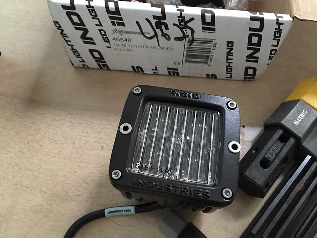

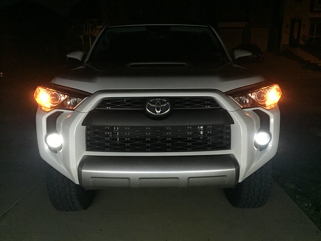

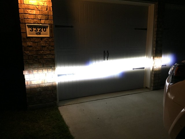

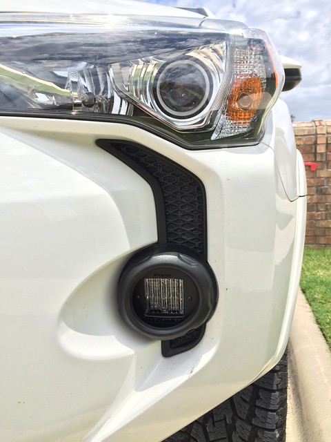

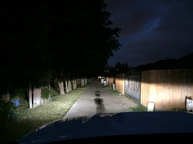

So I searched on the forum to see any photo tread of the Rigid Industries DOT fogs and didn't really come up with much. Received the set over the weekend and was able to install them the same day. I wired mine with the harness that was included ( yes, I will lose the stock options but will use that later on for future project ie. spot light ). Still need to adjust them a bit but over all I enjoy them a lot on road.
beam output, just need to adjust the passenger side down a bit
iPhone photo, will take some better with my DSLR. This photo shows Xenondepot Phillips 4300K HID with Rigid Industries DOT/SAE approved fogs.

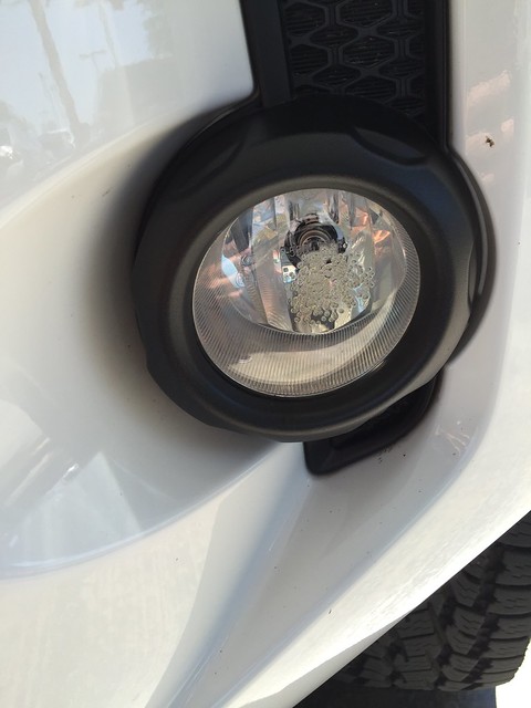

This photo shows how it would look like if you put an HID or an high wattage bulb in the fog housing... It will bubble up and melt. The previous owner had HIDs in them and it melted the housing

Oh no! Most people simply don't understand that the (plastic) housing's specifically made for a Halogen bulb. HID's scatter light and excessive heat melts.
I've done many conversions to LED/HID in the past and always cringe when I see something like this LOL

I can't tell from the picture but is there enough room to use the colored covers on these fogs with the brackets? I am interested in these but prefer to use the amber covers.

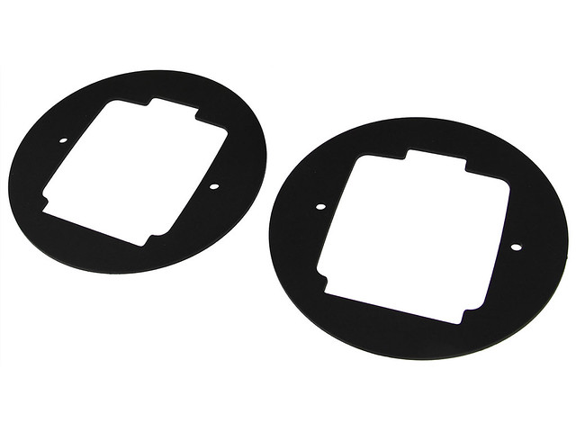

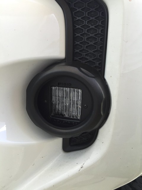

from the look of it, you can't put amber covers on it since it " snap " around the body of the housing. You can take off the the round metal cover but you will have just a square light in an circle opening. You can get a sheet of yellow or amber Lamin-X and cut it to size and place it over the lens.
this is the part you have to remove if you want to put any covers on it.
