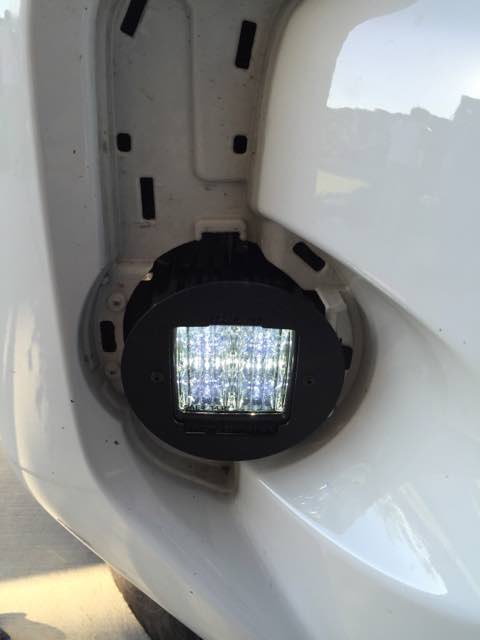

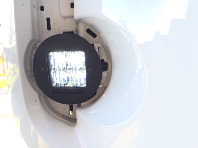

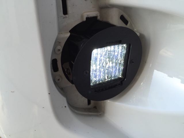

Adjusted the height so here's a better front view of where the tab is inserted in

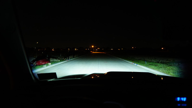

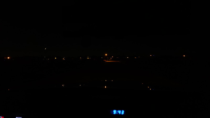

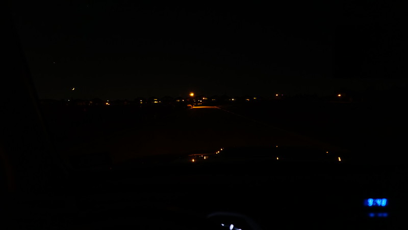

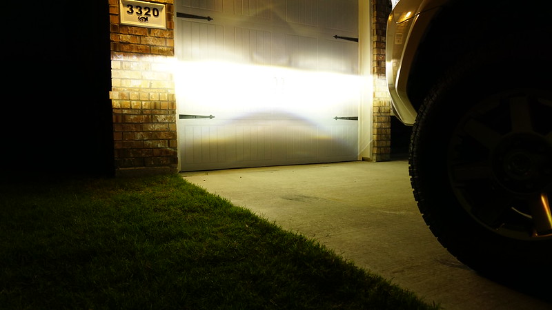

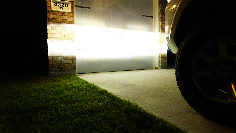

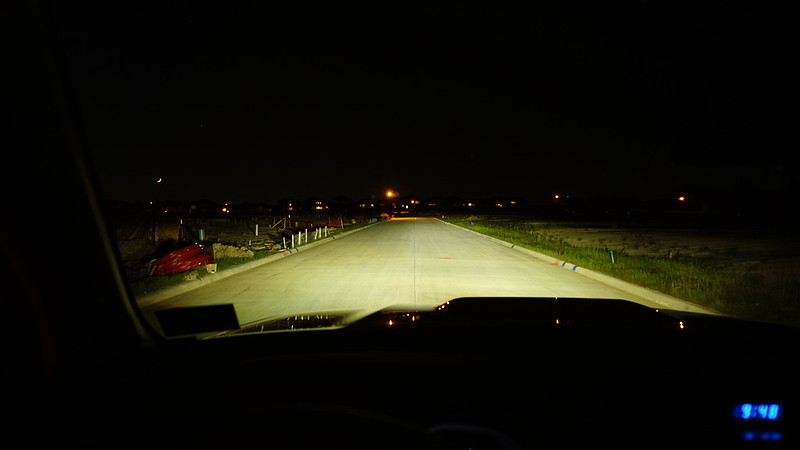

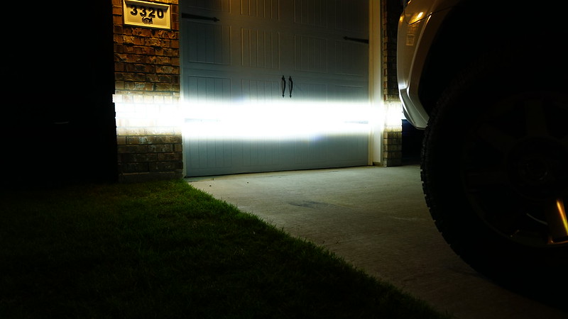

Photos of Rigid Industries DOT/SAE fogs and Xenondepot 4300K HID
this set is from the middle of the console.
Camera setting:
F3.5
ISO 400
Speed 1/5
White Balance: Daylight
No lights
Rigid Industries Fogs only
[MENTION=12905]XenonDepot[/MENTION] Phillips 4300K HID only
[MENTION=12905]XenonDepot[/MENTION] and Rigid Industries Fogs
[MENTION=12905]XenonDepot[/MENTION] hid, Rigid Industries Fogs and High Beam
From the drivers seat. I'm 5'11 and position the camera where I would sit at.
Camera setting F3.5, ISO400, Speed 0.4", White Balance: Daylight
everything off
Rigid Industries LED fogs only
[MENTION=12905]XenonDepot[/MENTION] Philips 4300K HID only
[MENTION=12905]XenonDepot[/MENTION] HID and Rigid Industries LED Fogs
Driveway facing garage
Camera Setting: F3.5, Speed 1/13, ISO400, White Balance: Daylight
everything off
Rigid Industries LED Fogs only
[MENTION=12905]XenonDepot[/MENTION] Phillips 4300K only
[MENTION=12905]XenonDepot[/MENTION] Phillips 4300K HID and Rigid Industries LED fogs

Any tips on aiming the fog lights? I installed the rigid lights and from driveway distance, my lights seem to be about height as your pictures/others who posted in the other thread. But when i back up or test it out on the street it seems like there's a lot of glare.
I took the lights out and tried adjusting the mounting bracket but it didn't seem to really help that much. And I tried searching online but it seems the only adjustments other people recommended was the adjusting the bracket. Thanks!
The only adjust there is really the bracket itself. I know Rigid has different options on the Dually's. Theres the Spot light Dually's, Flood light dually's and the DOT/SAE Dually. Which one do you happen to have?
I have the same DOT/SAE ones you got. Thanks for letting me know!

when I was installing mine the driver side was correct level and the passenger was pretty high up, it was hard to adjust the passenger side cause it was rubbing against the fog trim up front. What I did, I took out the plastic cover in the front of the bumper and adjusted and tighten the screw and then reinstall the front fog covers. If I remember I parked the t4r about 2-3feet away from garage door and the top of the fog beam was about 13-15" from the ground
