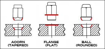

So I got my rims it today for my build and the holes line up but there no way nuts are going in much less a socket my pattern is 6x139.7 I have spierxx spacers or whatever there called.
well the spidertrax also have the 6x5.5 lug pattern so its probably not the studs, what nuts are you using? stock? and what are the rims? aftermarket wheels sometimes require different style lug nuts.
My profile pic is of the rim and holes bc im doing this on my phone, stock want go im going have to have a new set the problem is what set of lug nuts do I need, I have the dropstar64B. Im not sseeing tunner lugs to fit a 4runner
You need to contact the manufacturer of the wheels to find out which ones are correct. Do not guess because if you are wrong, you risk damage to your wheels or worse, one coming off.
