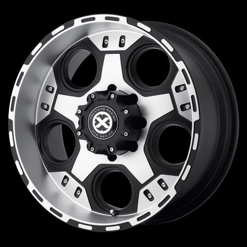

Here's the rim I want to go with. American Racing Justice AX184 with a -12 offset.

FWIW, I have 17x8 rims w/ 4.5 inch Backspacing and 0 offset. 275/70 tires. The wheels are almost perfectly flush, maybe a tad past the fenders on my 2007 which has wider fenders than the 2005 and earlier models.
I love the stance of my truck w/ this setup, check my build thread and member pics to get an idea of what this size/setup wheel does for the runner.
My wheels are Pro Comp 7105s, Love the way they look and they improved the stance dramatically!

usaf: those wheels look pretty nice, let me know how it goes when you have them on
