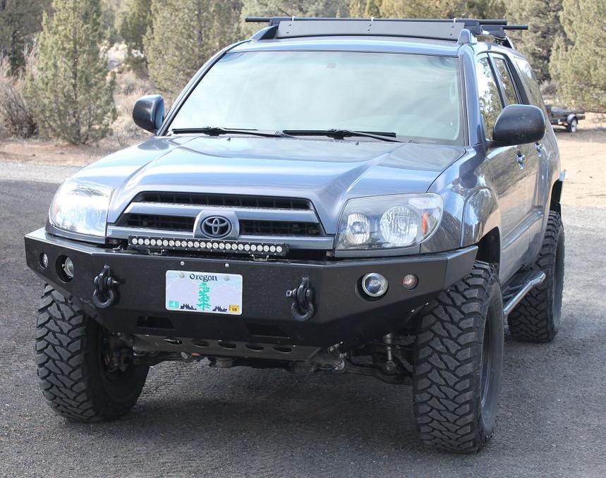

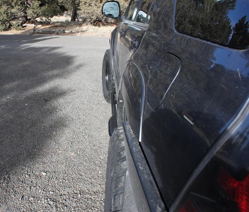

I had the same idea, more sidewall bulge to protect the rim. 16x7, -16 offset.
With the 285s I had on, my impression was that they are louder than the 16x8 rims they are on now. Made the flat of the tread area curved? Made my T4R vibrate all weird at slow speed on pavement. Not as much an issue with a narrower tire I would guess.
The steering felt a little heavier.
With the low lift I have, the 16x7 -16, was hitting the tires on the fenders and the front body mount.
Really messy in the wet...poking out.
Cops look at you.
