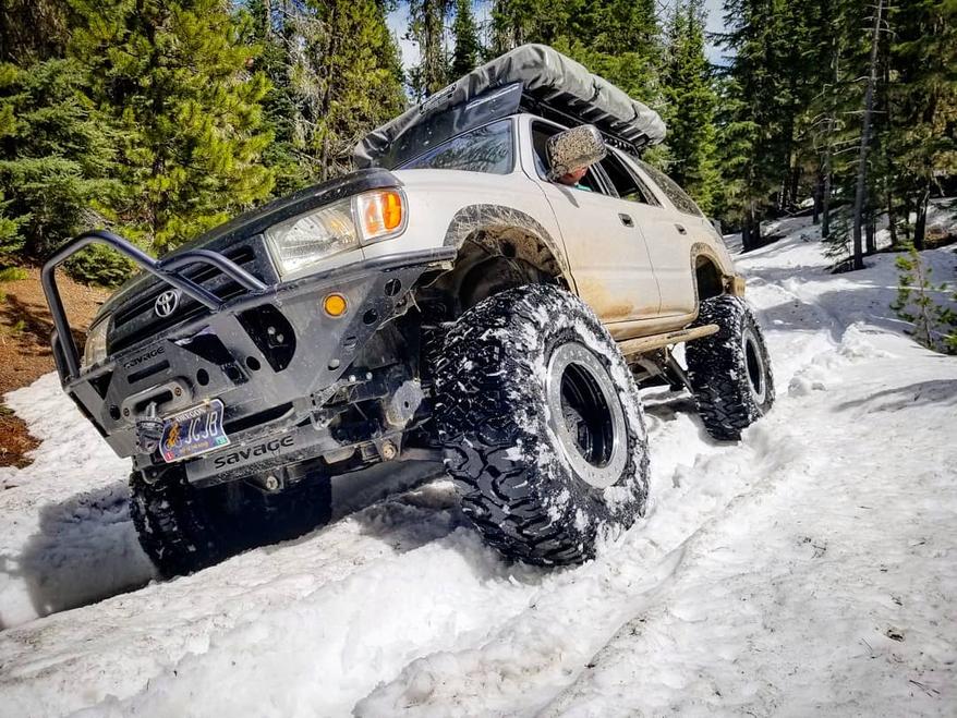

Looks like someone got a pic while I was trying not to slide in to rocks and some trees coming up on the passenger side.
