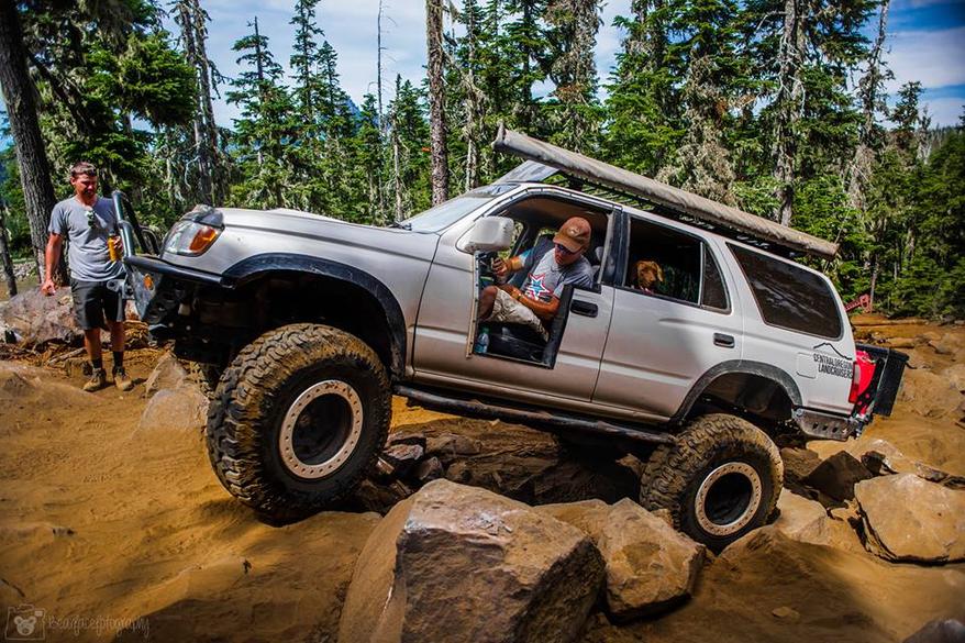

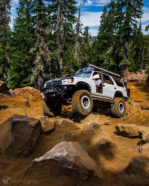

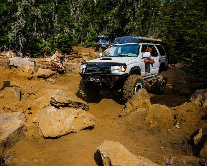

Such a great day Saturday! Man, till I just saw your pics- I didn't even know there was big rock like that there!
It should definitely be called "Jeepfest" though. There were- what- 200 Jeeps and 3 Toyotas?!
This was easy to drool over though
Had a great time wheelin [MENTION=135317]rkntoy[/MENTION]'s rig, and I was blown away at how nice that 3RZ is! Awesome engine.
