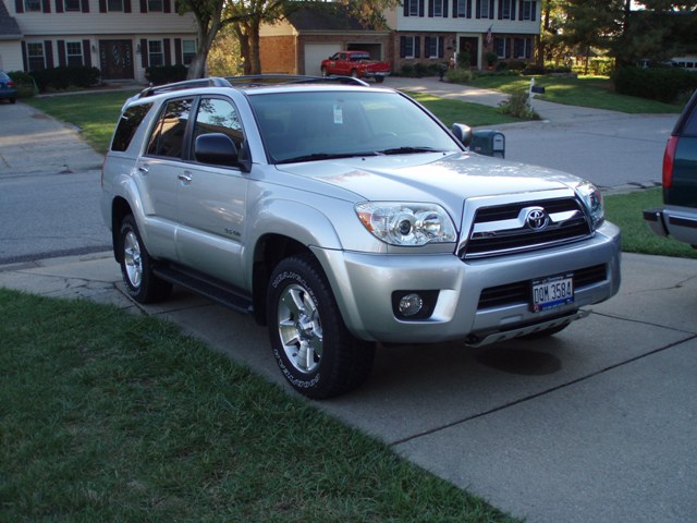

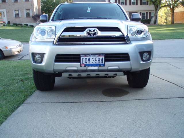

RL's Goodyear Wrangler Silent Armor Review
Last one

Falls said:
Nice !!! I have tire envy :D Did you get P , C or E rated .
Haha, I was in your shoes for the whole past year!
I got the P rated. I rarely ever off road, so I didn't really feel like it would be necessary to get anything else.

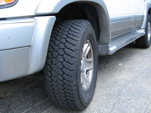

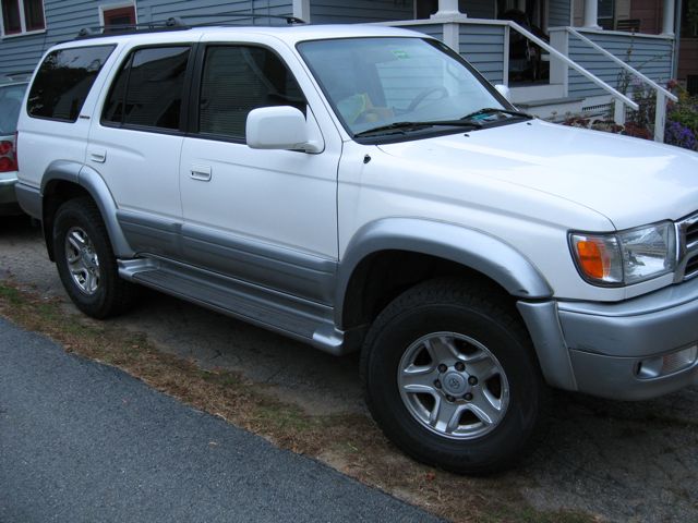

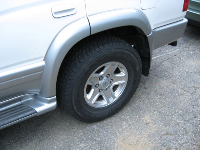

maine runner said:
In a few days, I will post mine mounted without the lettering so you can compare.
Looking forward to the pics. My stock Bridgestones had all black walls on the outside so I figured it would be a nice change of pace to have the white letters on the outside.
