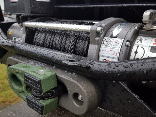

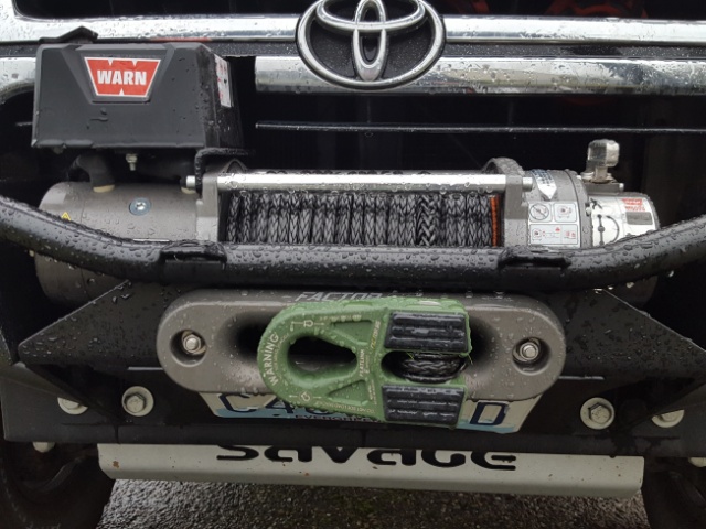

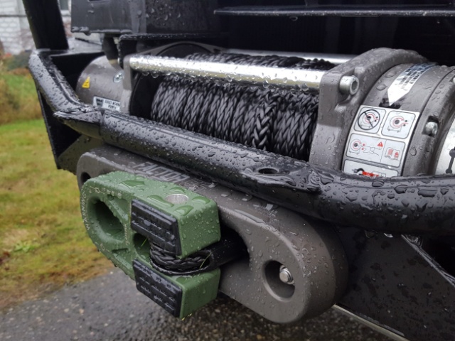

Switched to Master Pull synthetic winch line.
Last night a friend and I swapped out my steel cable and roller fairlead for 100 ft. of Master Pull 5/16th Superline, (breaking strength 21,700 lbs). I replaced the fairlead with a Factor 55 1.5" hawse fairlead and a Factor 55 Flatlink Expert shackle thimble.
I think next time I will go with a bit less line and go with a few extensions. This will make fitting it all back on a bit wiser. But we got it all on. I will need to practice my line winding technique to get it all on spooled evenly. The combination of AOR front bumper and Warn m8000 makes for tight quarters for this job. Not that big of a deal though. I just had to remove the four winch mounting bolts to slide the winch back a bit to access the fairlead mounting bolts.
Of note... if you are picking up a Factor 55 fairlead, make sure you have longer bolt hardware as the fairlead eats up a fair bit more threads. I suggest 1.5" as a replacement. This gives you plenty of thread to work with, but doesn't protrude past the face of the fairlead.

Looks really good!
I thought the manual for my Smittybilt said to wind steel cable neatly like you did, but to wind synthetic in a criss cross pattern to keep the line from pulling into the inside of the drum when it's under tension. That's how mine is wound, but I don't know if that's the totally correct way, or if that's just how Smittybilt says to do it. Does your Warn say anything about how to wind synthetic?

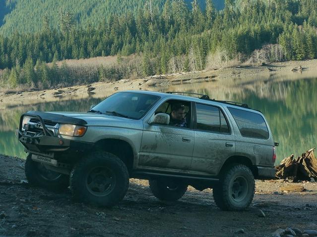

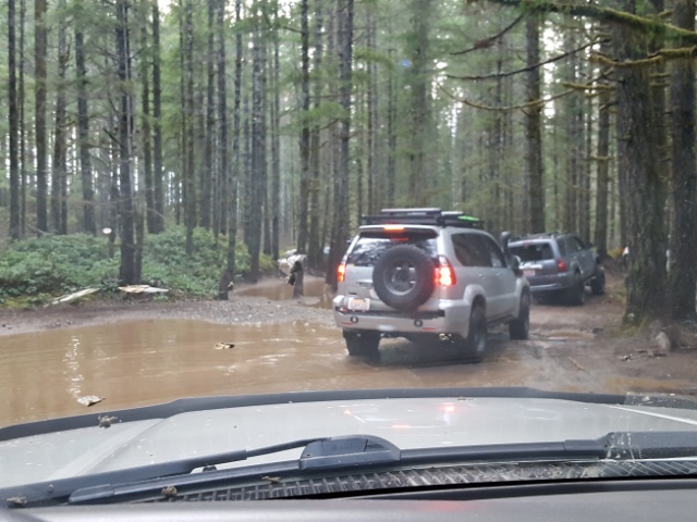

Olympic Run 01-14-18
Went back to the Olympics with a 4Runners of Washington FB group. Wow! Talk about a beautiful day! It was warm in the sun, mid 50's. We did a short trail run and did a bit of sight seeing stopping by Wynoochee lake and dam. It was cool to see a dam up close. Brought my special lady friend. Hahaha... We go to the meet location to pick up some sandwiches for lunch, and she finds a orchid plant she has to have. So it came along for the ride.

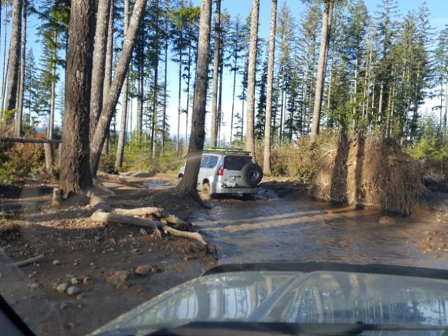

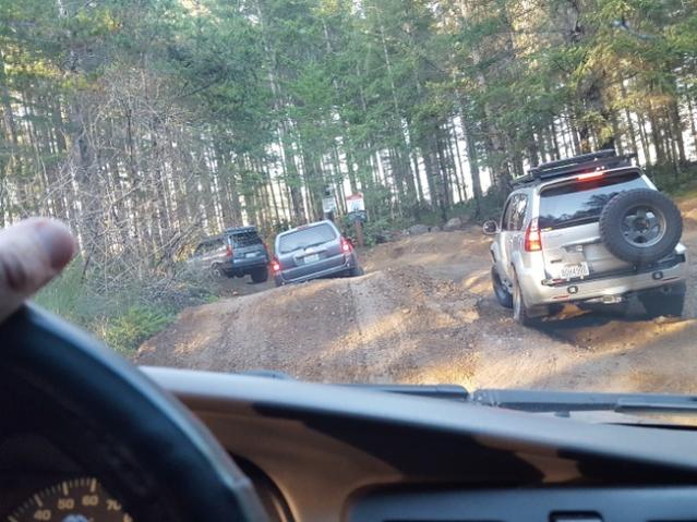

Tahuya run 01-15-18 with a GXOR Facebook group.
So after my return from a fun day out in the Olympic Forest, I noticed someone post about a group getting together to hit Tahuya the next day. I have been wanting to get out there for months, but it just never worked out. The last time I missed a big 4Runners of Washington group that headed out because I had just mounted my F5's and they rubbed bad just making turns to park, let alone off-road. So I sat that one out and had been kicking myself in the ass since. But I had gotten up stupid early for me 0615 hrs just to make the early Olympic Run.
So I went to bed and woke up at 0800 and the 1030. I was just scrolling through FB and noticed that some said that they were meeting up at 1300 if I wanted to meet them in Belfair, WA. at the Safeway. Yes. Yes, I did. I was mostly ready to go from not fully unpacking from yesterday's trip. I loaded up and headed down there.
I pulled into the parking lot a few minutes early and noticed quite a few built rigs. Quite a few GX470's. It turns out it was a GXOR FB group meet. They were all cool and had some VERY nice rigs. One of which was rolling 37 inch tires. There was one other 4th gen 4Runner there, so I wasn't the only one. Lol. I just kept singing, "Which of these things is not like the other?"
Oh! It was funny heading from the rally point to the teail head where we briefly needed to sort out directions in a small parking lot... at the Woman's Prison! We got security's attention pretty quickly. Hahahaha.. It looked like we were there for a Jail Break. Cue Thin Lizzy.
We got to the trailhead, aired down and began our run. All the pictures I saw from the last tahuya run had tons of water crossings that looked pretty deep. So i was a bit apprehensive about playing submarine in my DD. As luck would have it it wasn't that bad. The initial obstacles we're fairly impressive compared to anything that I've come across so far in the 4Runner. Lots of off camber turns tight Trail geometry and big whoops. I didn't want to be the weakest link in the group as I was running open diffs. As it turned out I did just fine and never got stuck and had plenty of clearance for all obstacles traversed. I think that was the most fun I had in the 4Runner off-road so far. Parts were challenging but all easily doable. The 4Runner did great!

In other news, I think I will need to rethink the issue of covering my winch line to protect it from sun and grime. I had bought some rubber type PVC material, but there is pretty much no room to work it around the spool. So that is sidelined for now.
I have a feeling that my tax return will not sit around long. LOL.

As far as the winch cover goes here's an idea. Pull out five feet of winch line. Tuck the membrane between the spool and the line. Crank the winch in. That should cover the spool. If you get the turns down correctly it should also help hold the membrane in place. It'll leave some exposed but not much.

Not a bad idea with the winch line. I should have opted for less length, and just have ordered an extension to go with. As it is, it's a lot of rope on that spool.
