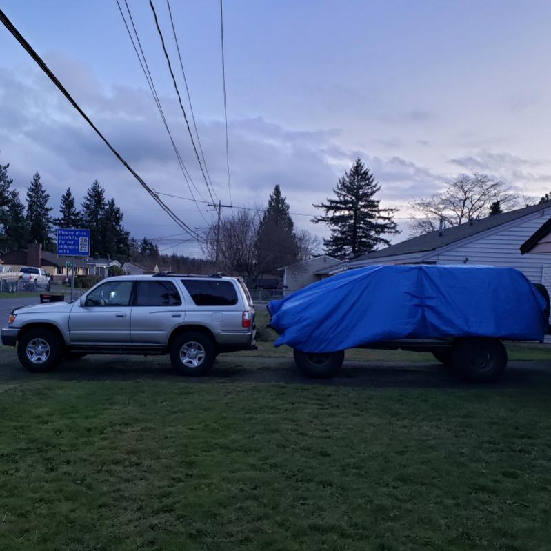

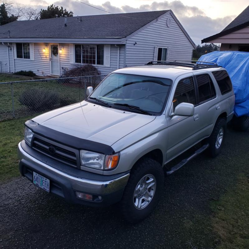

It wasn't easy, but I found a replacement. I tracked down another 2002 SR5 with no cladding or fender flares. 205K miles. No rust. Hell, no sunroof! Good...
I picked it up down in Oregon. Got into Washington and picked up my new plates after doing title transfer. Pulled into driveway, swapped plates, and ditched the nerf bars.
