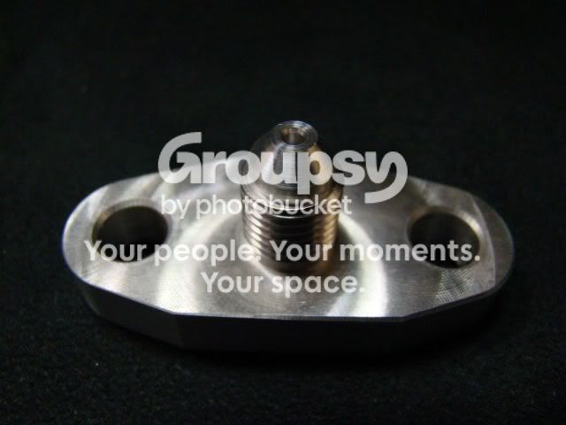

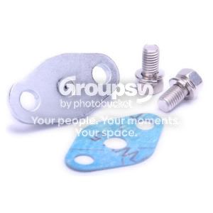

I use restricted oil feed flanges on my stuff now, cheaper, easier, and one piece. Build is looking good.
