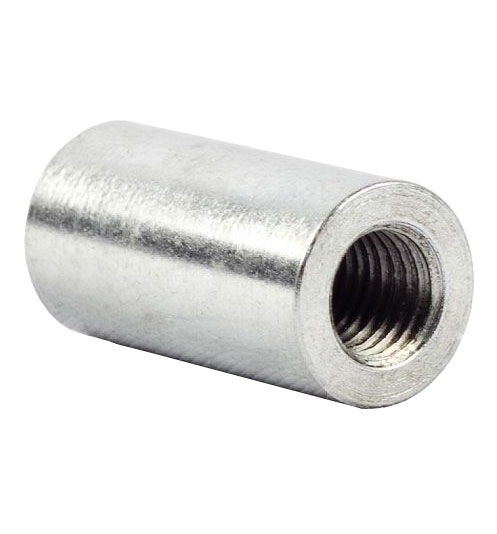

If there were grade 10 rivnuts out there I'd consider making mine bolt on, but how would you collapse them?
Sent from my Pixel 4 XL using Tapatalk
You could do something with threaded tube, probably. Hole through both sides of the frame (smaller on outside, just for the bolt), bigger hole on the inside. Bolt the sliders up, then weld around the tube. You'd still need to remove the gas tank to get the rear driver's side done though.
No way to get good pull-out with a rivnut of that size. Imagine that install tool...
