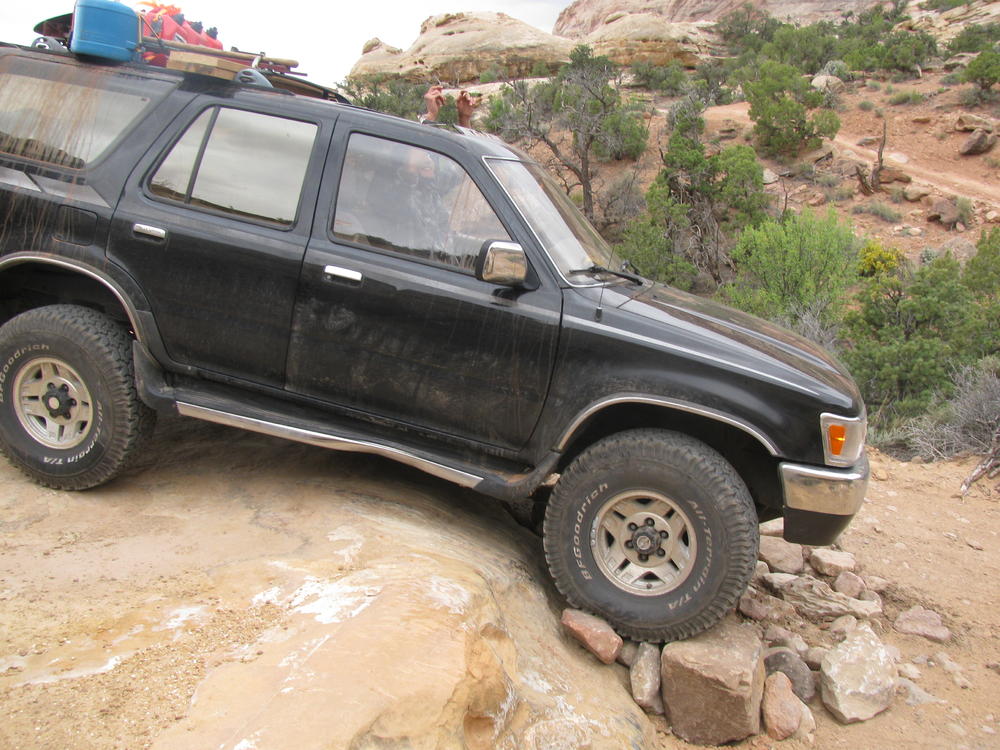

Running boards are for looks, for stepping on, and for reducing road spray up on your doors. They do nothing for rocker panel protection, and look like this (or worse) after dragging over a rock.
If you never plan on hitting any rocks with the side of your vehicle, go running boards. If you want actual protection, get sliders.

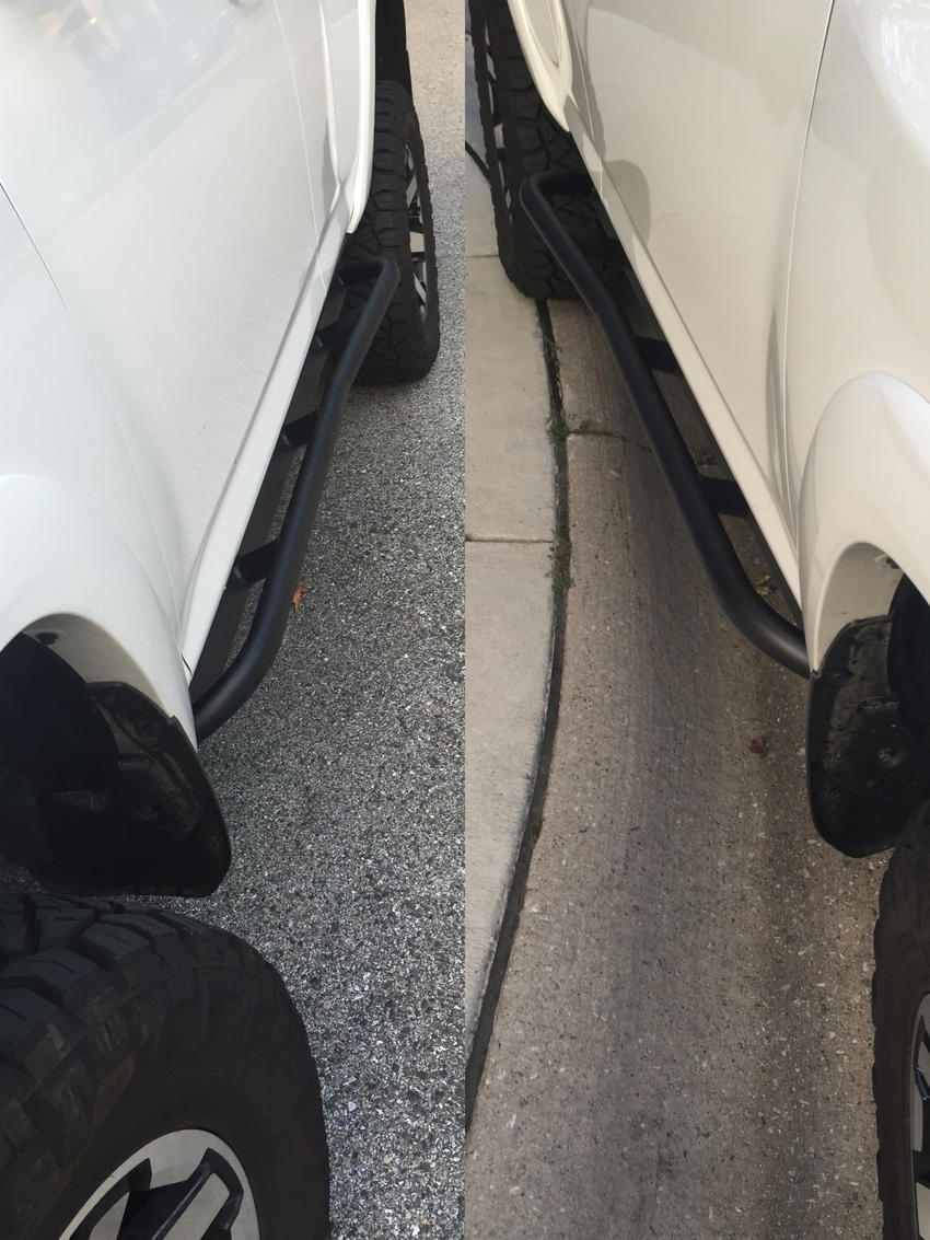

Give the RCI sliders on toytec a glance. Minimalist appearance. Moderate price. You did yourself a favor not getting oem running boards
