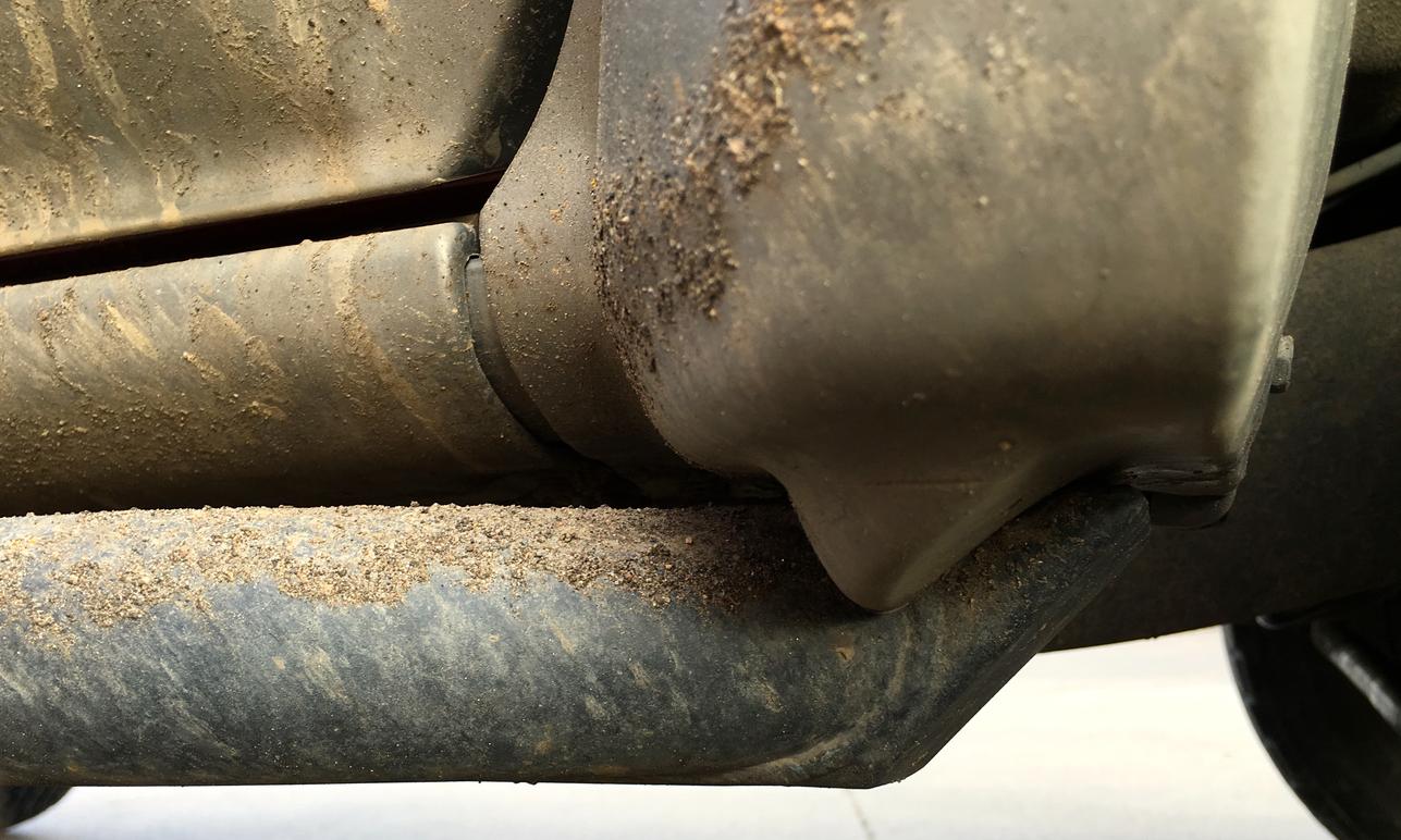

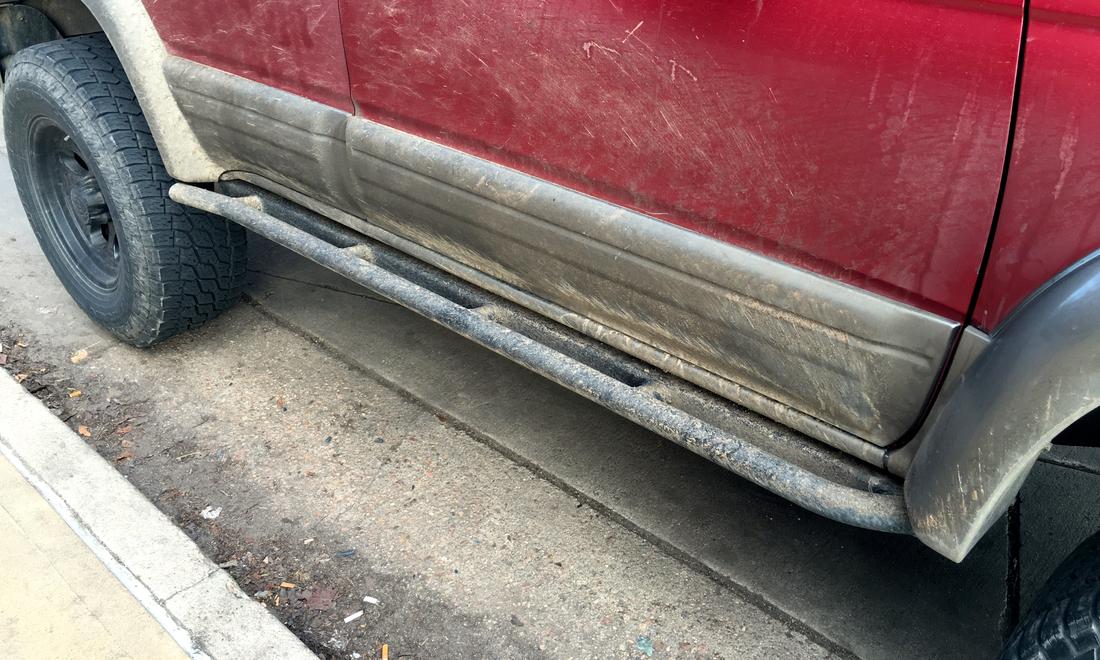

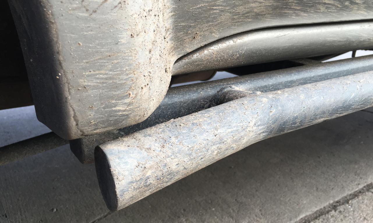

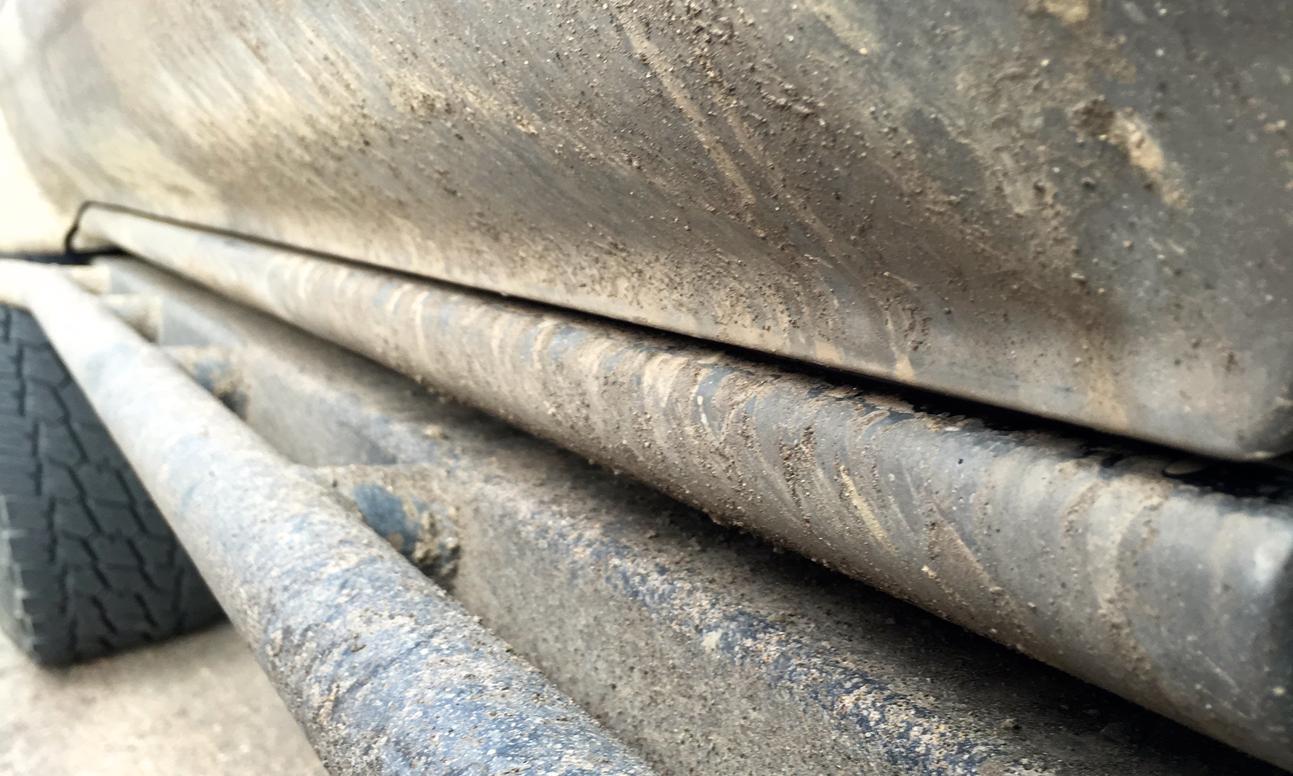

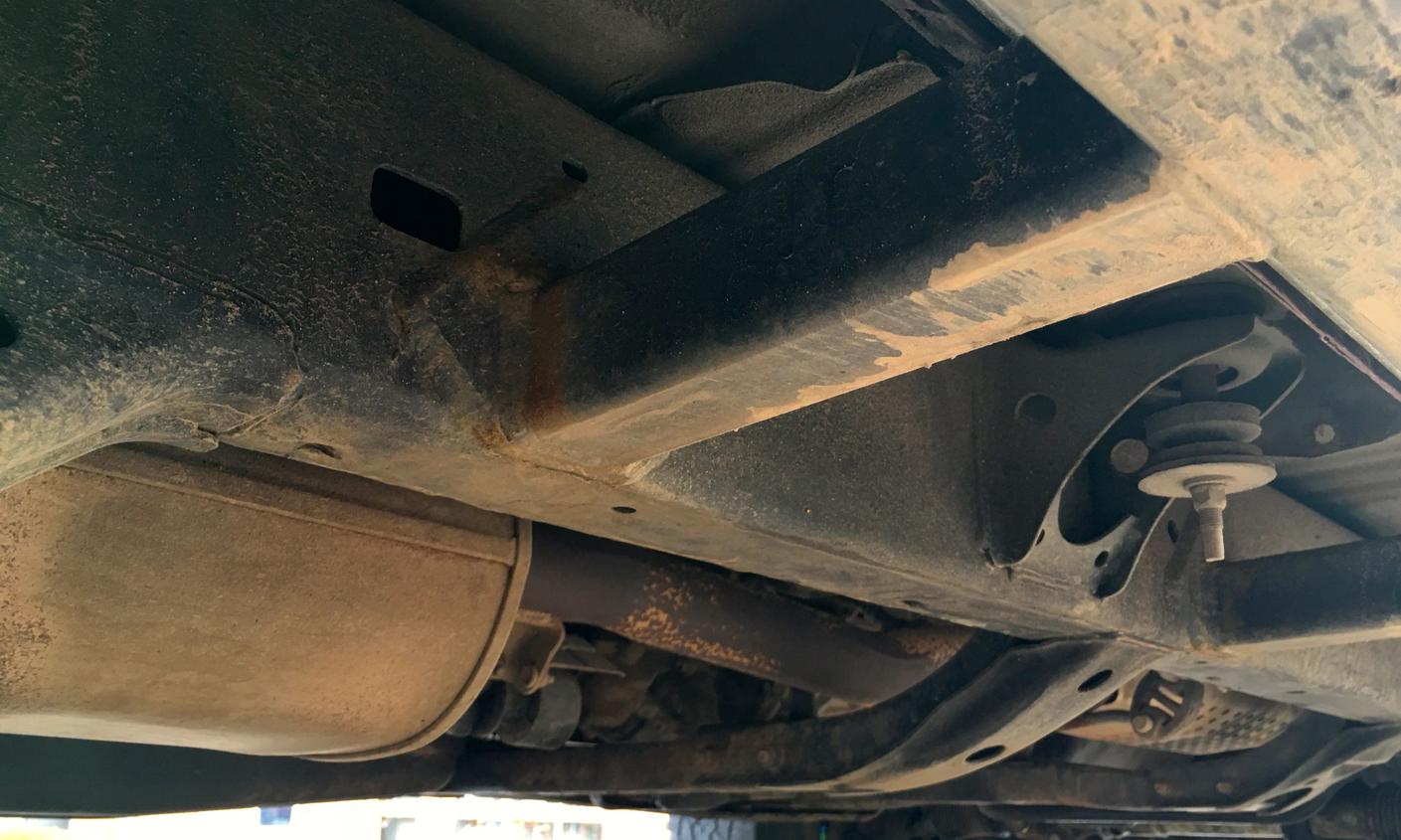

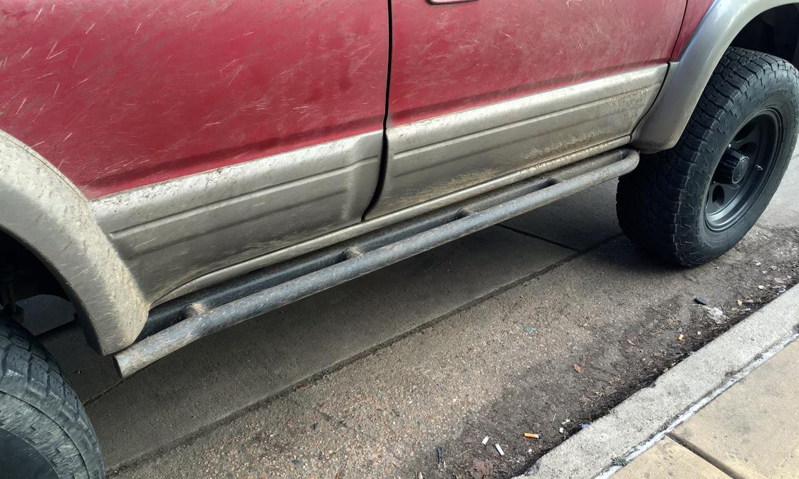

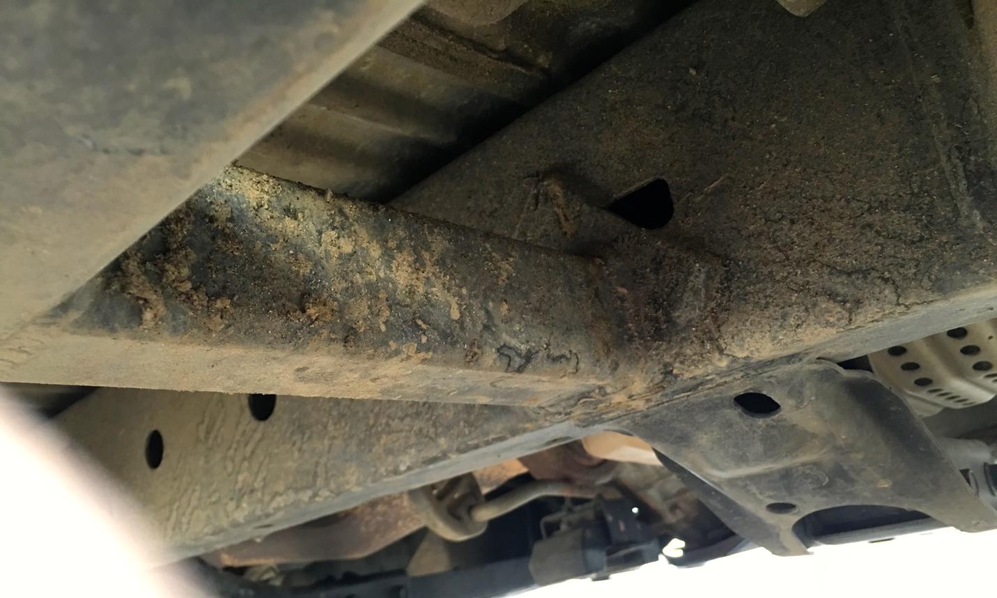

+1 again for Addicted Offroad HD Sliders. After getting run into a ditch over New Years and saving my lower door sills, I'm a believer in their quality (some of you my emergency post). These things are heavy and well-built. Living in the Fort Collins area, I had the privilege of having Scott and crew at Addicted weld them up for me. The fitment is top notch! The kick is just right for my tastes, as well. Pictures are a bit dirty, but winter driving here in Colorado is kinda ugly!
