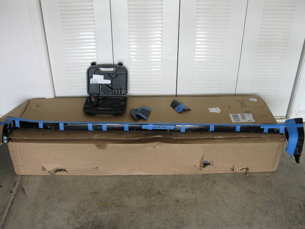

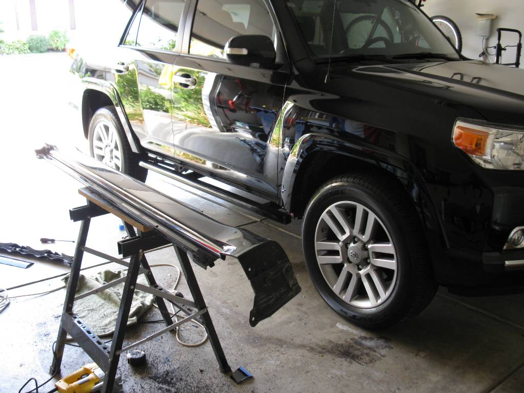

I installed the Shrockworks Rock Rails on my limited and ran into a few issues. I had to bend out the hard lines in the front and create a bracket out of a bolt, 2 nylon spacers and a hose-guide with rubber padding.
I also spent 2 weekends cutting the factory rocker panels and used the trimmings to clean up the rockers so it would have a more factory look when reinstalled.
The end result was that there was too much material (especially at the front wheel well) hanging to low and as a result when the truck moves, you would hear the plastic moving. I am now shopping around for the Trail Edition plastic (rockers, fender over molding and mud guard) and my dealer is painting it to match the factory black of my truck.

(I have more pics of the process, but since I think the experiment failed, I didn't include them here but can make them available on request.)
I commend your bravery. It looks painful from just the two pics you have posted.
