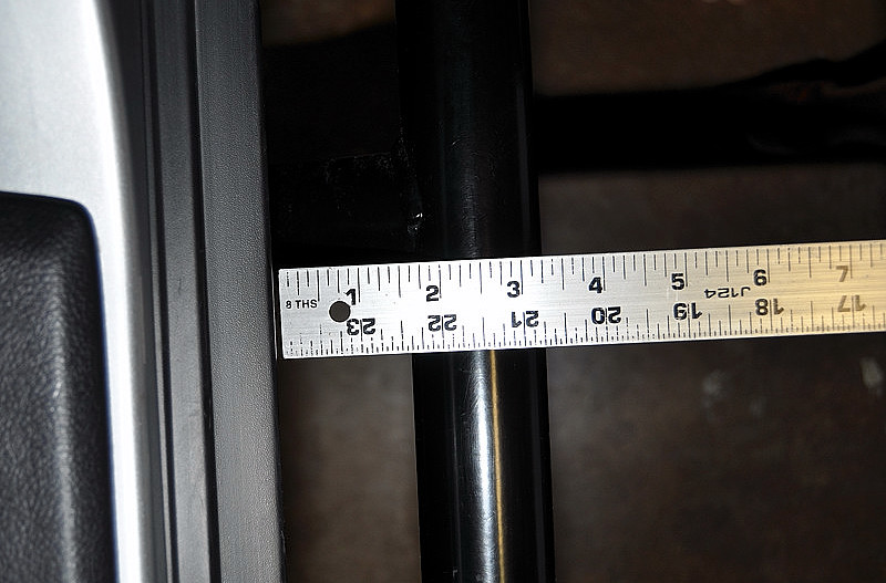

Here is a pic of the measurement for exactly how far the Shrockworks stick out .This picture is shot looking straight down near the rear of drivers doorway,right below where the door weight/info stickers are.
It gets a little bigger,maybe a 1/4 to a 1/2 inch,the farther you go back as the sliders go straight like the frame but the body curves in a little bit near the rear doors.
If Egstyle or someone who bought the Rocky road ones,would be so kind to shoot us a pic of the measurement of rocky road sliders at the same place we would know how much farther out they sit. I really don't think it's that much.

This forum never ceases to impress me. Rulers and photographs and you guys all rock.:hatsoff:

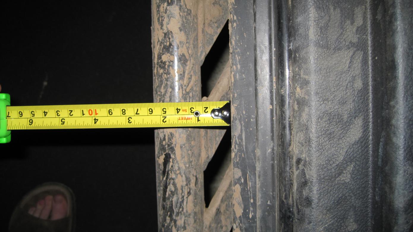

Same location as Harper's:
Looks like you get an extra inch out on the Shrocks.
To be honest with you, I don't think either would be all that helpful for a little lady to get in, as they are almost as high up as the door step because they are angled up. They just stick out farther and maybe an inch or two lower than the step. Shrockworks guys have a shorty's opinion on them?

nice job with the comparison photos, guys. they both look great and you're good to help others make a more informed decision.
Egstyle gets extra points for mud! :D
Ice Nomad's Rocky Road sliders appear to stick out further than mine, so it looks like they made some changes between the set that I got (the prototypes) and the production design. Also, his has 6 diagonal supports per slider, while mine has 8. Probably not a big deal. Those seem comparable with the Shrockworks as far as how far they stick out. Anyone else buying Rocky Road sliders will probably be more similar to Ice Nomad's than mine.
In looking at it, it dawned on me that he removed his rocker panels to fit the sliders on his SR5. This might account for the difference as you have a Trail Edition.
