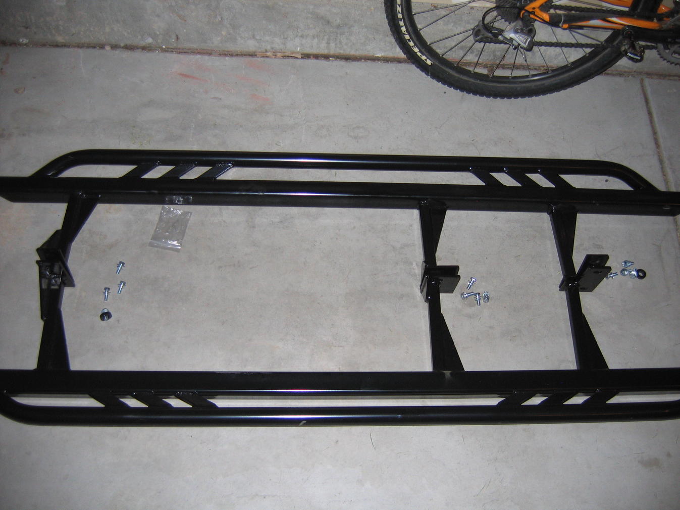

Just got my RR sliders for TE with KDSS today. Tried to install the spacers behind the KDSS brackets, but couldn't get the new self tapping bolts to go in the holes. Is there a trick to getting these bolts started? Hitting them with a hammer? :) Or just being able to apply some strong pressure to them until they start cutting new threads? They also look slightly bigger than the stock ones I removed. I assume this is so they make a tight fit. Thanks for any advice.
I had trouble getting mine started as well. From what I remember when the frame is painted some of the paint gets in the threads causing it to fit super tight. I actually took one of the factory bolts and used it to start all of the ones that RR sent with the sliders. You will also have to pry pretty hard to get the spacers behind the brake line. I hope your install goes smoother than mine! I did not have the good fortune of an extra set of hands!!
Happy Modding!!
Thanks for the advice. I already tried to use to stock bolts with the RR spacers. They weren't quite long enough. I did have to use the pry bar to get the spacers back there, but it wasn't too hard. I will probably clean out the holes before trying again. Anyone else have any tips?
I used the stock bolt to basically "clean out" the extra paint in the threads, and then I used the bolts from RR for final attachment. Pretty sure there was also quite a bit of WD-40 used too. Even using the stock bolt it almost felt like I was cross-threading the bolt/nut.
I did the same thing as Preston8114 did. Using stock bolts cleaned the threads out nicely. I just used a jack stand as my second set of hands and didnt have much trouble installing them. I never got spacers with mine, can you post a pic of them for me?
The spacers are the black disks in the picture below. They are basically thick powdercoated washers. Since I have unbolted and rebolted the KDSS line bracket bolts, I would assume the threads would be pretty clean. But I will try WD40 on them too. Did the new bolts RR supplied for the KDSS line brackets appear thicker than the stock ones?

They did not ship mine with the sliders, I had to email and request them. I was too impatient to wait for them and I already had the passenger side on so dad found some similar stainless steel washers and I used them.
