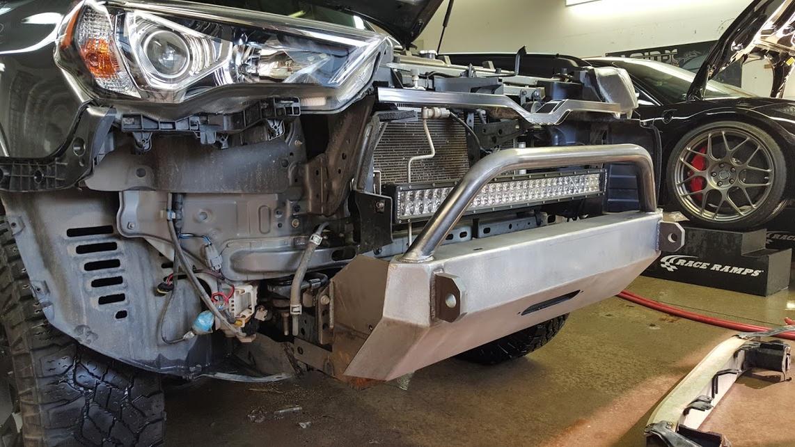

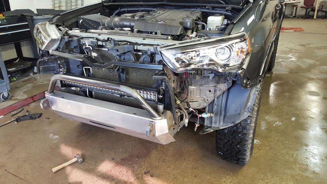

Received my Southern Style Speed slimline bumper and test fitted it before getting it painted.

Nice build!
OP, your build is coming along great! Really dig the simple mounting of your 30" stealth light bar. Subscribed!

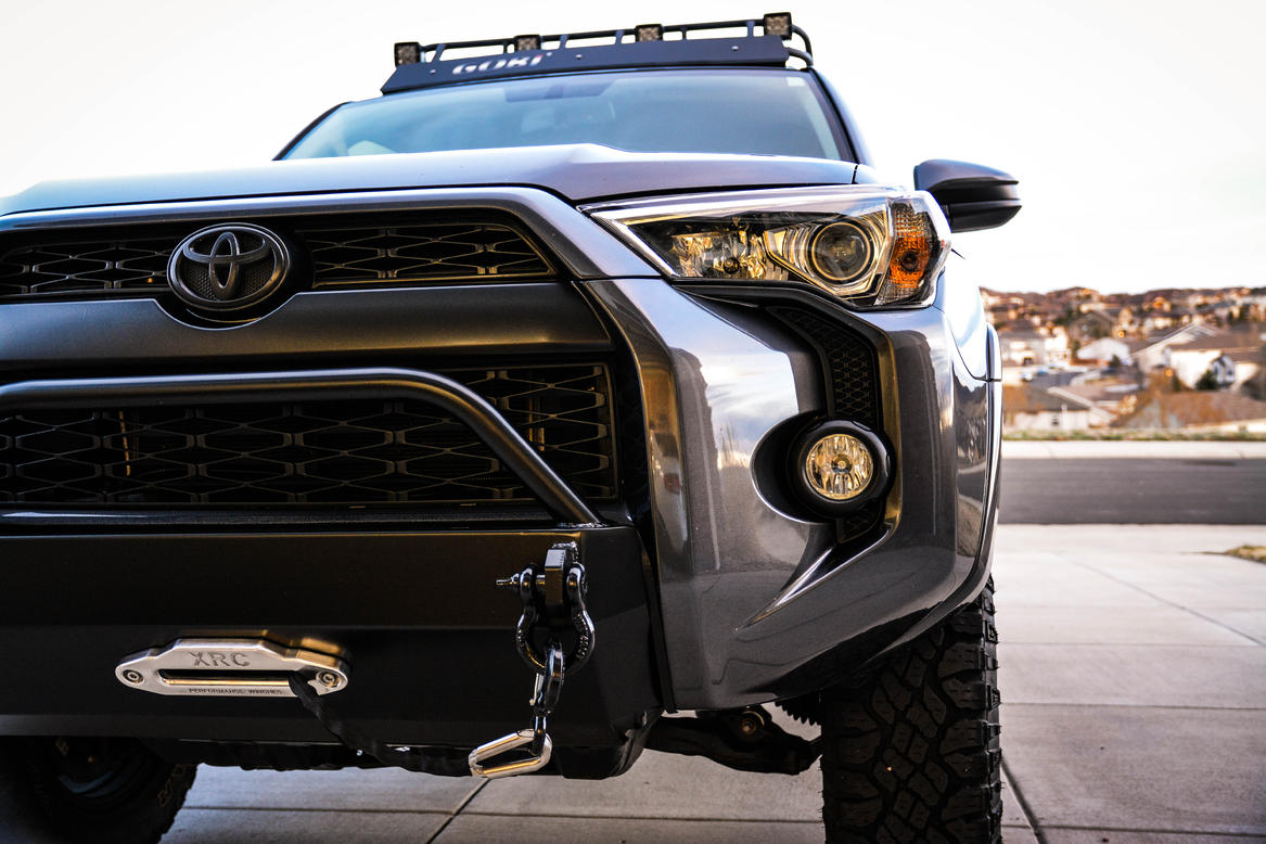

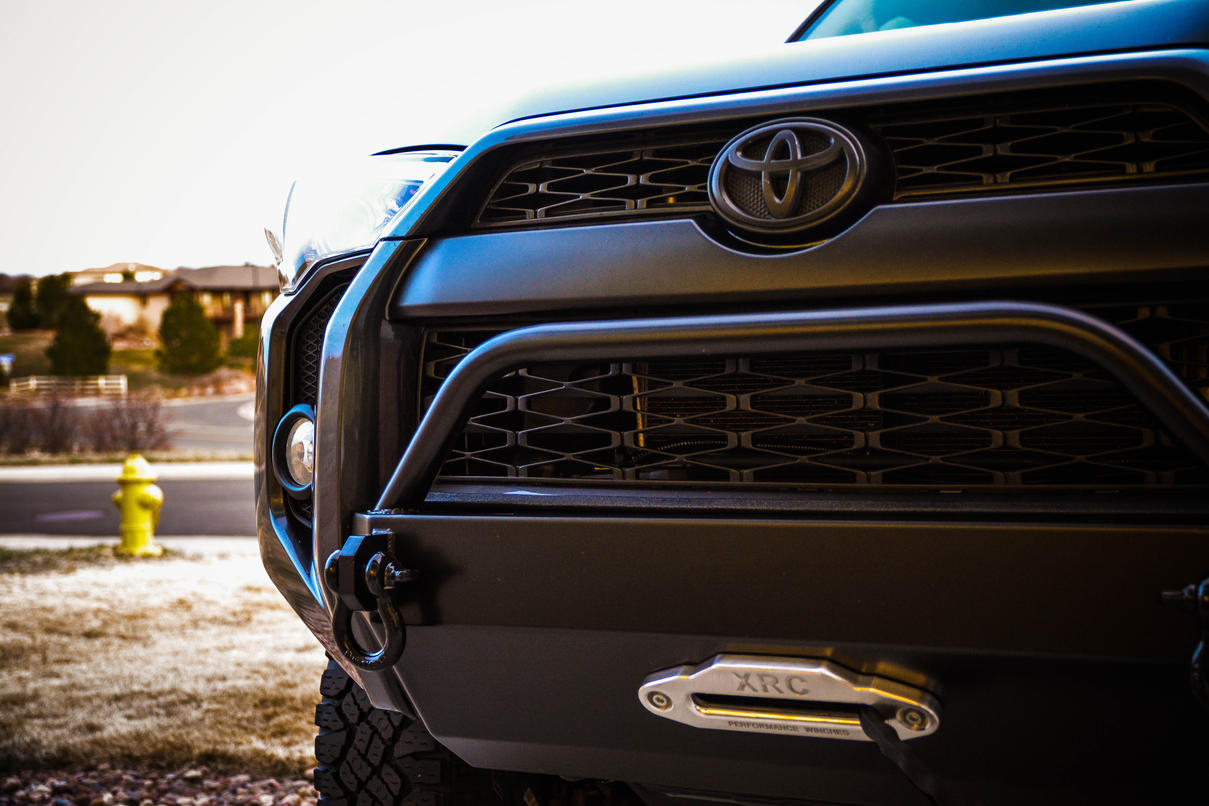

Got my bumper back from powder coating and installed! My winch is the Smittybilt XRC 9.5k. I had to lose the light bar behind the grill though, I may try to remount it when I get some more time but that would require relocating the winch solenoid and cutting a hole in the grill to access the clutch release lever.
Looks great man! I have an SSS that goes on next week. I did get the light bar slot between my shackles though... And i still need to move my soleniod from what I've been told. We'll find out soon on my end. Best luck to you on the bar mount.
Thanks! Hopefully I can make it work, if not I will get a 20" and mount it to the bumper. Good luck!

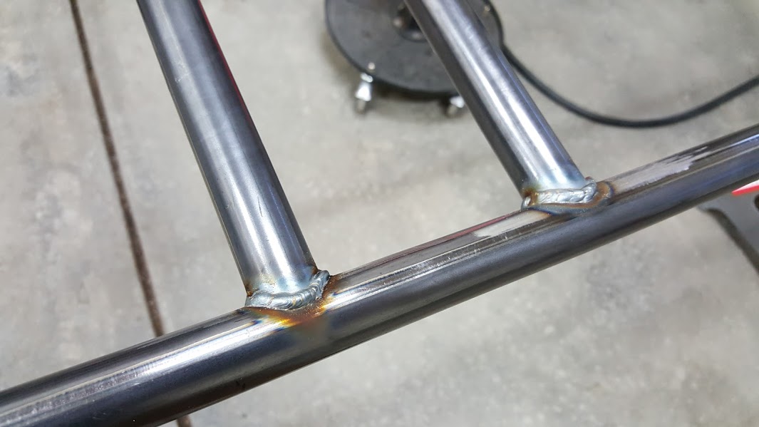

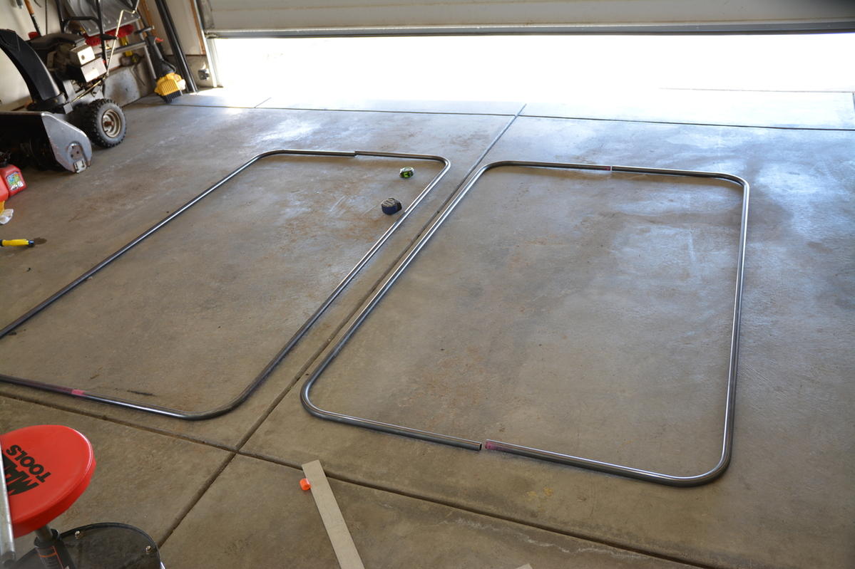

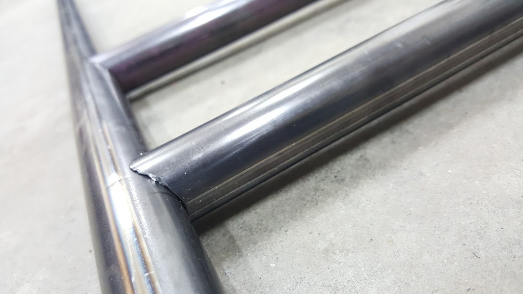

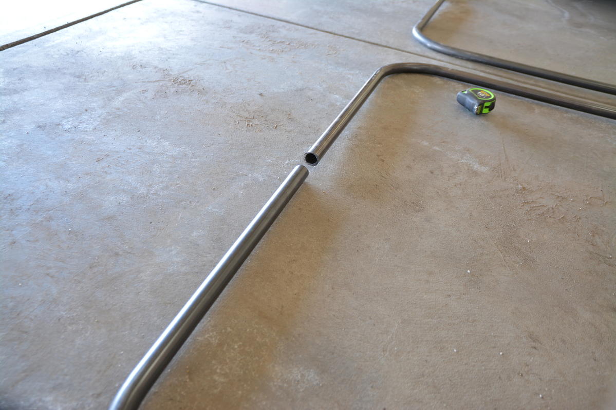

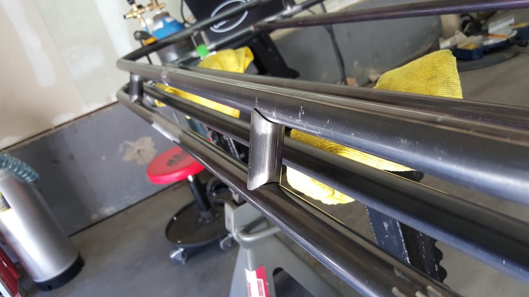

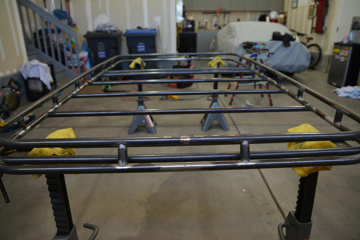

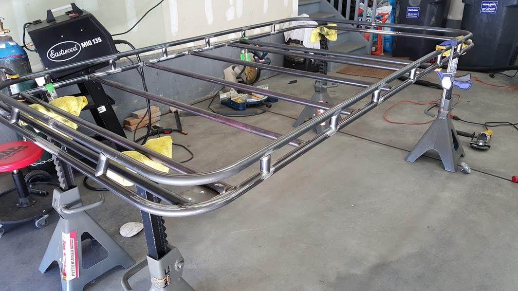

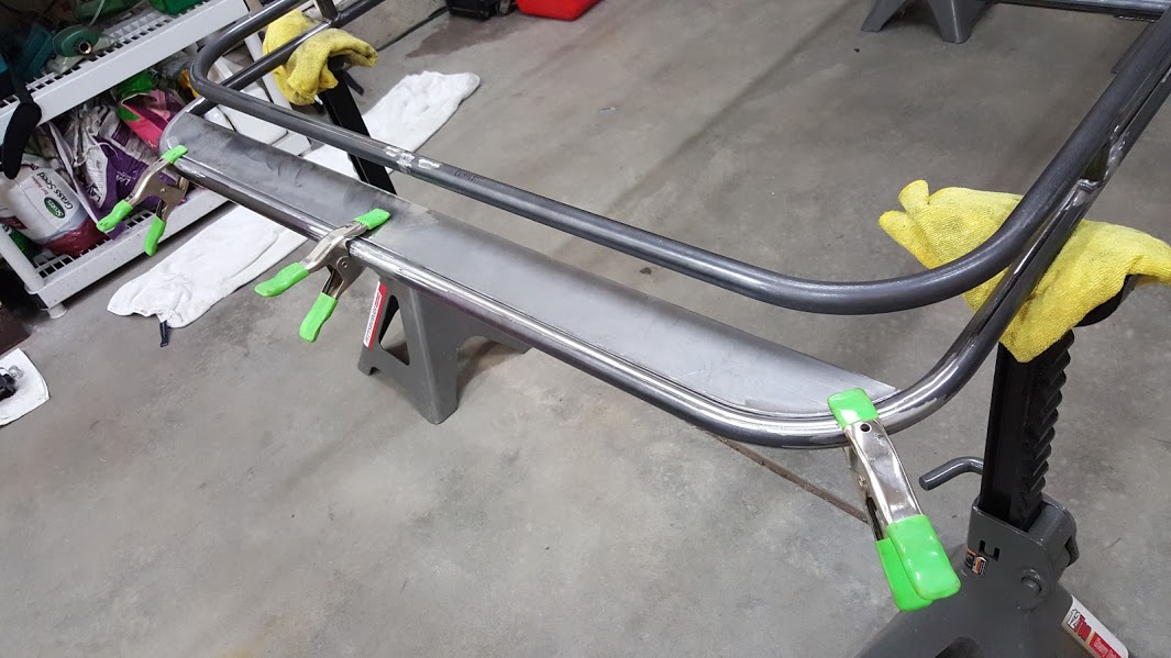

I decided to build my own roof rack...

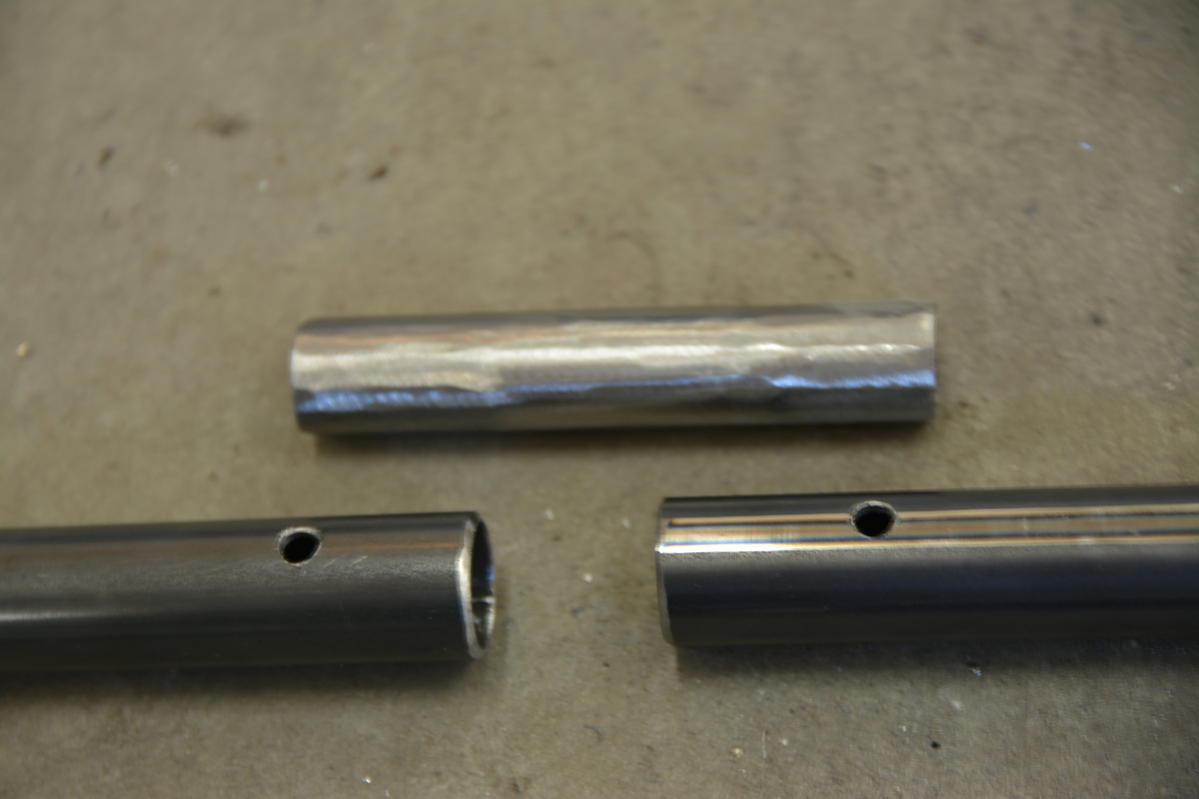

Unsatisfied with the rack that I had made for me by a guy off Craigslist, I decided to attempt to just build my own. I really wanted a Drabbits rack but I didnt want to wait and I think the Gobi is overpriced. So admittedly I used the Drabbit's design to go off of. Not taking anything away from his racks...they look amazing. I just figured if I could build one half as nice, I would be happy.

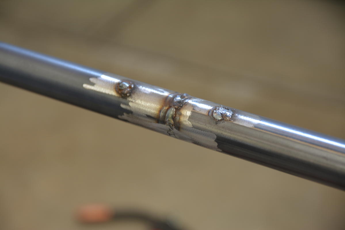

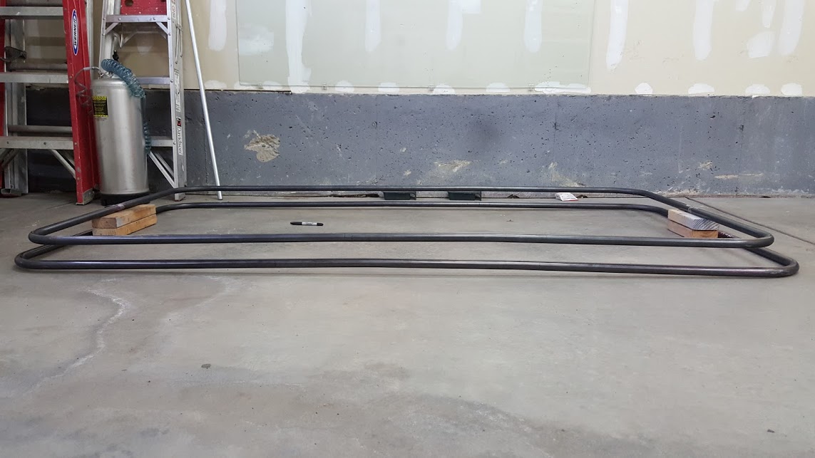

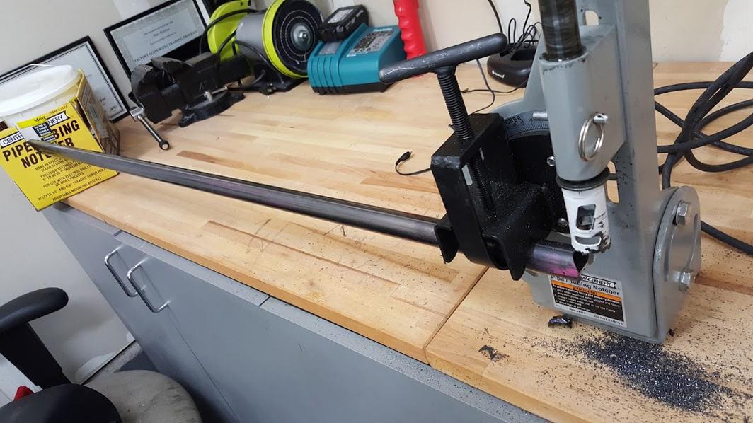

So I dont have a tube bender so I had a local shop make me some 90 degree bends in my 1" steel tubing I purchased.

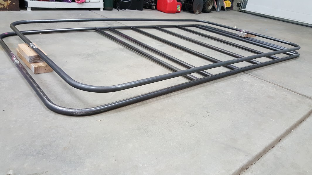

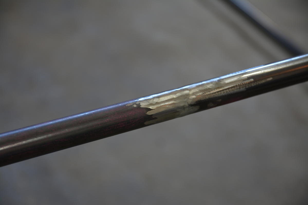

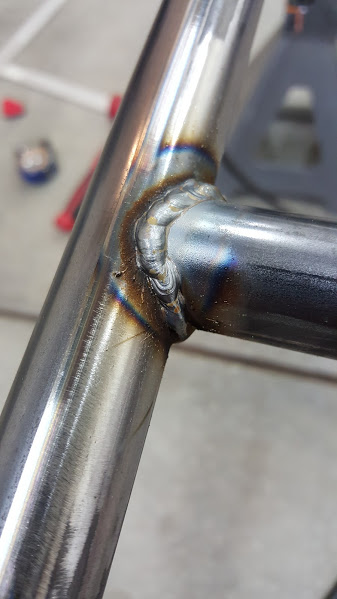

Then I welded them together in the middle using a slug technique.
So now I had a basic layout of the frame. I gave it a little curve in the middle to follow the contour of the roof

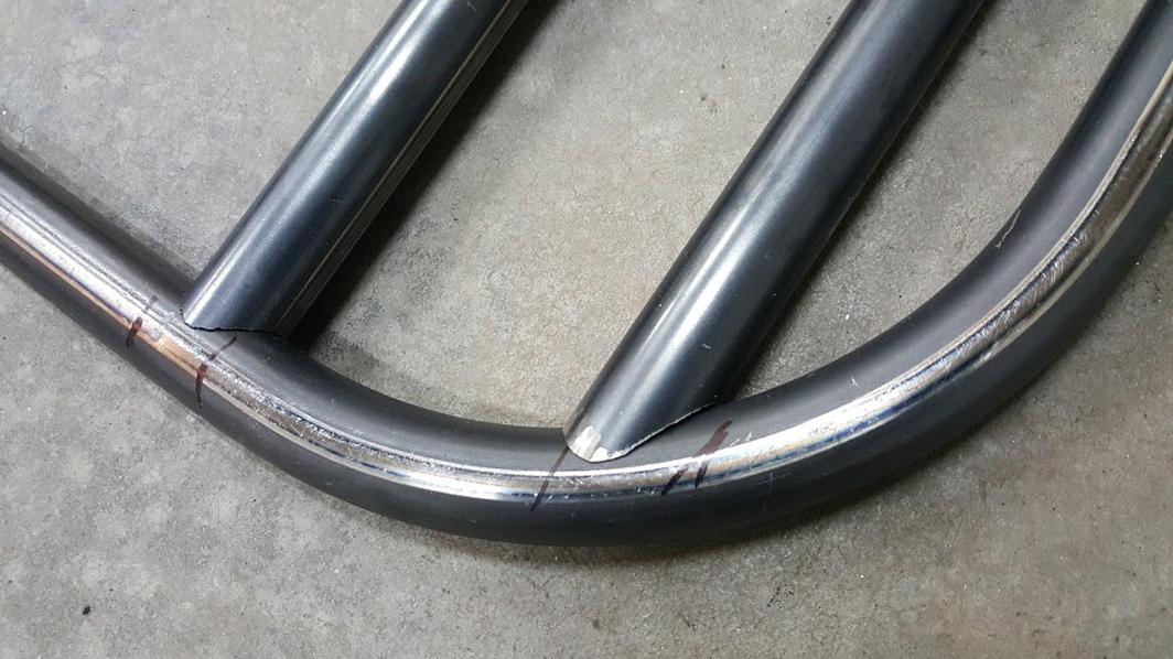

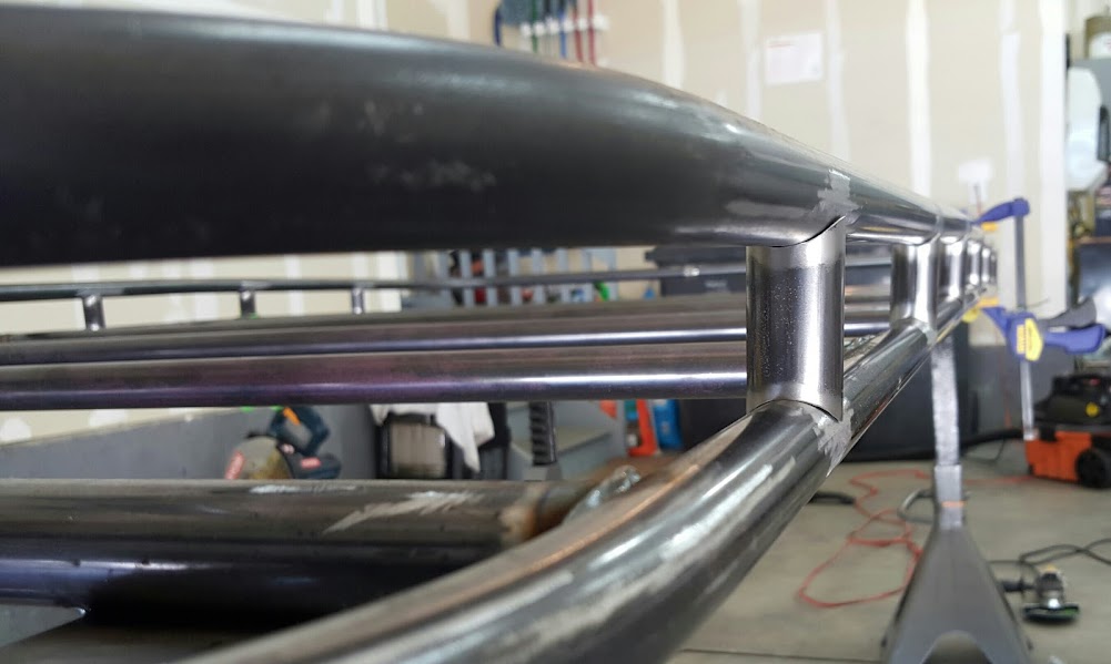

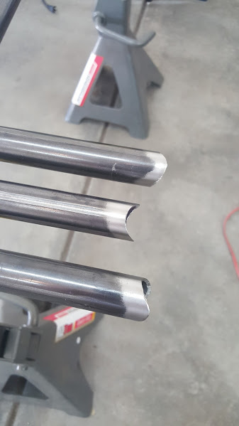

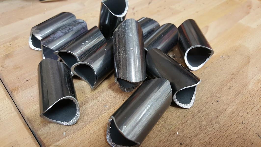

I then purchased a tube notcher from Harbor Freight for $44. It really did the trick!

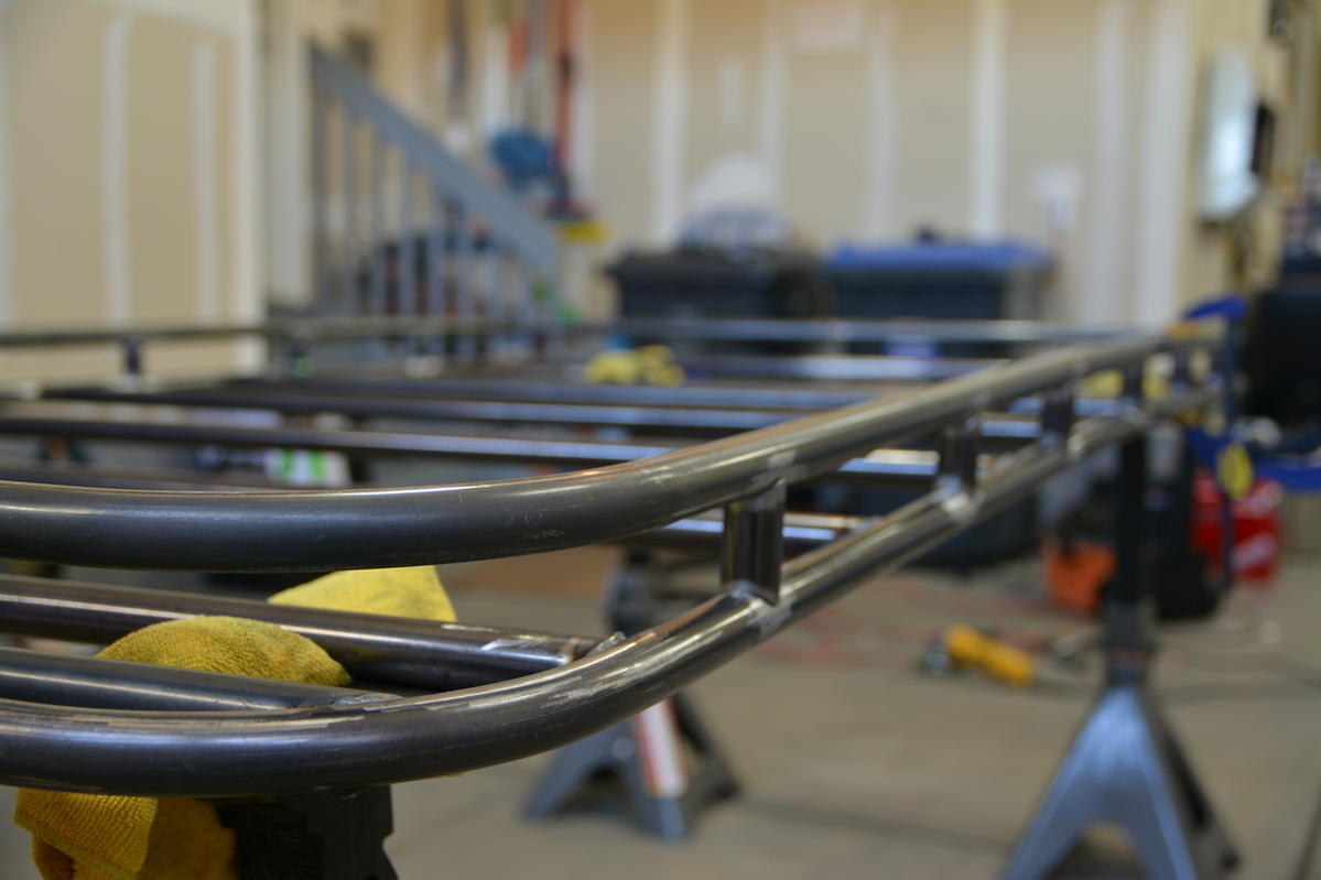

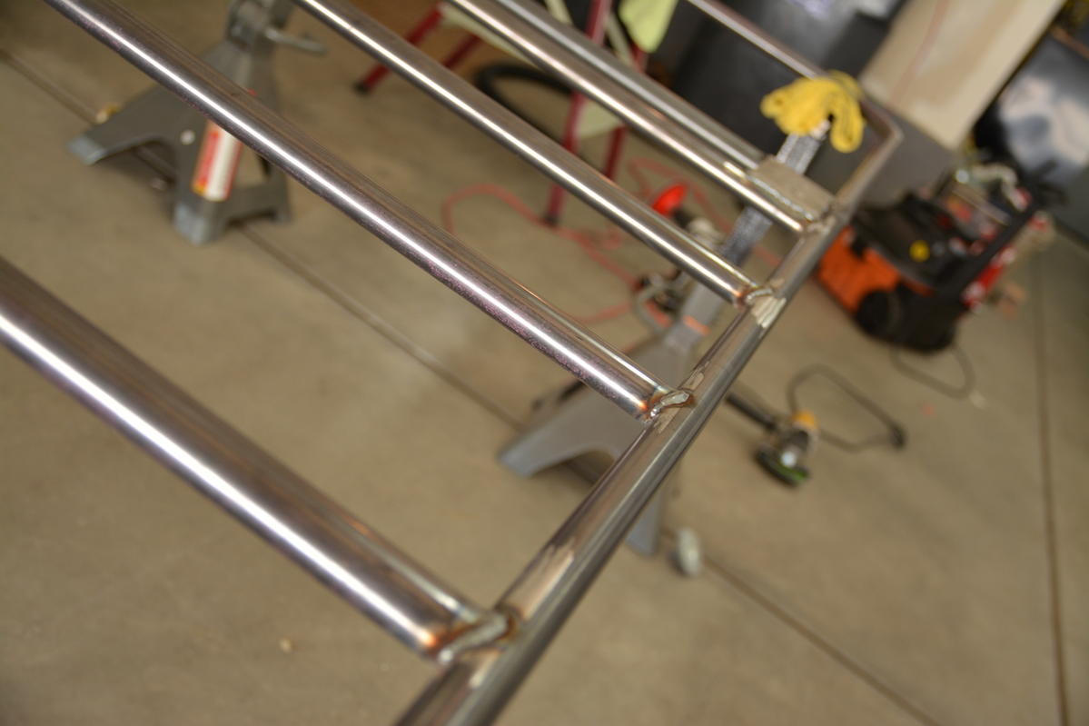

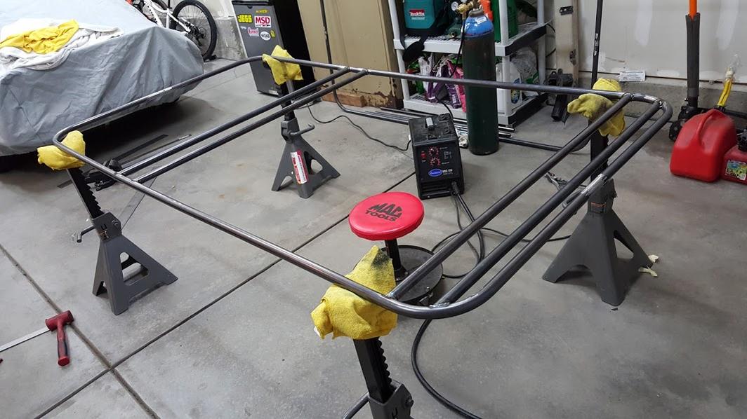

Attached the cross bars and started welding

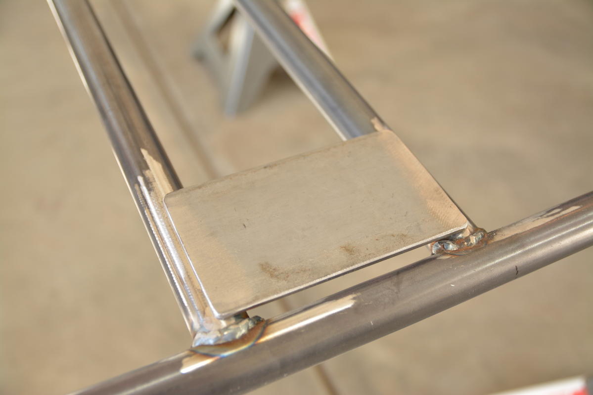

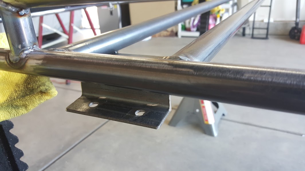

Attached a plate for the brackets

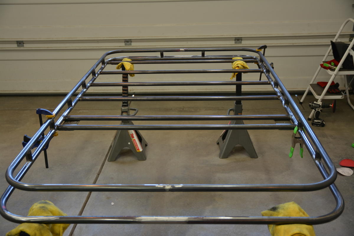

Cut out my risers and attached the top frame.
Starting to look like a rack!

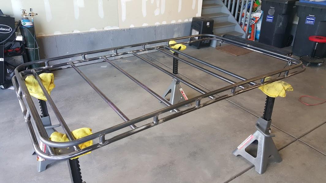

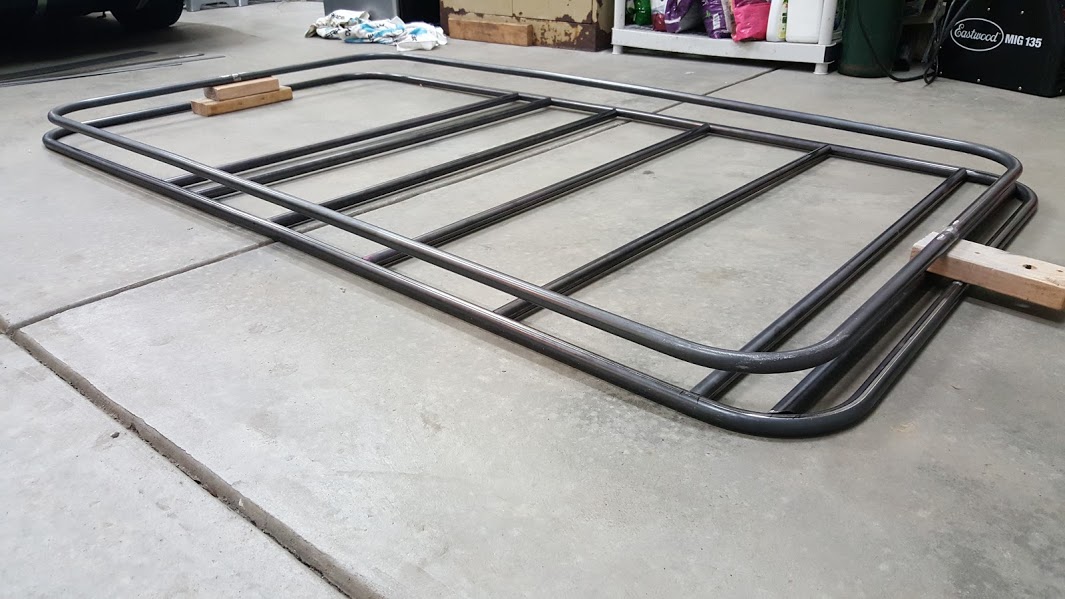

All welded up

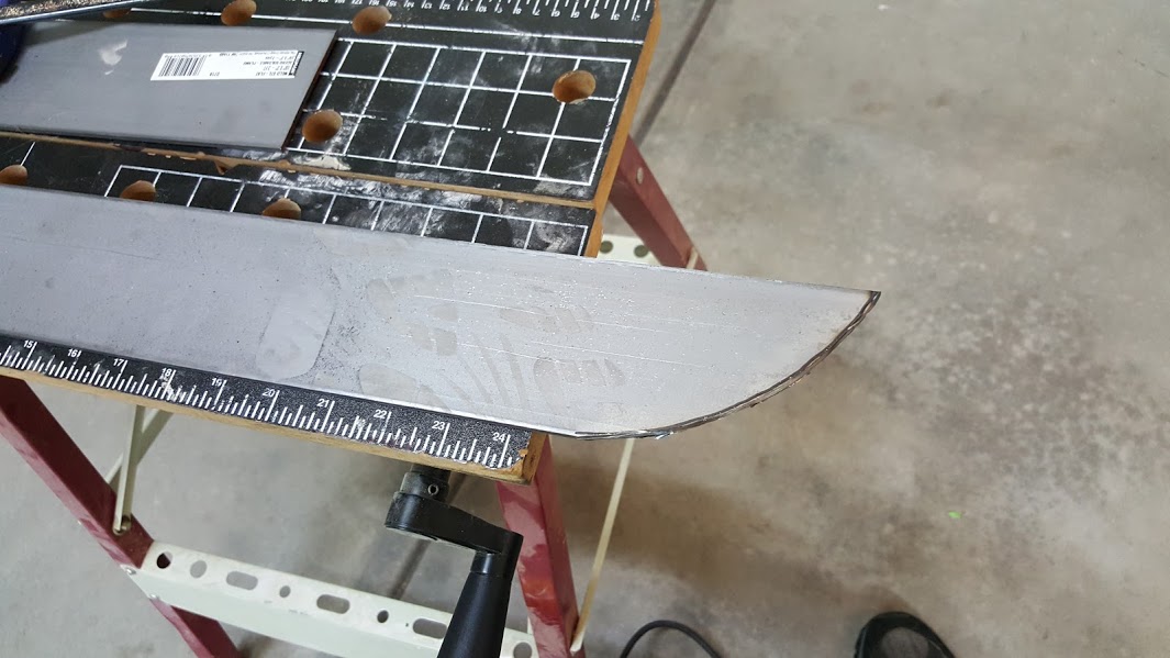

Then I made a plate for the front

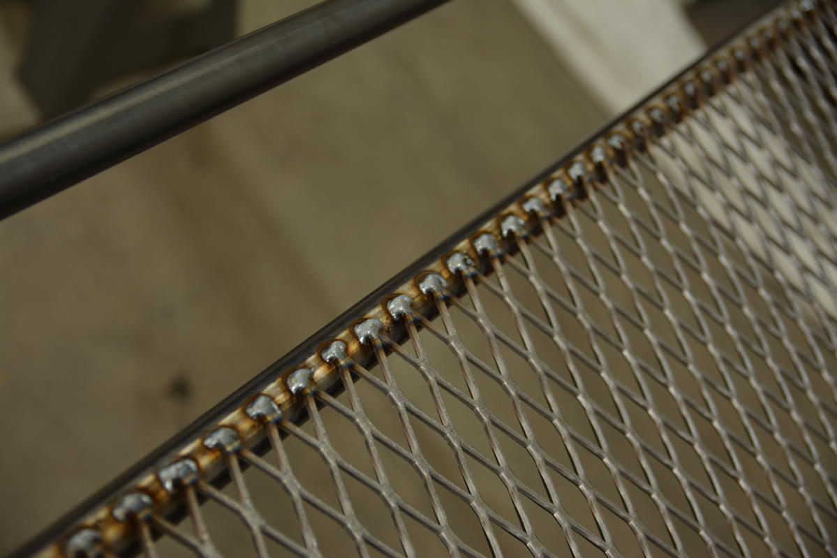

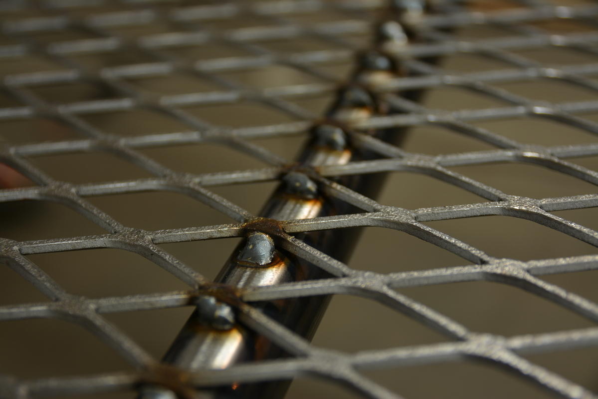

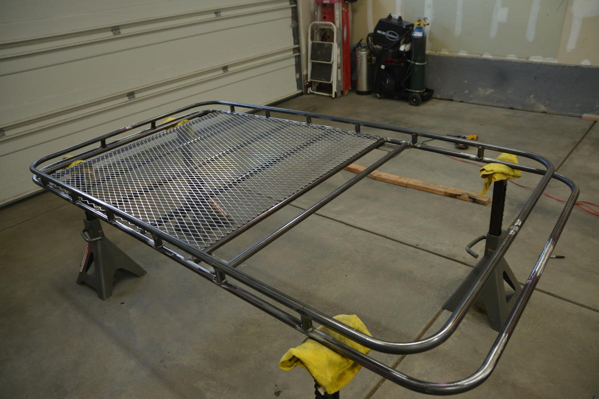

Then put down some 9 gauge expanded metal for the flooring. I ended up welding every spot where it touched the rack so it wouldn't rattle.
