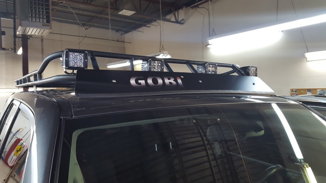

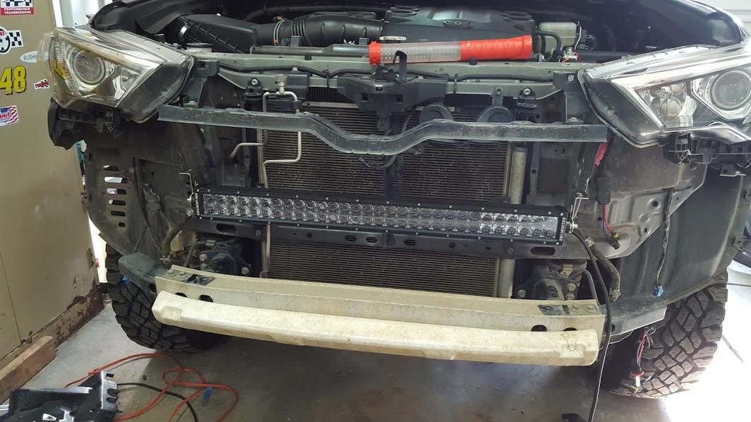

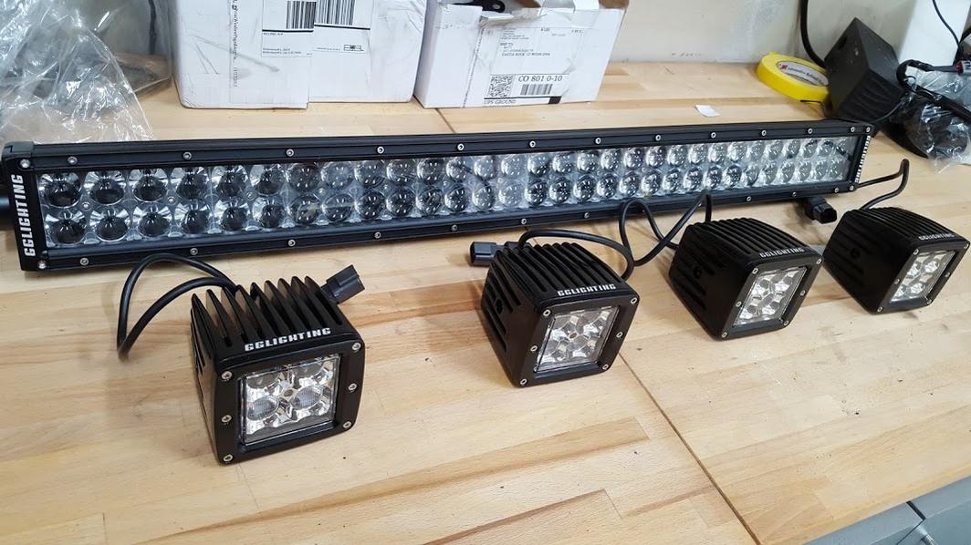

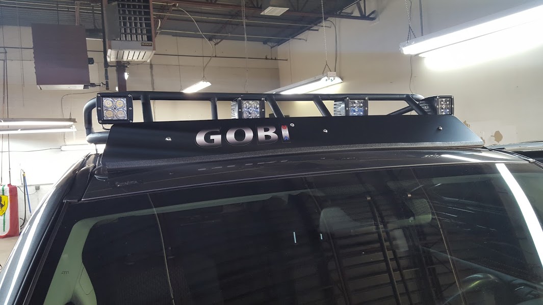

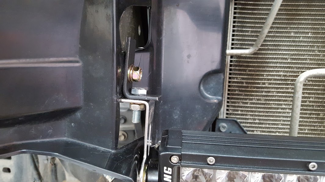

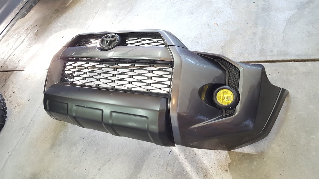

I received my lights from GG Lighting that I ordered on Black Friday. I got (4) Led pods and a 30" light bar. I wanted to mount the bar behind the grill for a more stealth look, and the pods on the roof rack for some nice wide flood light.

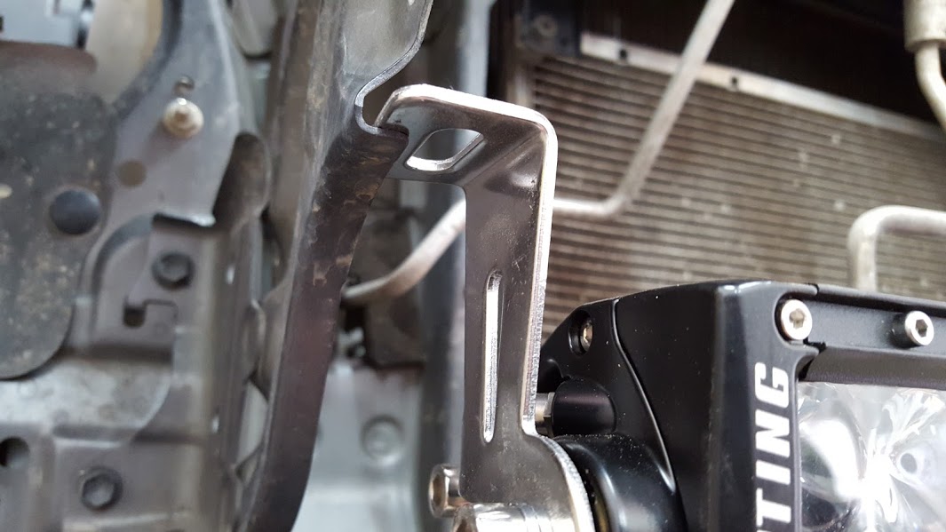

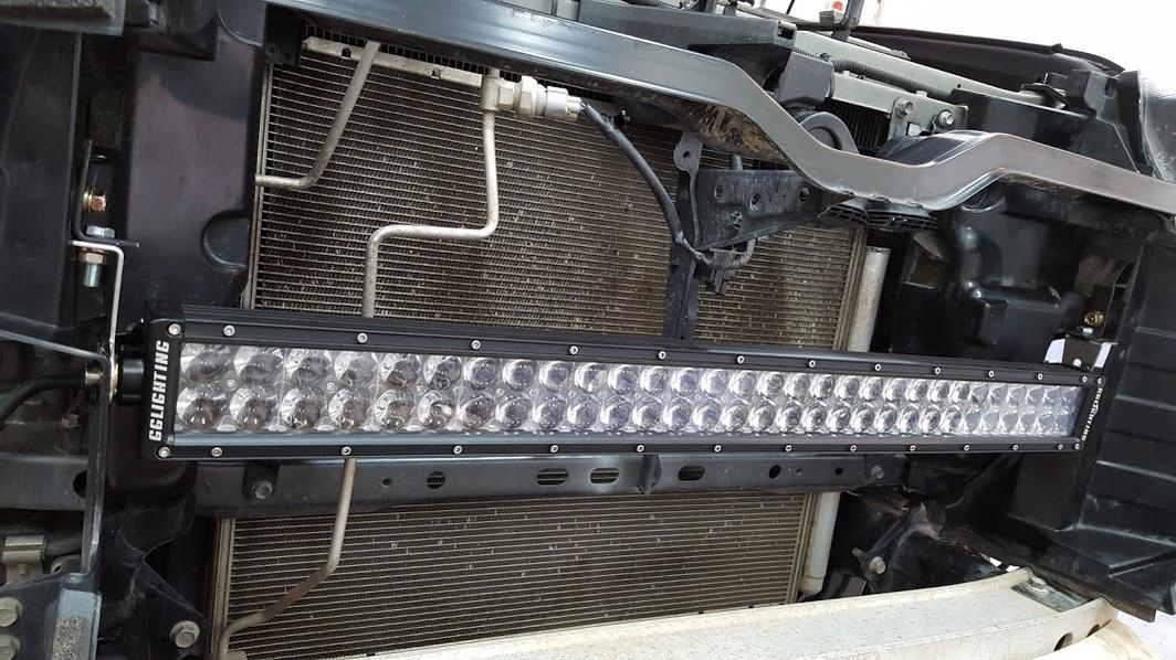

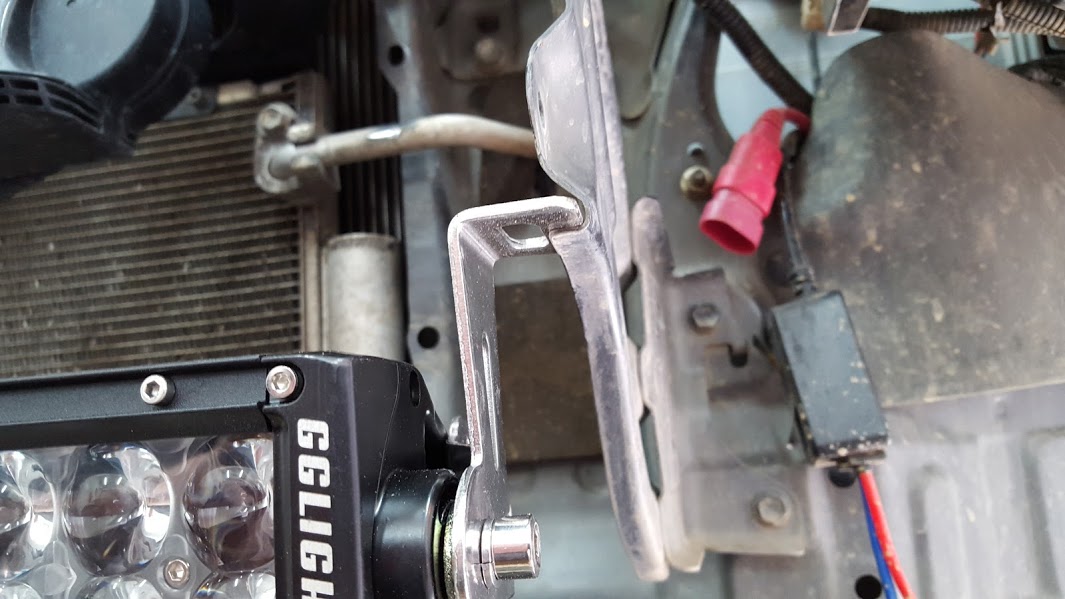

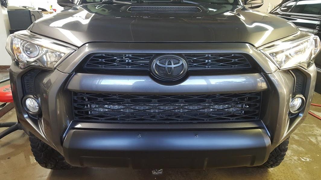

First I removed the front fascia. Pretty straight forward.
After spending hours trying to decide how to fabricate my own brackets to the bumper....I mounted the supplied brackets and found that the bar sits perfectly onto a little tab that holds the factory plastic shroud.
So all I had to do is make a couple L brackets and bolt it in. Perfect positioning and very sturdy. Couldn't be happier.
With the fascia back on.

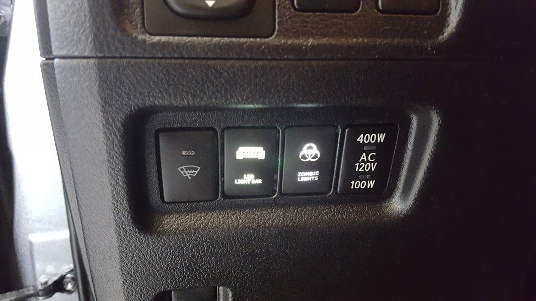

I also got some custom switches from Offroad Arsenal. Nice little touch.
