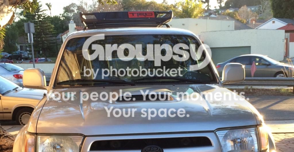

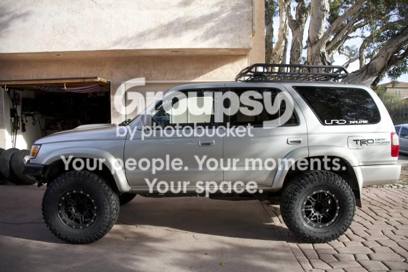

Rola Rack with TRD sticker. hard to see, but there. i suggest having the join areas where it goes together welded for more strength. also then having painted. mine lasted about 2 or 3 months before looking bad.

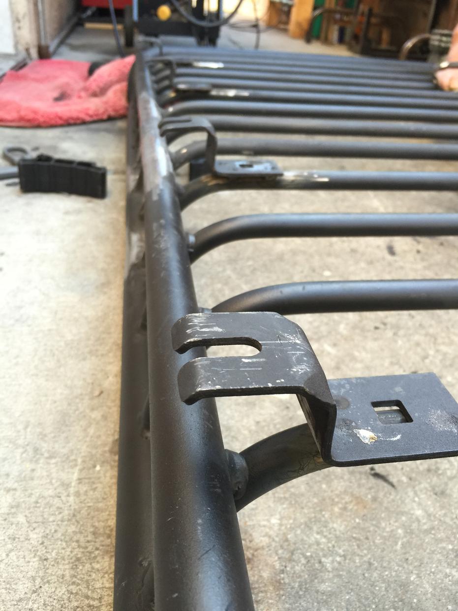

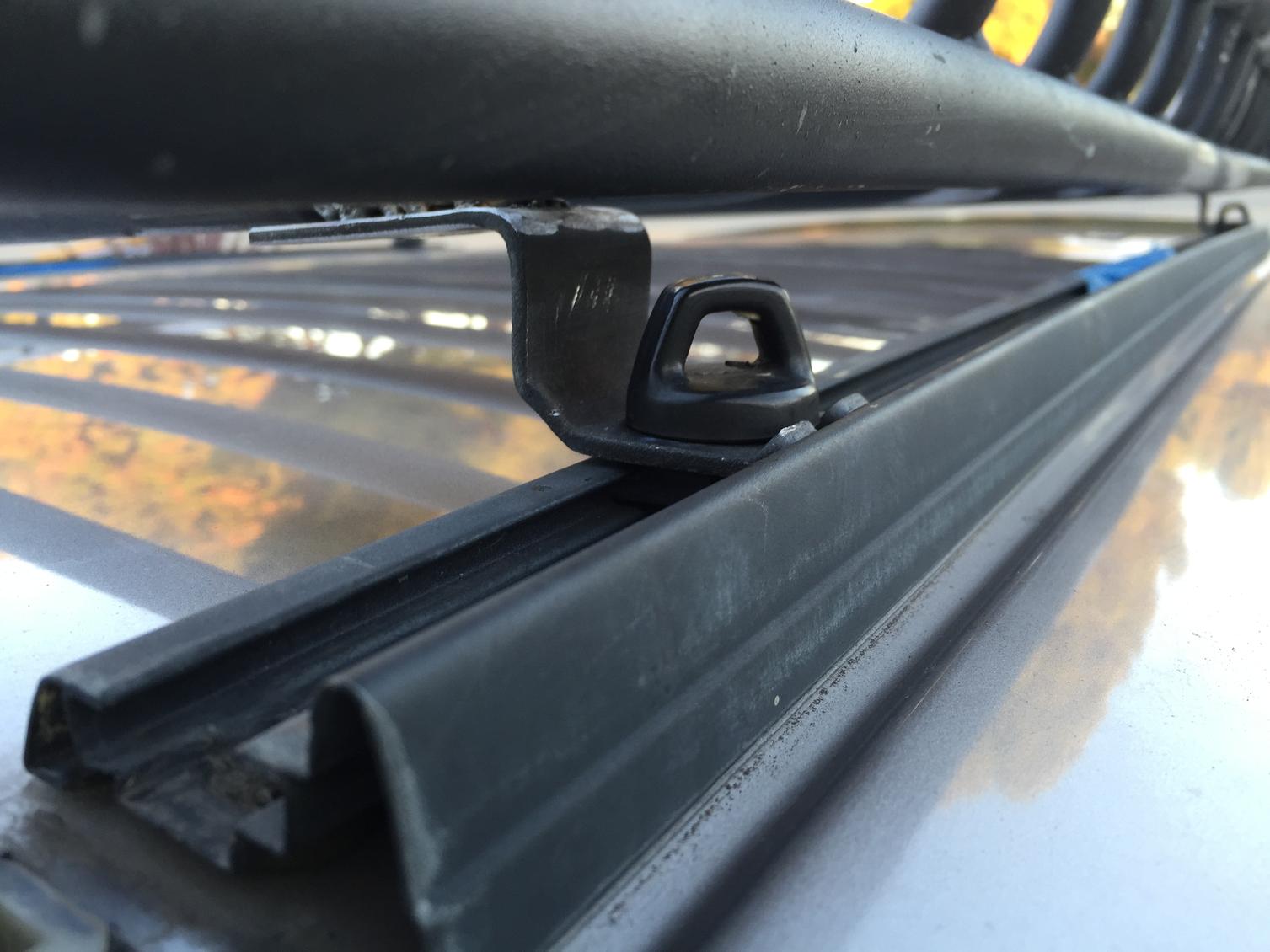

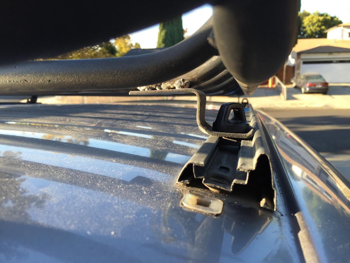

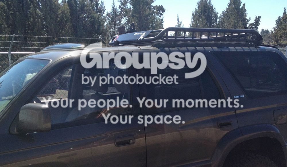

i cut the included mounts in 1/2 and welded them on the rack... used the cross bar screw tie to secure it to the factory rail with the factory insert that keeps the cross beams in the roof track system
i also welded the extension cut in 1/3,,,, gave me 2 extra basket rails
it sits super close to the roof.

[MENTION=102606]infamousRNR[/MENTION] how much weight have you thrown up on your rack and have you had any issues with the mounting feet being to stressed?

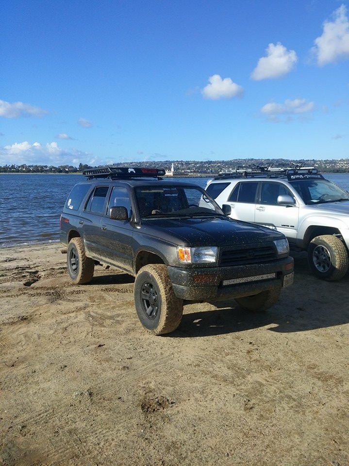

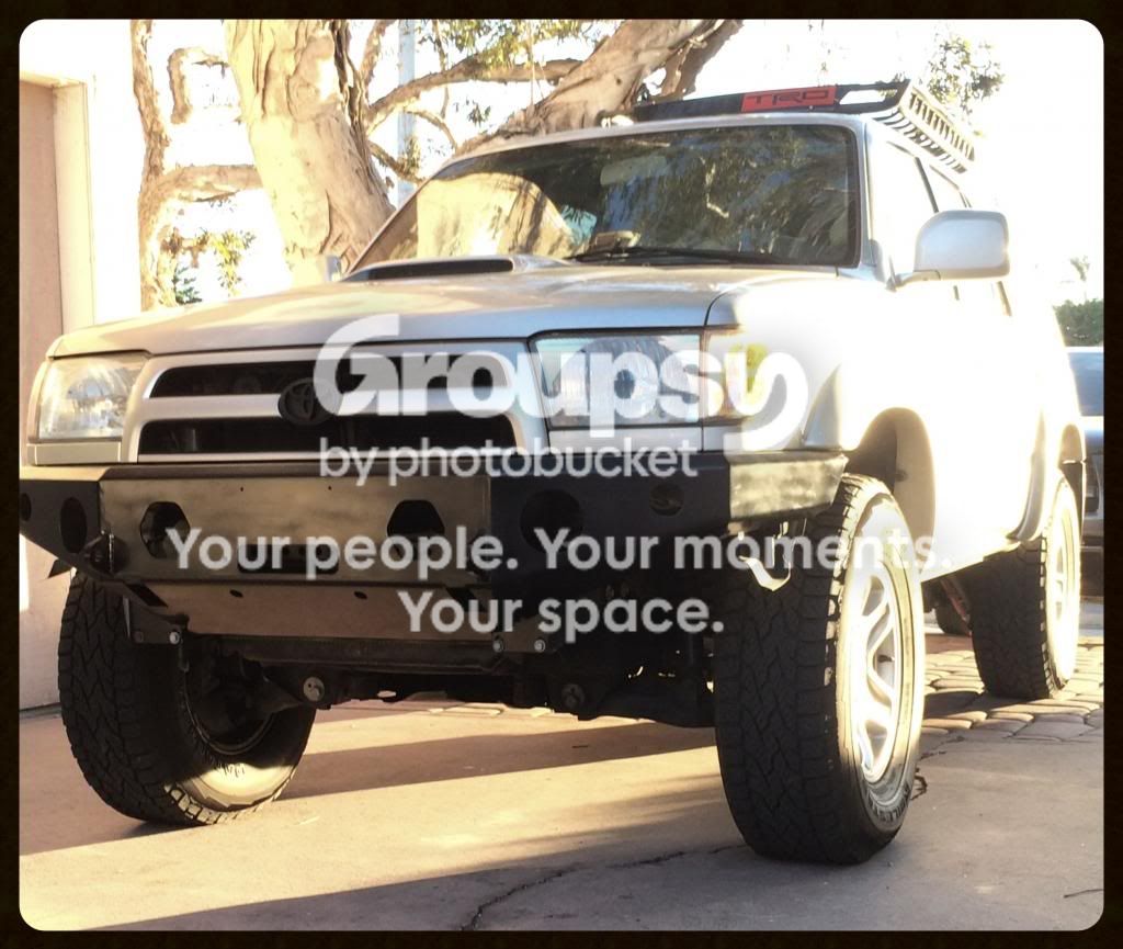

this is 10ac old rack on my. sam TRD sticker with a added total chaos sticker

You know i haven't really had anything up there yet but it has 3 mounting points on each side.... So 2 more than the previous stick setup had.... The roof rack cross rails were rated for 175lbs each I believe so I'm guessing at least 300lbs....
My concern is the roof rails where they are mounted... I pressed down on one side one day and the roof flexed a little... So that's my main concern... But otherwise it's the standard weight governed by the Rola itself and whatever the 4runner's roof can hold...

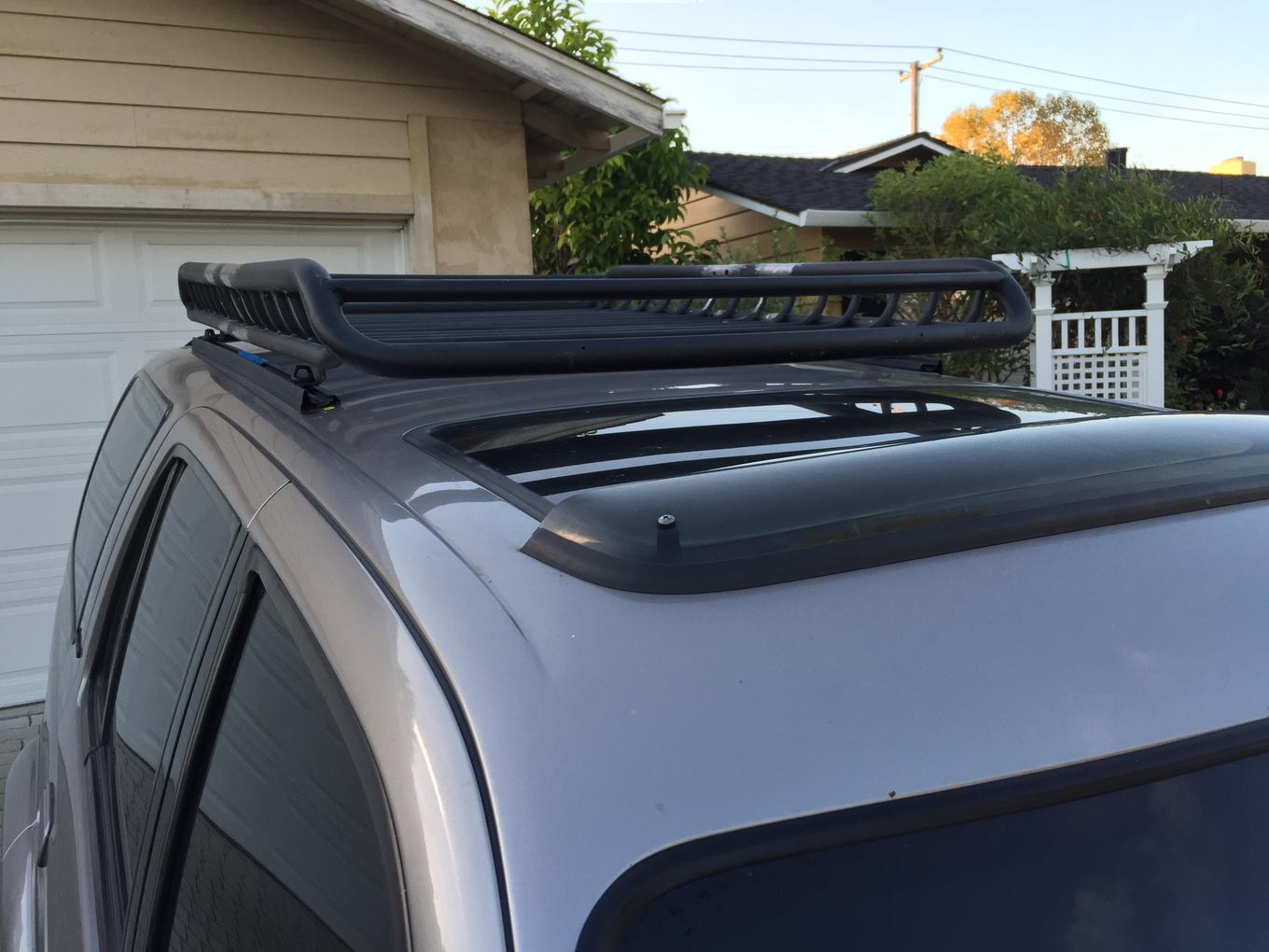

RolaDrop_zps520b8a5a.jpg~original

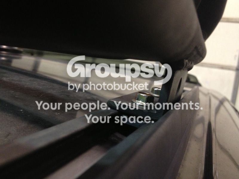

Short rack welded into one piece.
Simplified and dropped the feet using angle iron and factory track bolts
Current height:
IMG_3350_zpsca0fdbfa.jpg~original
Nice, im just working out the mounting on my design and this helps to give me a better idea. Hopefully by next weekend or so i will have it all complete and ready to purchase the parts.

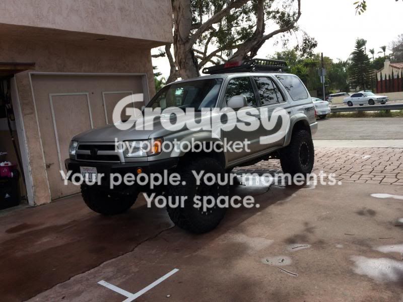

[MENTION=93300]GhostRing[/MENTION] I'm bumping this old thread because I really like your simple mount and I'm planning on doing something like this. Just curious what size/thickness angle iron you used. By my measurement it looks like 1.25" angle iron gives enough clearance over the curve of the roof and I'm thinking 3/16" thick should be plenty strong. Any thoughts? How's yours holding up and how much weight have you put up there? Thanks
