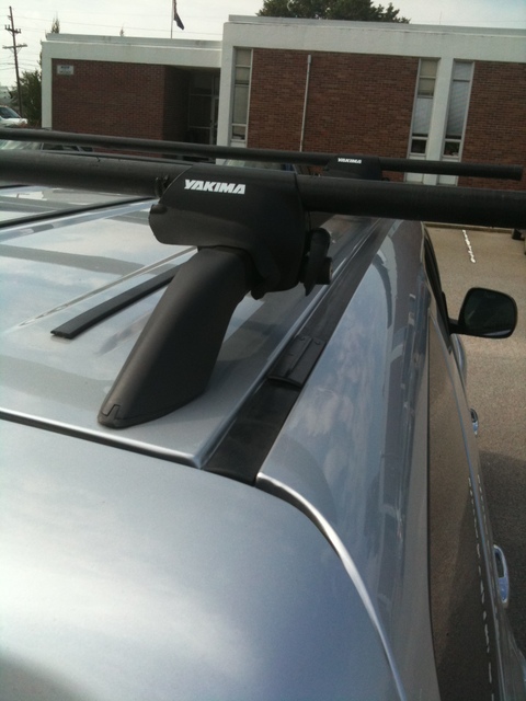

This is not a factory rack
Thanks for the response and I would be fine IF I had the factory rack.
What I have is some rack that was installed (essentially for aestetics) aftermarket that is not sturdy and installed directly in the roof sheet metal. I should not have used the word bolted as it is installed only with sheet metal screws. As I am sure you are familar, there are locations in the gutter area along the sides of the roof that is reinforced where the factory racks are installed. Mine is placed about 3 inches inside that on the actual roof. If that makes sense?
When I load boats (or anything) the roof flexes tremendously.
Oh boy.... now I see what you're saying. It's actually screwed into the sheetmetal? I'd absolutely raise hell with the dealer, as it's a bad idea to puncture the roof sheet metal with screws. Do you have any leaks when it rains?
I suspect even the dealer didn't realize that they were selling a 4Runner with an aftermarket roof rack that was screwed into the roof. Like you, they probably never stepped up to examine it closely. If this is a Certified used vehicle, then I think you have a real good case against the dealer. If the dealer doesn't cooperate, just call Toyota's regional office and file a complaint. That's total BS and I'd be really upset if I were in your shoes. Good luck.
After a little more thought, I think this is what I'd do:
If I liked the vehicle and am happy with it overall, I'd go back to the dealer and tell them that I want them to remove the aftermarket rack, have their body shop fill all the holes (with metal, not body filler), repaint the entire roof, and then install an OEM Toyota rack. That's really not a big cost to the dealer and they should take care of you. If they don't, then start complaining to Toyota and explain your case.
If you can't get them to help you and you still want to keep the vehicle, then just unbolt that POS aftermarket rack and have your local body shop fill the holes & repaint the roof. Then you can buy an OEM roof rack cheap from someone on this forum. I see them for sale in the classified section pretty often. At least that's better than paying full price from a dealer.
