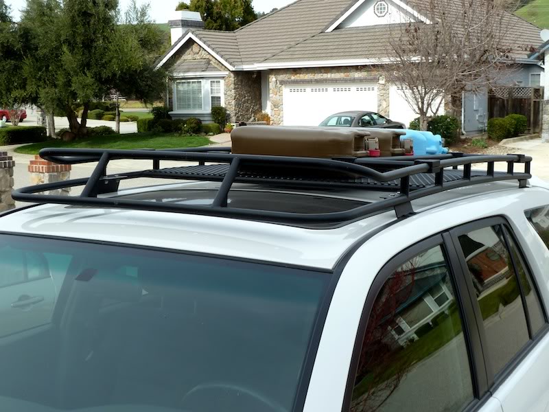

Here are picturs of both companies 4th gen racks(stealth for gobi)
Whitson:
Gobi:
They are very different once you look at the actual details. The gobi rack has 6 mounting points compared to WMW's 4. The WMW has its tabs welded to the rack not separate bolt on pieces like gobi.
Both use expanded metal for their floor structure. But Gobi has theirs in 2 pieces with a break where there is a cross member attached to the higher members. WMW has all of his cross members across the bottom under the expanded metal grate.
Also you will see that the back of the gobi rack isn't square. The upper cross member doesn't extend as far back as the lower one does.(This is sort of their trademark for their stealth roof racks) the WMW is square and extends just as far back.
I can't speak to the wall thickness of the tubing that each use since I would have to cut one in half to do so.(anyone want to let me cut one in half?)
Also on the subject of the cross members gobi does a square cut on the ends and then pinches them and welds them to the round tube. Where as It looks like WMW fish mouths them and welds the entire area. WMW's method is much stronger, but the gobi method is designed for commercial production.
Also I can't exactly see where the seams are for the WMW rack. I'm guessing it is made in 2 pieces and then has a plug matching the ID of the tube inserted and then welded and ground so it looks like a continuous tube. You can see the gobi rack bends the outter profile in 2 halves and then slips a coupler over the tubes OD and welds it, to make it one piece. Not quite as nice of a finished product but from a production standpoint its much cheaper to manufacture.
Also the front braces on the gobi rack don't really allow for a large LED bar to be mounded across the front.
Great observations. There are definitely many design decisions made by Whitson that are not present on the Gobi rack. Whether these differences are enough to completely dispute the alleged infringements, well, time will tell.
