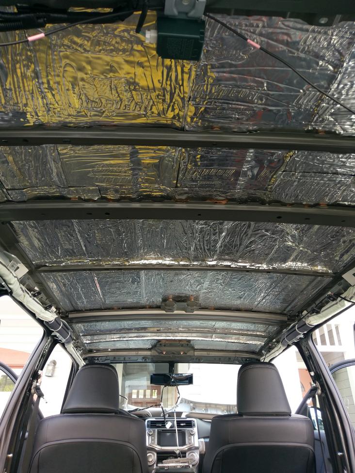

Dropped my headliner and removed it completely from the car to deaden the roof without any problems. There are a lot of things that hold up the head liner if you need to remove the whole thing, but honestly I don't think you would need to drop the whole head liner. Maybe just need to do the side where it dropped. You should be able to flex the head liner down enough for you to reach in and find it. I did it with the two front seats still in the car, but I'm sure I could've also done it with the 2nd row there, too. Hardest part was removing the "oh shit" handles
Thanks so much, bro. As tempting as it sounds, I've talked to a few friends and I've realized 1.) It'll take way too long, and I'll probably get impatient and mess something up 2.) I don't know about other models, but I have SRS airbags all around and don't wanna break my neck by some crazy chance by even breathing on any of those the wrong way lol.
I'll just BITE THE BULLET, eat the $200 and get it done at the dealership where they do this more than I ever will and have special tools for even the "oh shit" bars.
