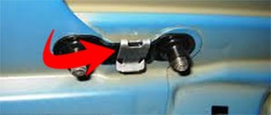

i believe your looking for this bracket. unfortunately, this retainer bracket falls onto the headliner if the bolts holding aren't taken off at the same time. good thing is you can reach in the headliner and re-install the retainer bracket.

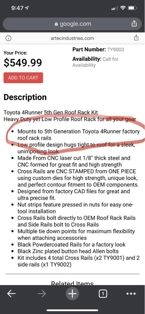

Probably doesn't matter too much now, or I'm just confused but I thought that rack attached to the stock rails?
Why do you need to unbolt the factory rack?

It was too tight of a fit with the side rails mounted. I loosened them first to allow some wiggle room to slide in the cross rails but it just wasn't enough and I was by myself. They have a decent install video on their website but it just didn't go that way for me!
