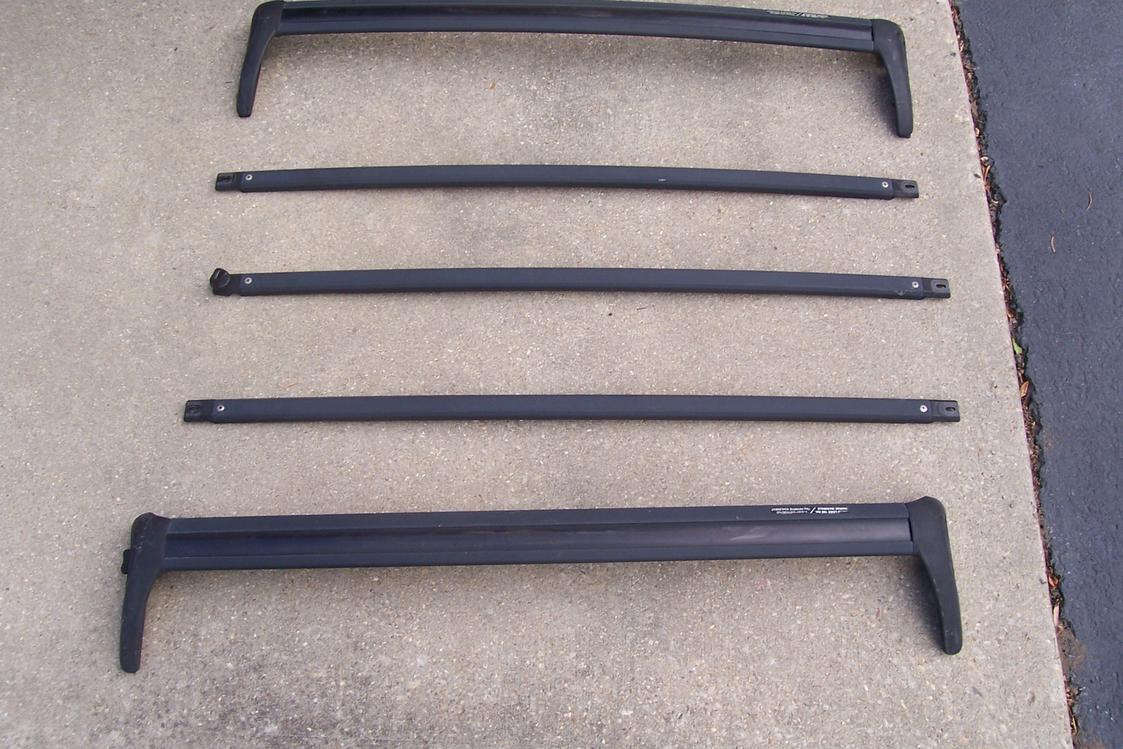

I could build you some simple cross bars to attach to your stock holes? that way you dont need tracks but end up with the same effect. Ive never shipped anything to Canada but they would be ups-able sized...
Rack
$40 + shipping? you will need some of the hardware tho

So looking for a bit of karma. I have what you are looking for (ie the bare tracks not the stuff shown in the picture above, you would still need that or something) I took them off 2 rolled vehicles to make one set for a guy I know. He changed his mind and so they are on my carport floor. I am in VA though and not sure what the postage would be, if you want them you can have them free, (hopefully I get a tick in the good karma bucket!!).
Let me know

That would be a good option. Then you can get a set of Thule or Yakima feet and bars.
The other option would be that both companies offer systems where they mount around the doors.
Either way I wouldn't use the factory crossbars to mount a kayak. I wouldn't feel comfortable doing so.
I've hauled single canoes and kayaks on my OEM cross bars no problem. Just make sure you tie down the bow and stern to the front and rear bumpers! The tracks are far too short, so the cross bars are too close together to support a longer boat without securing the ends.
If you want to carry more than one boat, you've got to get some longer crossbars. I've got yakima 72" crossbars that are just barley long enough for two canoes, and I'm looking at replacing the OEM tracks with Yakima tracks that might be a little longer.
