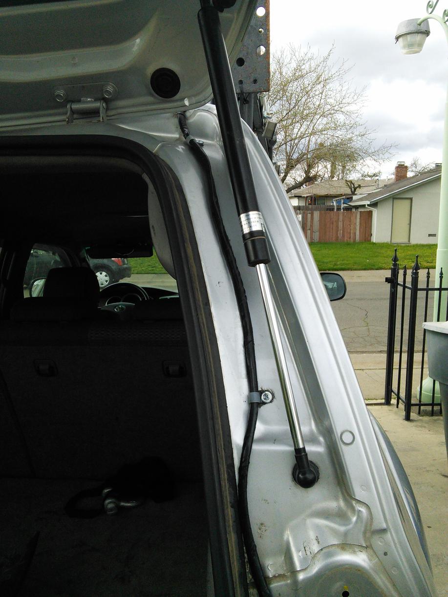

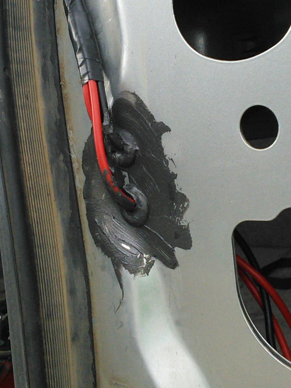

I wouldn't mess with seals. I ran it down the roof, down the side of the rear hatch, and I just ran it up over the seals and under the carpet to the front.
I always run my wires through the flex conduit for the rear hatch that has the wiring for the third tail light and the tailgate window.
Just an option for you, I removed the rear lights and came through there.
