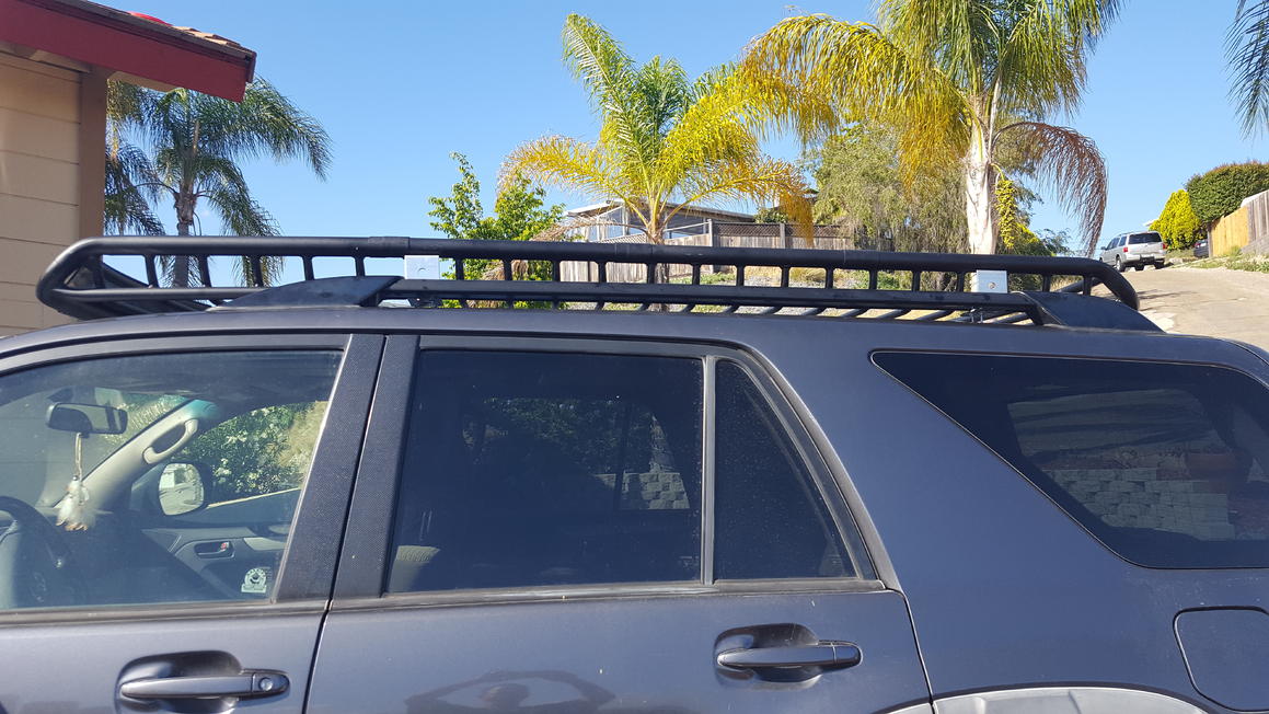

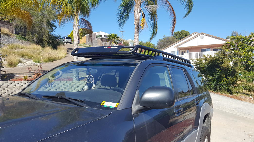

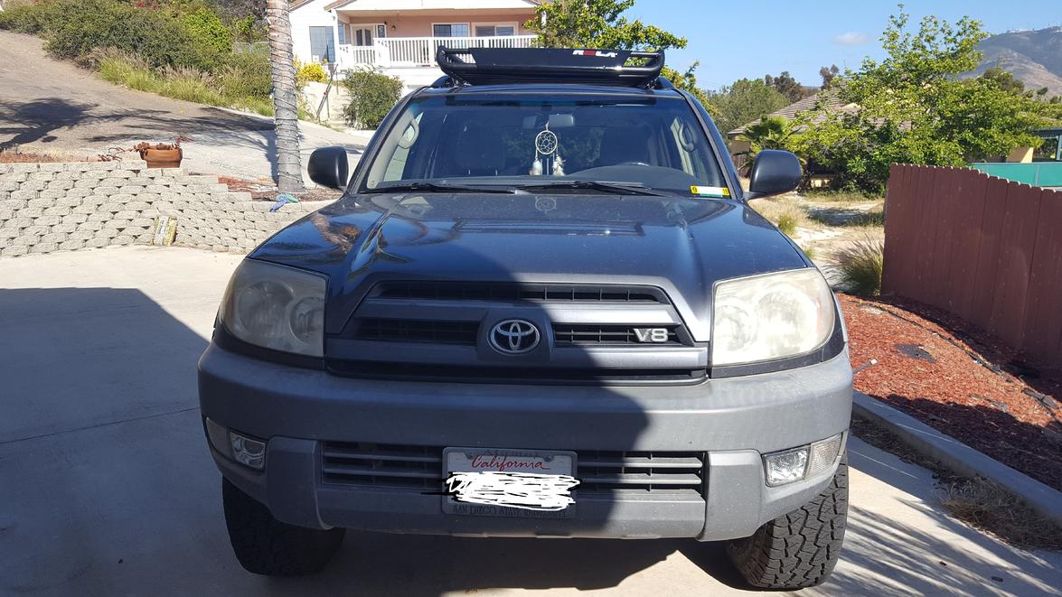

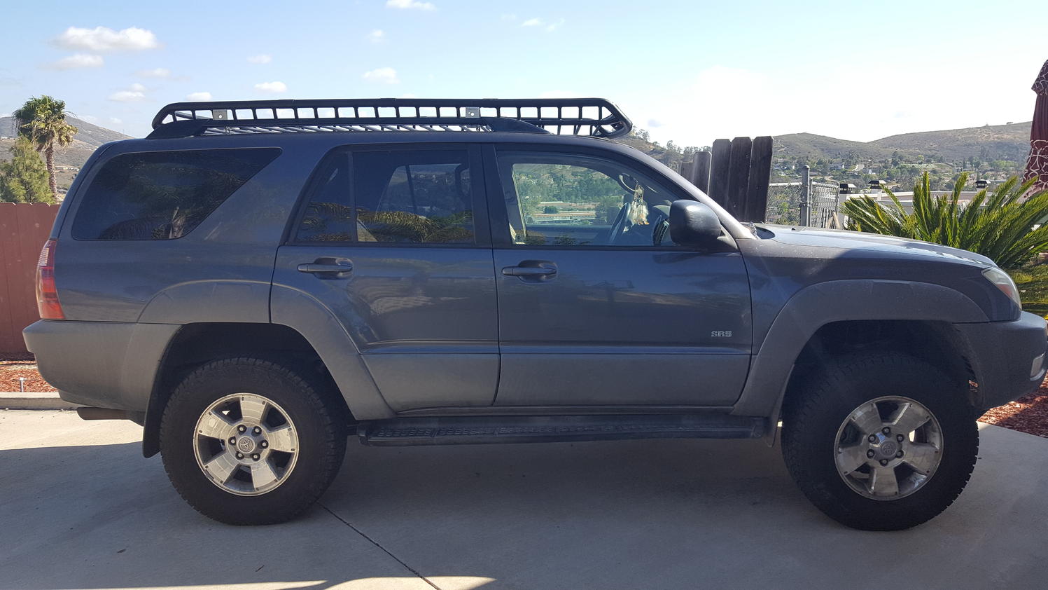

I've tried searching google and the forum but I couldn't come across what I'm tried to look for. I'm trying to see how people mounted their roof rack basket by using the stock rails and removing the cross arms for a low profile look. Pics and how to do it would be great!

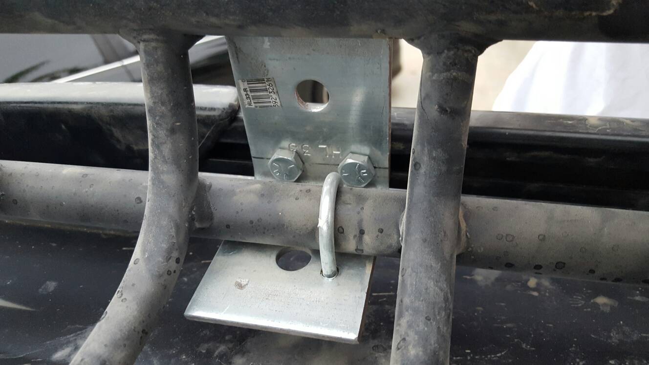

I made some brackets based off 4xinnovation bought at home depot using simpson strong tie, ubolts and 4xinnovation rail Toyota Bed Rail Accessory Hardware Kit. Took some measuring and drilling holes but I think it turned out great. Next is mocking a farm jack bracket, led bar lights and outdoor shower made of PVC pipe.
Damn that's long. ...that's what she said. .lol.. can you take a close up of the brackets
live action!!
never seen someone use 2 extensions
Me neither but I like the full rack and glad it worked out. I do have to fabricate 2 more brackets for the front. It's going to rest on the gutter similar to gobi or baja rack to hold the weight. Its solid but want to make sure. Also in the process of putting 32" led bar on the front bottom to fill the gap.

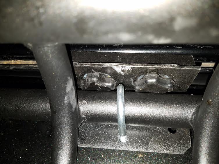

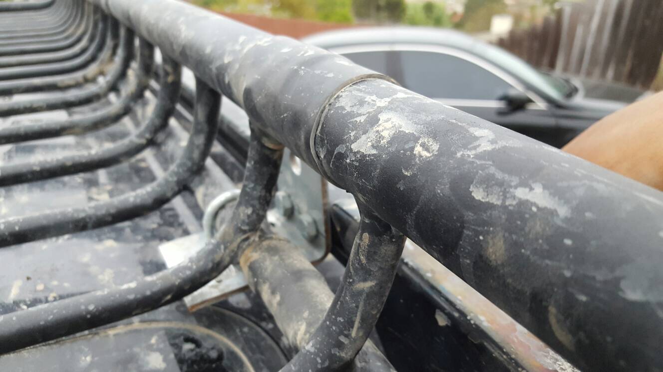

Here you go.uploadfromtaptalk1464748986443.jpguploadfromtaptalk1464748996442.jpg

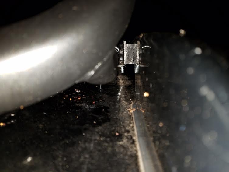

DIY lowering bracket
I did the same thing. Had the angle irons sitting around and just trimmed the top down a bit. Used some 1/2 PVC spacers and original rack bolts. Only thing I didn't have were the stainless U-bolts. Entire thing cost me like $12.
Seems like when I was moving my rack I could not get these spin head bolts off my factory rails, is the a trick or do you have to slide them out the end to take them off
